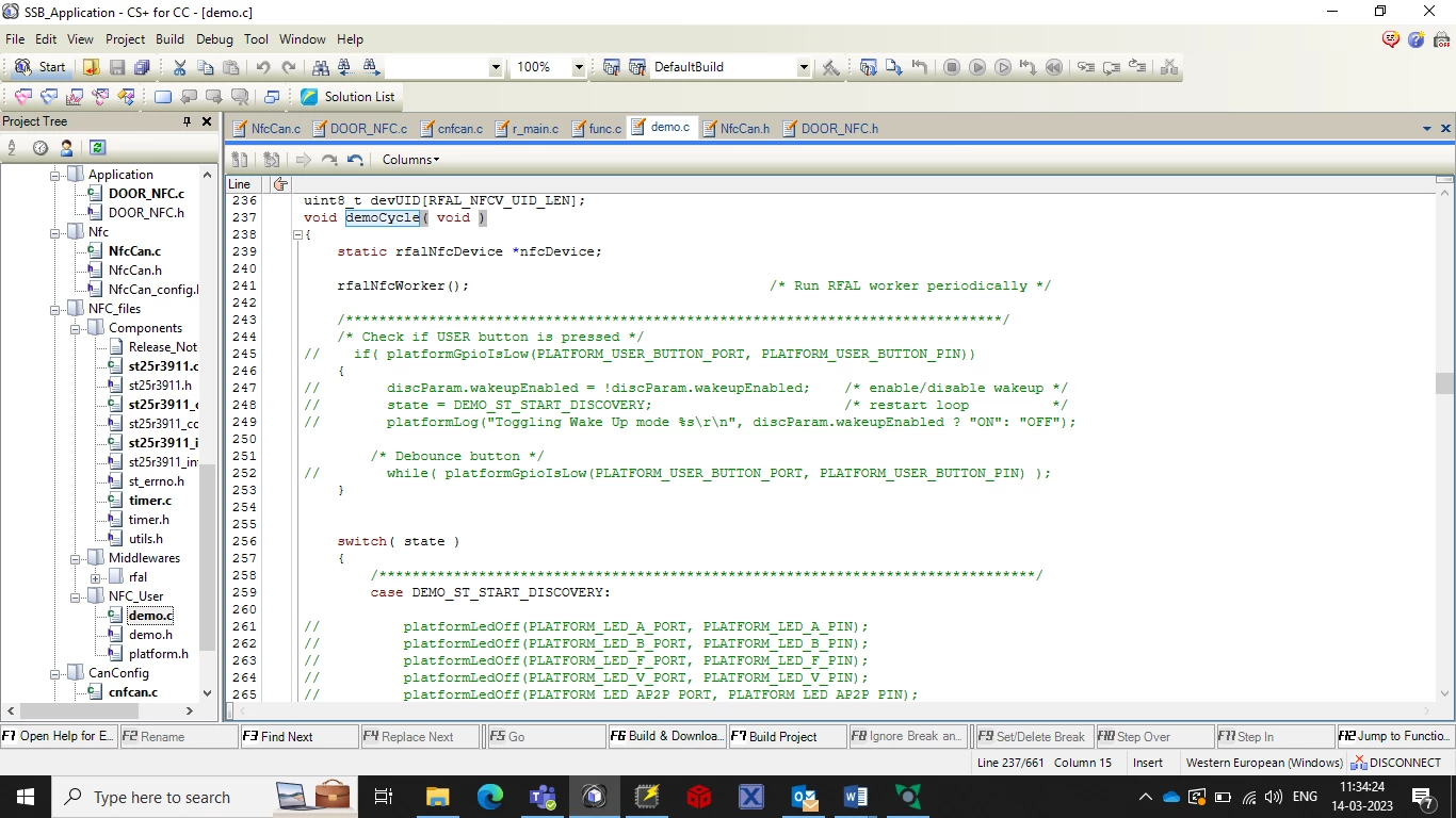

How fast can we detect NFC card with ST25r3914 Reader IC .using RFAL stack
Hello we have integrated ST NFC RFAL stack with RL78 IC and currently we are able to detect NFC card within 1-2seconds. Is there a way to reduce this time less than 1 second to detect NFC card ?

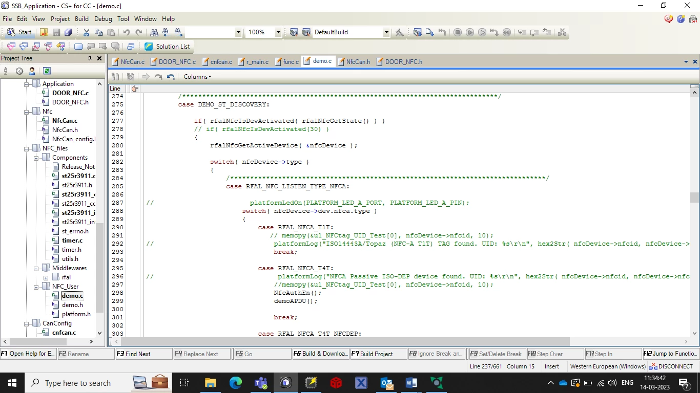

0693W00000aIt19QAC.png0693W00000aIsoLQAS.pngThis is inside democycle() function ,
Here in RFAL_NFCA_T4T switch case we detect our tag.

as written by Brian before: Look into totalDuration which is a paramater to rfalNfcDiscover() and calling rfalNfcWorker() every 100ms will make NFC communication very slow. For NFC-A I expect multiple calls being needed before a tag is anti-collided. Go down to 1ms or even below.
Regards, Ulysses

So I have tried to reduce totalDuration to 100 , 200ms but there is no change in card detection delay Also same for calling rfalNfcWorker() every 100ms I tried to reduce it to 10ms and 1ms but there is no change.
