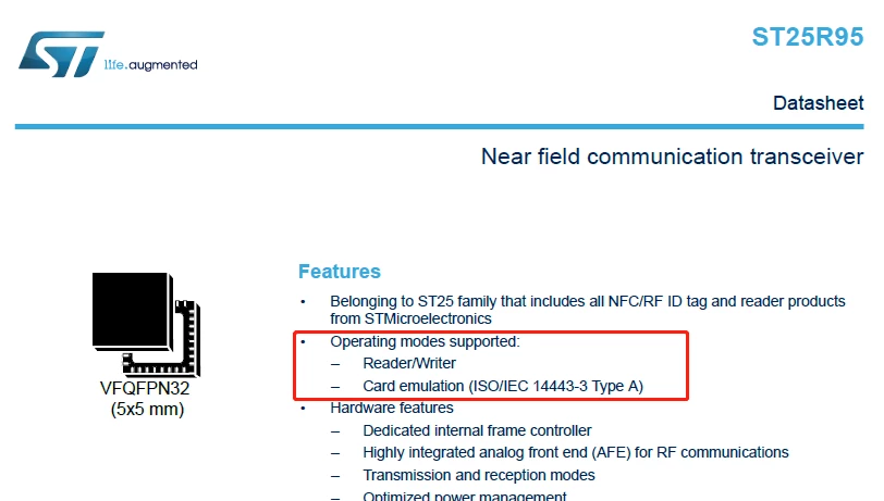

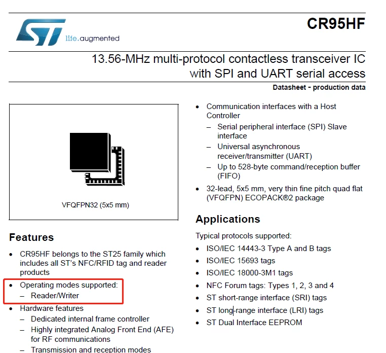

How Emulate NDEF with CR95HF (card emulation) ?
I Use STM32CubeExpansion_NFC3_V2.1.0 for emulate card with NUCLEO-L476RG and X-NUCLEO-NFC03A1.
I can't find a example code for NDEF emulation card.
Does anyone have a example code for NDEF Emulation card ?
Card emulation feature is not written in the datasheet of CR95HF,but it's written in the datasheet of ST25R95, and they use the same sample project. So can anyone tell me the difference between CR95HF and ST25R95.Does CR95HF support NDEF card emulation featuren?

    Hi Peter,
    thanks for using ST25R95/CR95HF product.
    You will find some informations about the differences between CR95HF and ST25R95 in the following post: https://community.st.com/s/question/0D53W00000Bsjx4SAB/differences-between-st95hf-and-st25r95.
    Card Emulation source code is not part of the X-CUBE-NFC3 v2.1.0 but I will provide it to you in private.
