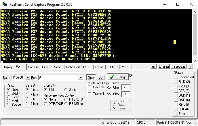

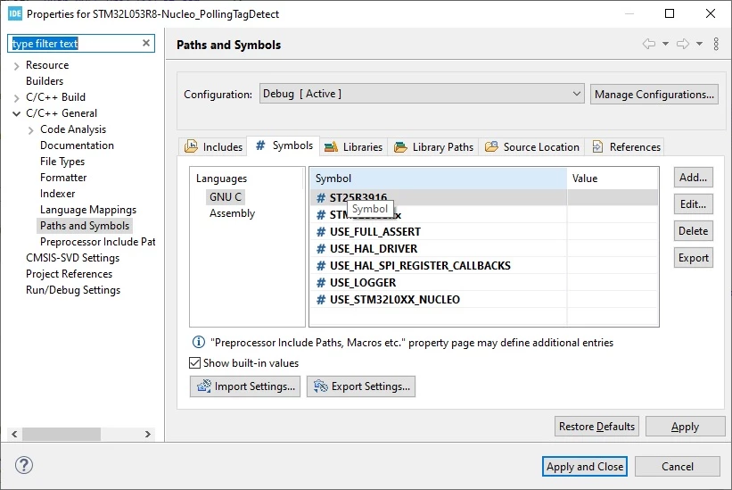

Mickaël Bucher
Apr 2, 2021 7:46 AM UTC
Hello Brian,
Sorry but I debug the application and I realize I am using demoP2P( nfcDevice ) instead of demoCe( nfcDevice );
I add DEMO_CARD_EMULATION_ONLY in Symbols of the project (see picture) but it don't work
Can you explain me how use demoCE( nfcDevice ); ?
can you confirm me that an emulated card is recognized by ios 13 and more ?
Rgds

Ulysses HERNIOSUS
Apr 6, 2021 8:29 AM UTC
Hi Mickaël,
I think you are running into an issue which I recently discovered: You need to set the define ST25R3916 to have card emulation operational. You will see the relevant code in demo.c is not activated unless that define is set.
Yes, iOS will recognize NDEF content. AFAIK it only has limited support of NDEF types (for sure URI). I don't think that text is among the supported content.
BR, Ulysses

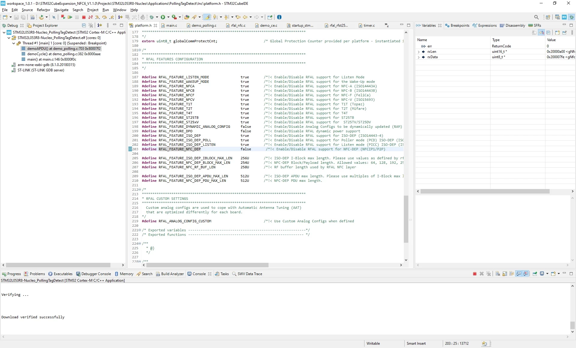

Brian TIDAL
Apr 5, 2021 7:52 PM UTC
Hello Mickaël,
I believe iOS does not support P2P, so can you share more details on the reader device being used during tour test in front of the ST25R3916 while having P2P?
Can you elaborate on what is not working when using DEMO_CARD_EMULATION_ONLY? I would suggest to set RFAL_FEATURE_NFC_DEP to false to disable Active P2P.
Rgds
BT
Mickaël Bucher
Apr 6, 2021 8:31 AM UTC
Hello Brian,
I set RFAL_FEATURE_NFC_DEP to false to disable Active P2P in the file "platform.h" but in debug mode, RFAL_FEATURE_NFC_DEP stay to true, why ?
I apply a smartphone and I go to demoAdpu and with an other smartphone, I go to demoP2P.
How can I go to demoCE for Emulated Card ?
is this mode recognise by android and ios ?
Rgds
MB

Mickaël Bucher
Apr 6, 2021 9:08 AM UTC
Hi Ulysses,
I am a beginner with X-CUBE-NFC6.
I set RFAL_FEATURE_NFC_DEP to false in the file "platform.h" and ST25R3916 in properties of project, is it the good way to run DemoCE ?
The application always go to demoAdpu and demoP2P.
Regards,
