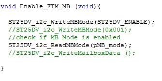

How do I enable the Fast Transfer Mode (FTM) for writing into the Mailbox of the ST25DV Discovery Kit?
  • February 12, 2019
  • 1892 views
I'm working with the Software "STSW-ST25DV001" for the ST25DV Discovery Kit as part of my seminar paper. Unfortunately I can't enable the FTM Mode. I'm a little bit confused because the FTM Demo of the Software enables the FTM, but I can't find the specific code in the project.
Can anyone help me?
I found the following function in the Code "ST25DV_i2c_WriteMBMode" but after checking the pMB_mode with the debugger of Keil uVision 5 the value of pMB_mode hasn't changed after execution the function.
Thank you in advance!
Best regards
Rebecca
    Best answer by Ronald B.
    Hi Rebecca,
    Your code example tries to enable the Mailbox using the static register MB_MODE.
    But, for a security reason, this is allowed only after an I2C session has been open by presenting the I2C password.
    And once the static MBMode is enabled, the code must also enable the MB_EN bit in MB_CTRL_dyn dynamic register, in order to be able to write data to the Mailbox.
    Here a simple working example enabling the mailbox:

    For your information the STSW-ST25DV001 provides an example of mailbox management to exchange frames with a NFC reader or smartphone: this is implemented in mailbox.c.

    Hi Ronald,
    thank you very much for your message! Now enabling of the FTM is possible! And thank you for the hint concerning the mailbox.c file. Before I didn't recognise the fille because the file isn't listed in the upgraded Firmware-Version.
