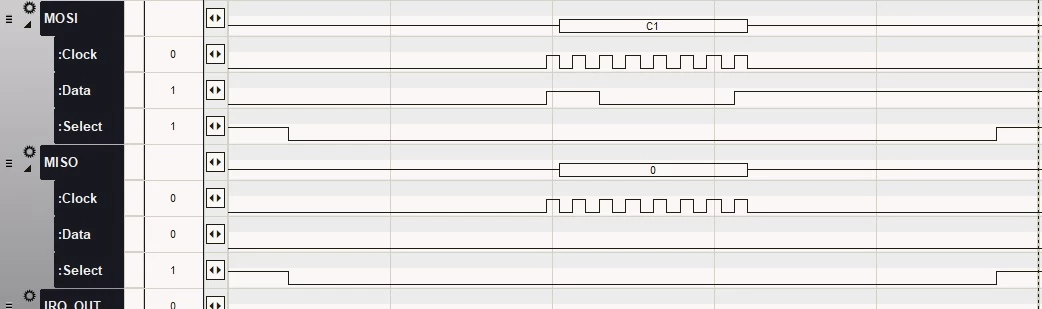

Regarding your initial question, the direct commands values in table 13 of the ST25R3916 datasheet include the heading 11b. This simplifies the reading of logic analyzer traces as we have the direct value of the byte being sent.
For example, here is the sending of Set default (C1h) command on SPI
0693W00000D0xD1QAJ.jpgRgds

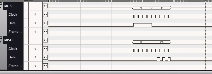

here is an example of reading the IC identity register (3Fh):

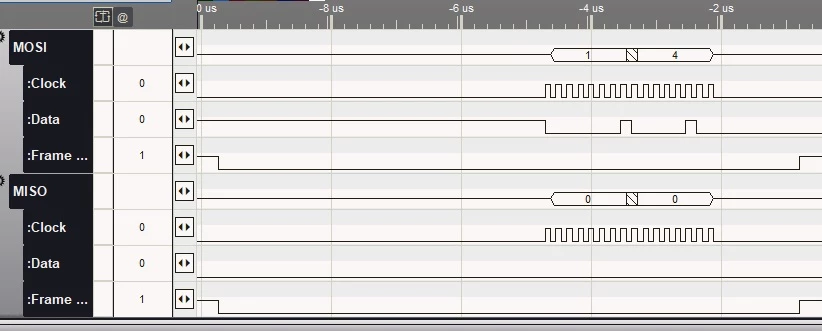

0693W00000D0zm0QAB.jpghere is an example of writing IO configuration register 2 (01b):
Again, I would recommend to use the firmware provided on st.com. This manages the various SPI accesses and provides a user level API rather than a register based programming.
