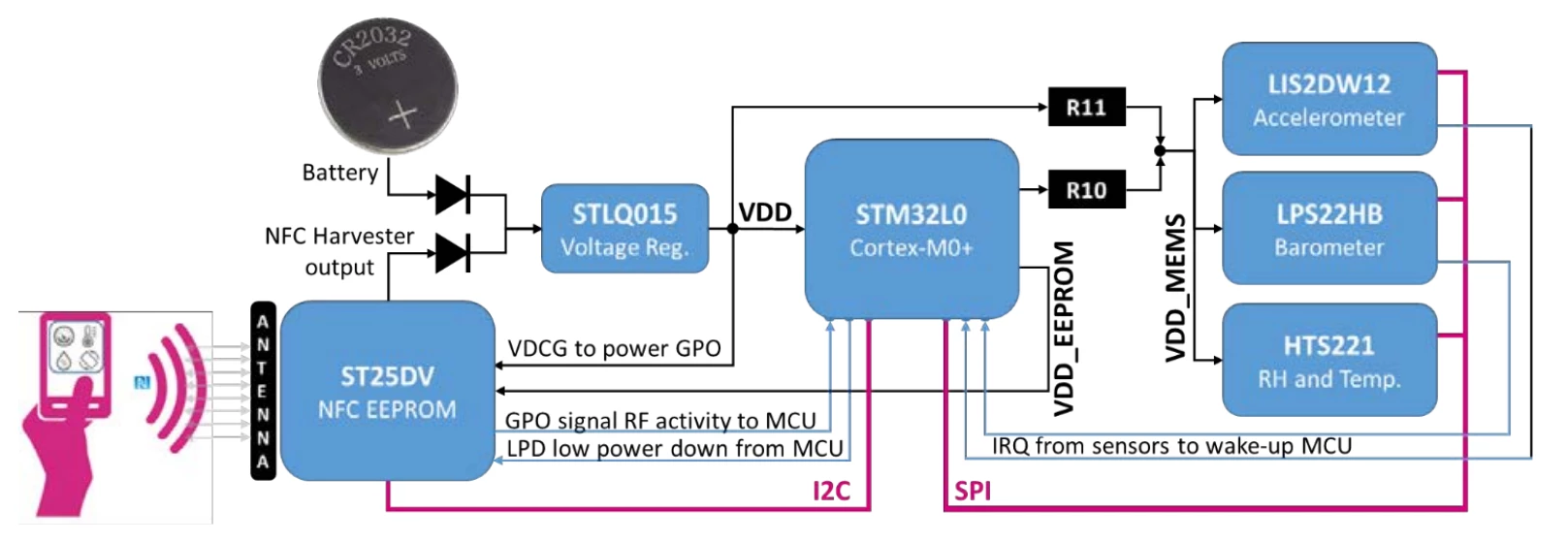

Just wondering if it's possible to add an extra sensor (SPI) on the STEVAL-SMARTAG1? Can the SPI sensor be replaced to complete the acquisition?
Best answer by John TRAN
Hello there,
It is not recommended to modify the smartag board hardware. The traces and landing pads would not survive. Therefore, we prefer that you use the board AS-IS.
Best regards

On STEVAL-SMARTAG1 there is no direct access to any SPI lines. Additionally, the only sensor that uses SPI interface is the LIS2DW12: it uses a 3-wire SPI where MISO and MOSI are connected together.
Hope this help. Best regards.

Hi @Michael GALIZZI
Yes, the sensor's circuit is i2c communication. But I want to use three-wire SPI communication to complete the sensor acquisition, what pin should I use to complete the circuit? Doesn't the figure below mean SPI communication?GB~A`(A0D$YU`GBWB(TDIIT.png

Hello there,
Best regards
