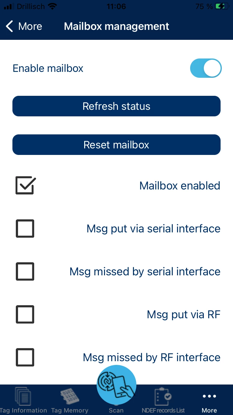

How can I write data to the mailbox via the iOS App?
After the last update the app is not crashing anymore, But how can I write data to it via the App. IMG_9F780B835FBA-1.jpeg
All toggles are not clickable. And the code example of the MX_NFC7_Process this function is completely empty.
I realized to read the status by copying the lines:
 NFC07A1_NFCTAG_ReadMBCtrl_Dyn( NFC07A1_NFCTAG_INSTANCE,&mbctrldynstatus );
 printf( "\n\r\n\rCtrl MB status register value:" );
 printf( "\n\rHost(i2c) Missed Message = %d", mbctrldynstatus.HostMissMsg );
 printf( "\n\rRF(reader) Missed Message = %d", mbctrldynstatus.RFMissMsg );
 printf( "\n\rHost(i2c) Put Message = %d", mbctrldynstatus.HostPutMsg );
 printf( "\n\rRF(reader) Put Message = %d", mbctrldynstatus.RfPutMsg );
 printf( "\n\rMailbox Enable = %d", mbctrldynstatus.MbEnable );
And I can modify the MbEnable bool via the app but I would like to write a message via the app. Is there a way to do so. Kind regards,

you're right : mail box management display only shows the status of the mail box. You cannot interact with it.
If you are using a ST25DV Discovery board, you can read/write data by using the simple FTM protocol we implemented.
For writing some datas :
- Select FTM icon on Discovery board
- in iOS NFC Tap :
  • read tag , then select "FTM demo" => 'FTM-Data Transfer' menus
  • By default, "Write" Mailbox buffer is selected.
  • Enter Data to write in "write buffer" text field
  • Enter number of byte to write
  • then click start.... => This will write data into Mailbox then at the end , a read from mailbox is performed for checking data wrote.
For reading some datas :
- Select FTM icon on Discovery board, then clik on 2nd icon on the bottom left (the one with text and pen). Enter a number of KB to transfer. "1" is enough then click return arrow.
- in iOS NFC Tap :
  • On iOS NFC Tap, then select "FTM demo" => 'FTM-Data Transfer' menus
  • Deselect switch "write / read Mail box buffer" => This will allow read
  • then click start ....=> This will read 1Kb from mailbox then display contents on buffer
Hope it helps
Br
