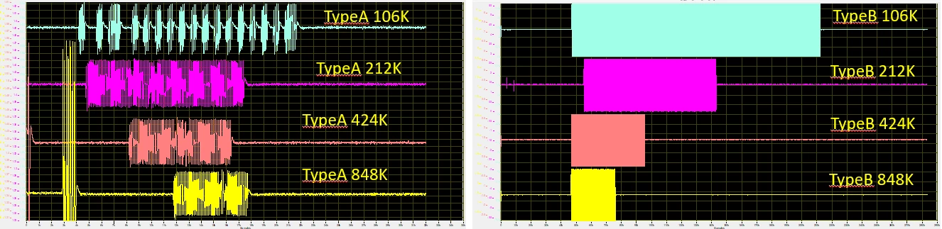

Hi All,
I am trying to demodulate the signal of ISO14443A&B using ST25R3911B. In the case of Type B, I was able to receive data well by setting the type setting and Bitrate, specifying the preset with a direct command, and then setting the unmask. However, in the case of Type A, I checked while changing several registries, but the FIFO data was empty. By capturing the waveform directly with the analog pin, I was able to confirm that the data was coming out well.
So I think it's a registry setting issue, so please let me know if there is anything I need to check regarding this.

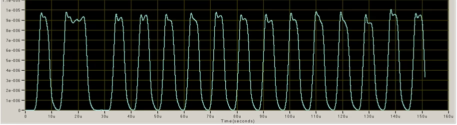

I want to put REQA as an analog source in another device and see the digital data coming out as FIFO from the ST device.
However, this did not work, so I set it to test mode for debug and checked the analog signal at the CSI pin.
That signal is:
Looking more closely, in the case of Type A, I confirmed that the signal below matches the target value of 04 00 after Demodulated + Gaussian filter, before data parsing. So, I was thinking that the reason there was no response from the FIFO in Type A was the register setting, but I don't know how to set it, so I'm asking.
