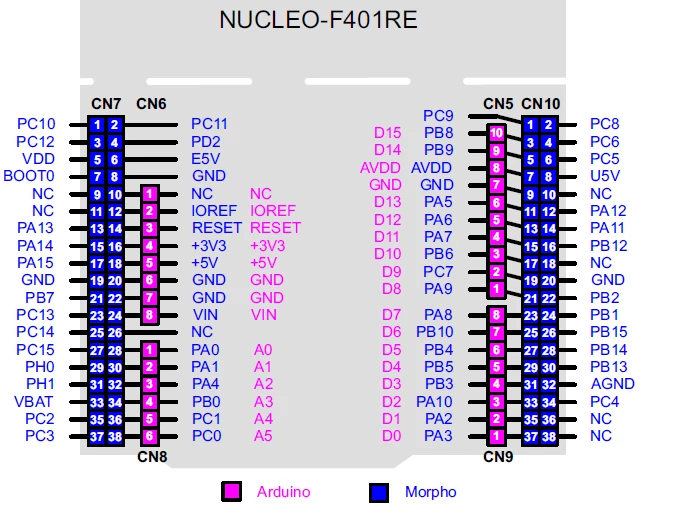

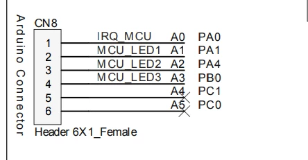

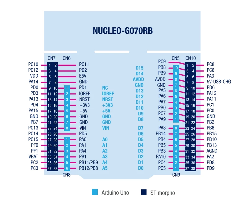

Best answer by Kamil Duljas
Hahah, It was good journey :D I think that manual of NFC board is customized for few boards with the same pins .e.q F401, L476 etc. .... and You on other board must check and correct eventually differences. For example:
_legacyfs_online_stmicro_images_0693W00000biwh9QAA.pngMCU_LED3 on dedicated boards is PB0, look on F401:
_legacyfs_online_stmicro_images_0693W00000biwhEQAQ.pngbut on G0xx you have PB1:
I'm happy that works. Mark some answer as best please :)

Kamil DuljasBest answer
Senior III
April 27, 2023
