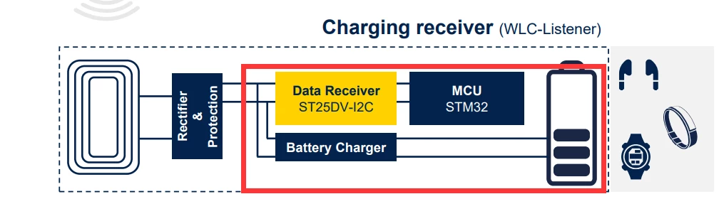

I understand that I have exited the NFC WLC function and I currently have X-NUCLEO-NFC07A1. How do I charge the WLC-Listener using the battery charging function shown in the legend?ST8[R[ZA)(]D$N`_8YVB%}9.png

In ST pdf "NFC charging: The tiniest solution for wireless charging", I read that we have to use "negociated mode" in order to receive up to 1W, depending on the power class.
However, in the ST25DV-I2C datasheet, nothing is mentioned about it. Does anyone have information ?
Schuyler
SchuylerAuthor
August 21, 2023
Yes,I also obtained from PDF that ST25DV-I2C can be used as a listener, but I didn't find out how battery charging was implemented, nor did I give specific instructions. I don't know how NFC WLC can power MCU with up to 1W.

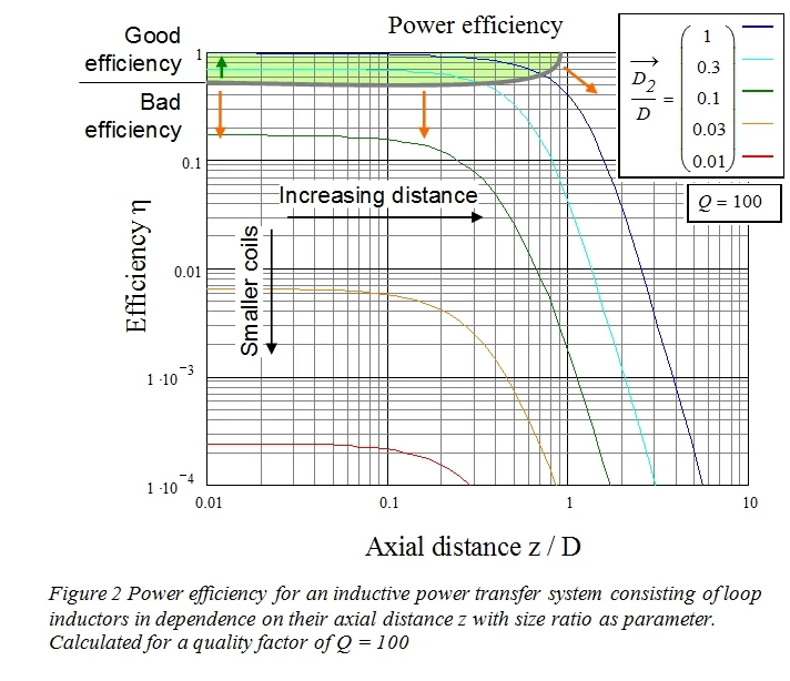

Another issue is energy waste. It's really annoying to have to spend time looking for the right position to get energy transfer efficiency.
  • The efficiency drops dramatically at larger distance (z/D > 1) or at a large size difference of the coil (D2/D < 0.3)
  • A high efficiency (>90%) can be achieved at close distance (z/D < 0.1) and for coils of similar size (D2/D = 0.5..1)
figure2
https://www.wirelesspowerconsortium.com/knowledge-base/magnetic-induction-technology/effficiency/transfer-efficiency.html
VGros.3
August 21, 2023
@RhSilicon Thanks for your answer, the power efficency graph is interesting

Hi @Schuyler,
WLC NFC Charging is a standard defined by the NFC Forum, and is aimed to charge small batteries. There is a communication protocol between the Poller and Listener to negotiate power. It is not intended to use in another application, you need at minima an NDEF message to start a charging phase. WLC NFC Charging is composed of multiple Wireless Power Transfer phases and is not always providing full power at any time, this is negotiated between Poller and Listener during exchange phases.
Regarding ST25DV-I2C it is not designed to work for WLC alone, you'll need an MCU that must communicate with the Poller through NDEF messages (and manage the WLC protocol), and you'll need the Rectifier and Protection stage that is not framed in your first post.
I hope this will help you.
Kind Regards.

Hi @Rene Lenerve
 ST25DV-I2C it is not designed to work for WLC alone, I'll need an MCU that must communicate with the Poller through NDEF messages,but according to the instruction manual, the listener only needs three modules: L, ST25DV and battery charging. Is there any specific description of the NDEF protocol of MCU you mentioned?
Kind Regards.
Rene Lenerve
August 24, 2023
Hi @Schuyler ,
NFC WLC is a specification defined by the NFC Forum, they have defined a communication protocol via NDEF messages in order to negotiate between Poller and Listener the power to charge a battery and is not intended for other applications. Refer to the NFC Forum web site for more information on that topic.
As explain earlier, ST25DV (as other tags) risks overheating if the Poller increases its power. So for WLC you need Hardware components that protect the tag and recover excess energy for the charger (first stage in your screenshot "Rectifier and Protection").
Hope this can help you.
Kind Regards.
