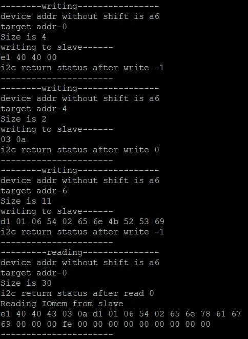

Hi, Im using ST25DV04 with ESP32. Im unable to write tags onto NFC. I2C Communication fails.
  • August 18, 2021
  • 16 replies
  • 7274 views
0693W00000DpfBTQAZ.jpgDuring initialization of CC, as I understand we should have values 0xe1,0x40,0x40,0x00
But I am getting 0xe1,0x40,0x40,0x43. Im trying to manually write 0xe1,0x40,0x40,0x00 at address 0xa6, 0x00 which is failing.
I ignored that and tried to write a text NDEF tag to it which is also failing.
Please check the screenshot.
Step1 : Im writing CC at 0xa6,0x00 address- which failed.
Step2 : Writing length at 0xa6,0x04 address - success
Step3 : writing text NDEF tag at 0xa6,0x06 address - fail
Step4 : reading NDEF data- reading old text NDEF tag present on NFC.
Why is the write operation failing ? Are there any other registers to be set before writing?
Best answer by JL. Lebon
"While addressing the device itself, there is no acknowledgement": do you mean after the first byte (the device slave address) there is not acknowledgement ?
This means that the device is not available for processing an I2C command. This can happen in 3 cases:
  • the device is not powered with Vcc.
  • the device is busy on the RF interface, processing an RF command.
  • the device is busy writing data into EEPROM after an I2C write command.
I guess you may be in the third case. I suppose you are writing the terminator TLV right after updating the NDEF message content ?
When updating the NDEF message, you are writing into the EEPROM memory. The I2C bus is then unavailable during the programming time of the EEROM: the device needs 5ms to program each 4 bytes of data. The write is starting at the stop bit of the I2C write command.
So, you should wait the end of EEPROM programming before being able to access the tag again.
This is explained in the datasheet, in chapter "6.4.2 I2C Sequential write".
Best regards.

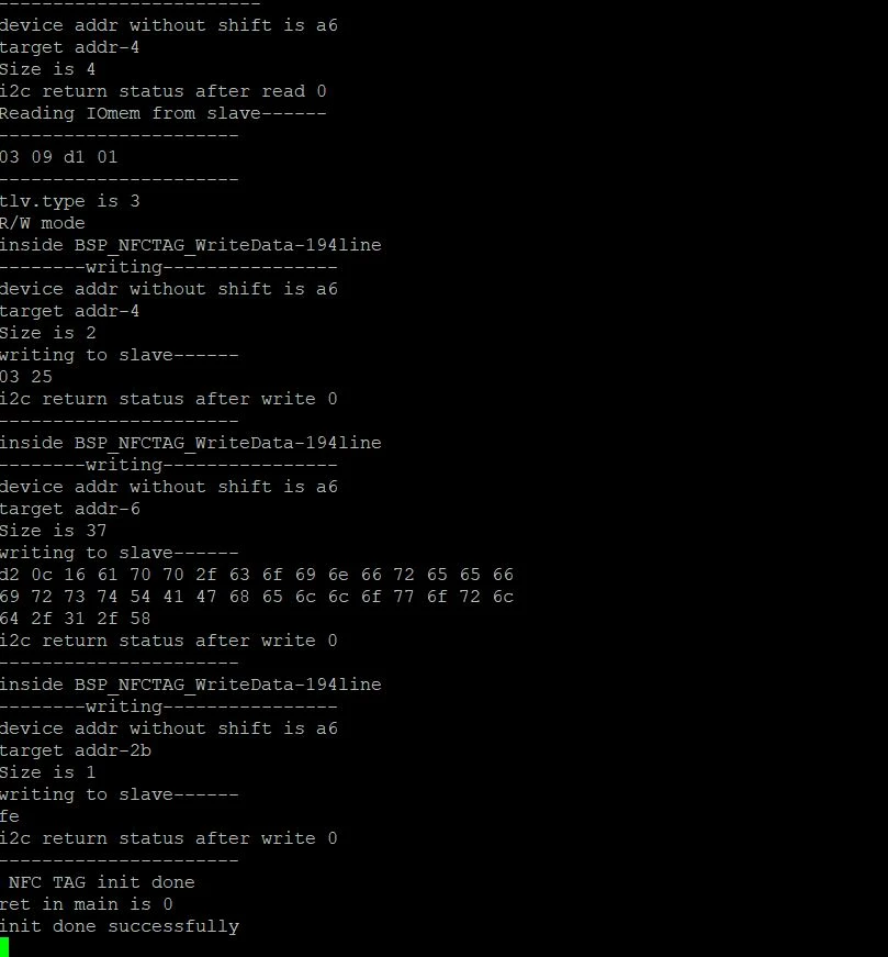

Thanks for the suggestion. I made the necessary changes and now I2c is writing without any return errors.
But I don't see the tag updated on NFC. I'm using NFCTools mobile app to scan, and the tag is not updated.
I'm writing a media type tag from program to NFC.

Shruthi
ShruthiAuthor
August 27, 2021
This the NFC content I'm reading after my write function.
Im writing media type tag, whereas, there is already an existing text type tag which is not updated after my write.

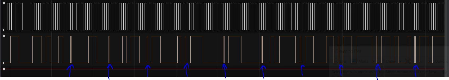

September 3, 2021
This is how I'm seeing on logic analyzer.

JL. Lebon
September 3, 2021
Hello Shruthi,
Thank you for the trace, it really helps to understand the issue.
Your I2C trace shows that the I2C writes are not correctly framed.
In the Session_I2C_Init trace, you can see that starting at time 3172501208.
Your write frame is this:
Start/A6/Ack/00/Ack/04/Ack/03/Ack/Start/A6/Ack/C1/Ack/Stop.
I guess you are trying to write value 03h at address 0004h, and then value C1h.
There is two things wrong in this sequence:
  • An I2C write MUST be terminated by a STOP bit. After the byte 03h, you do a new START, so the write value 03h at address 0004h is not executed
  • After the second START bit, you present the device select slave address, and then what seems to be a value to be written. But after the START, the ST25DV assumes this is a new write sequence, and is waiting for a memory address on 2 bytes at this place. So the write of value C1h is not executed
This is all explained in detail in datasheet chapter "6.4 I2C Write operations".
Correct sequence is:
Start/A6/Ack/00/Ack/04/Ack/03/Ack/C1/Ack/Stop.
or, if you want to do it in 2 times:
Start/A6/Ack/00/Ack/04/Ack/03/Ack/Stop Start/A6/Ack/00/Ack/05/Ack/C1/Ack/Stop.
The next write sequences all suffer from the same problem, and this is why no data is ever written to the tag's memory.
Best regards.

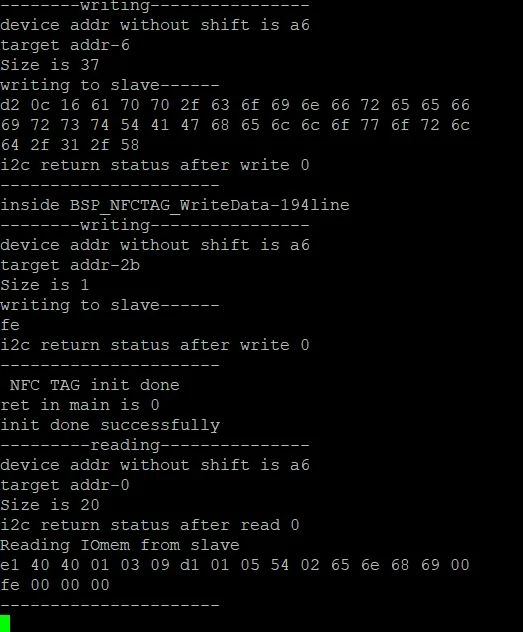

Shruthi
ShruthiAuthor
September 21, 2021
Thanks much for the support. I corrected the I2C sequence and I'm able to write the tag onto NFC now.

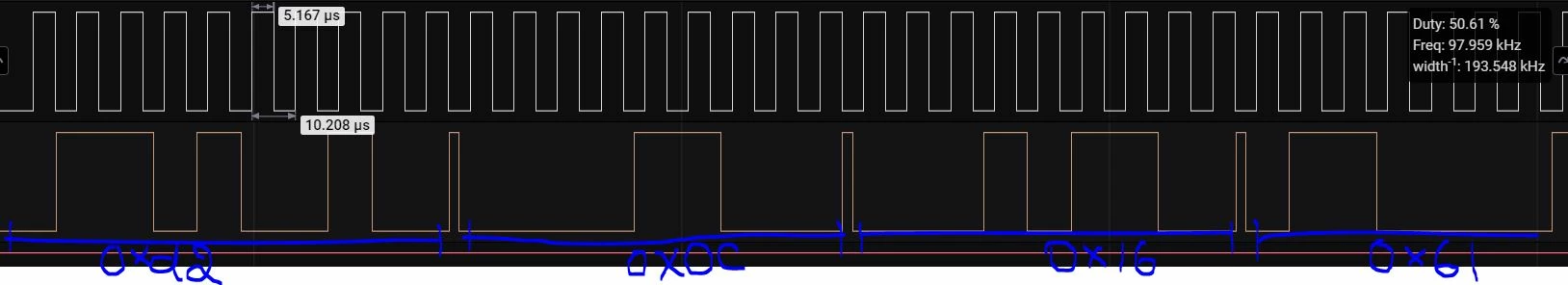

But after writing the tag, the last terminator byte 0xfe is failing. while addressing the device itself, there is no acknowledgment.
Saleae is used.
Ch0-SCL ; Ch1 - SDA
JL. Lebon
JL. LebonBest answer
September 23, 2021
Best regards.
