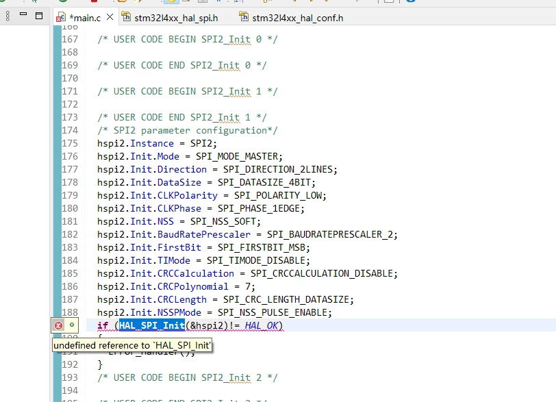

Here is my code to add the SPI function. But undefined reference to 'HAL_SPl_Init'.

    Obviously, stm32l4xx_hal_spi.c is not included in your project. I suggest to check.
    Rgds
    BT

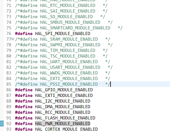

    if I am not wrong, X-CUBE-NFC7 demos are delivered with an STM32CubeMX project file (.ioc file). It is not recommended to modify generated code but rather to use STM32CubeMX to add and configure peripherals. When regenerating the code, STM32CubeMX automatically updates the IDE project file (such as adding stm32l4xx_hal_spi.c and stm32l4xx_hal_spi_ex.c in the project file and defining HAL_SPI_MODULE_ENABLED inside stm32l4xx_hal_conf.h).
    Make sure to have #define HAL_SPI_MODULE_ENABLED inside stm32l4xx_hal_conf.h and make sure to have stm32l4xx_hal_spi.c and stm32l4xx_hal_spi_ex.c in your project.

    Hi,@Brian TIDAL_O​
    I have checked the relevant content and found no problem.  stm32l4xx_hal_spi.c and stm32l4xx_hal_spi_ex.c in my project and able to jump correctly.I don't know what the problem is.0693W00000bhS90QAE.png0693W00000bhS95QAE.png0693W00000bhS8bQAE.png

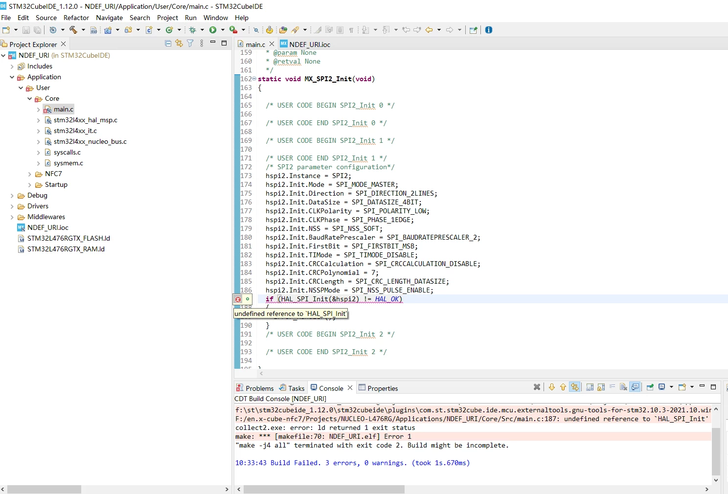

    what is the exact output of the compiler/linker?

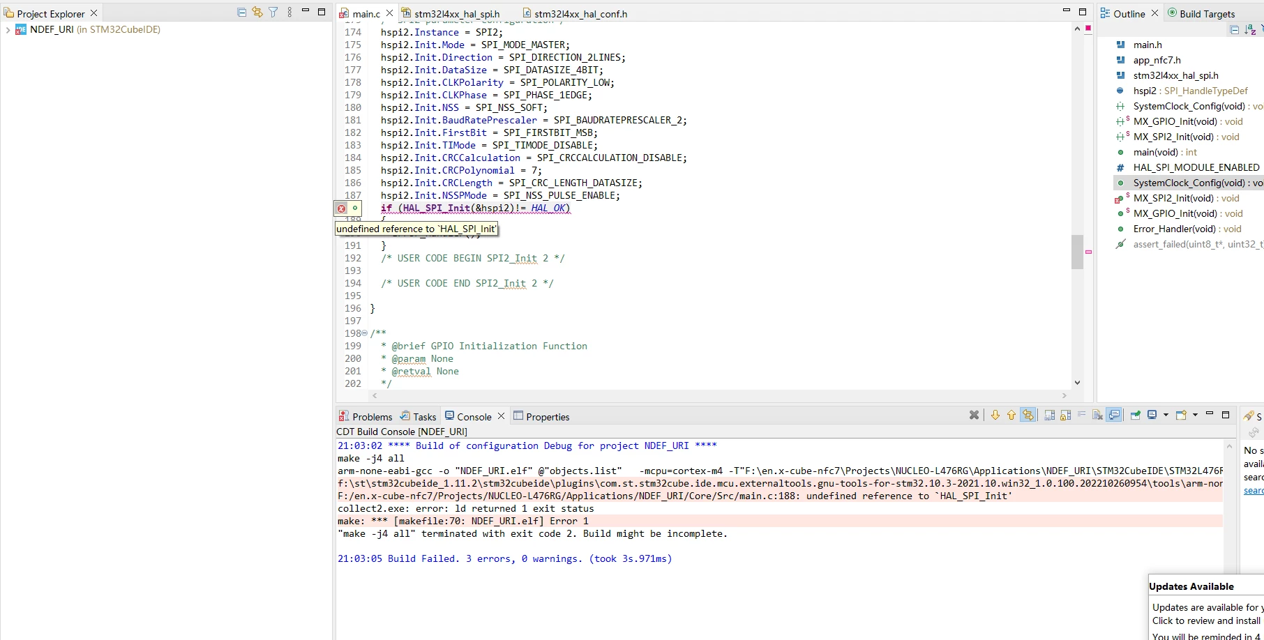

    Here is the output of the compiler/linker,my code is from STM32 cubemx and make sure  have stm32l4xx_hal_spi.c what should I do?0693W00000bhUq6QAE.png

    I believe there was an issue to regenerate the project while it was already opened/locked inside STM32CubeIDE. I would suggest to clean the project, close it, remove it from the workspace and re-import it.

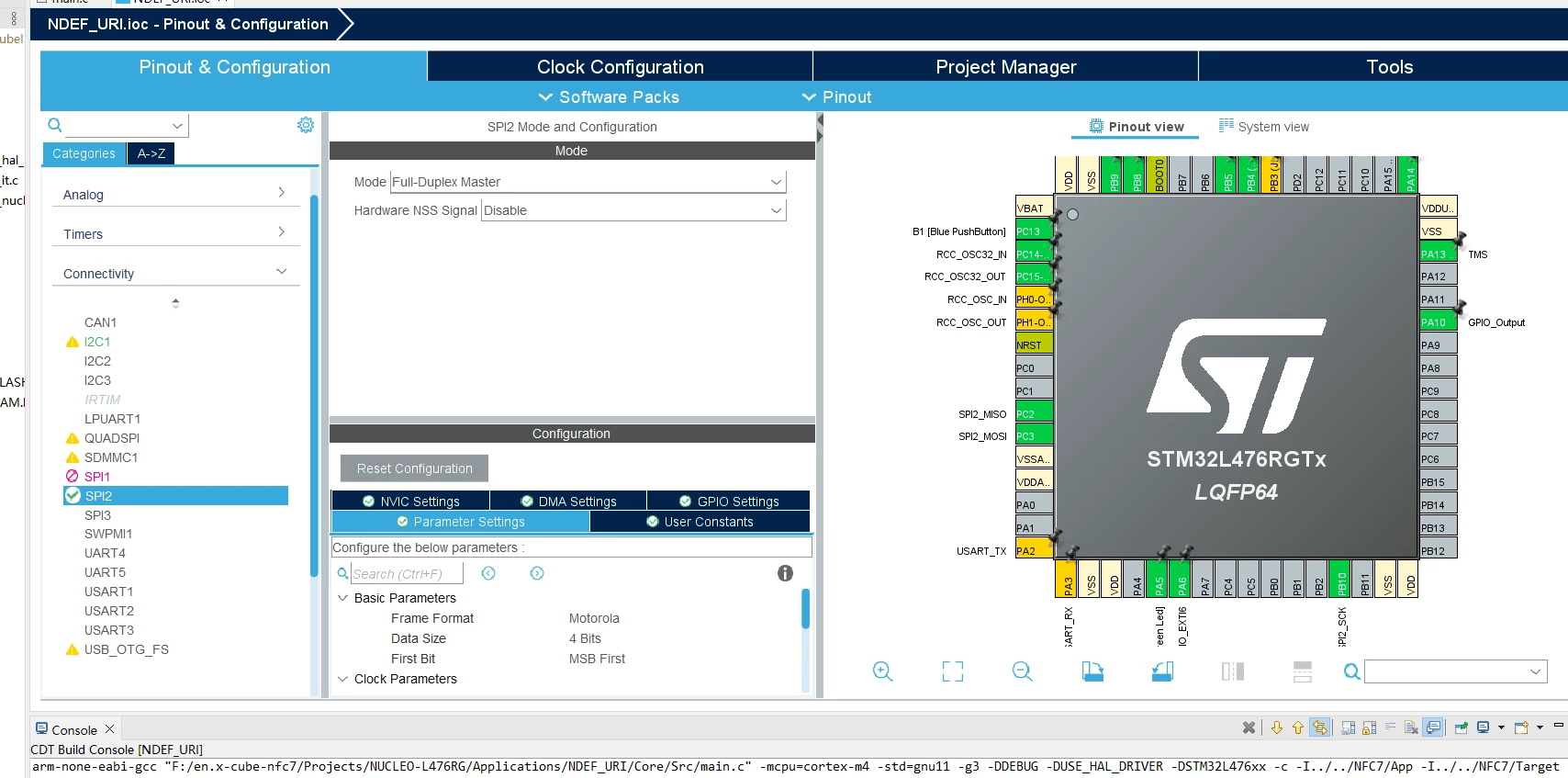

    April 5, 2023
    I also think I have problem, but I don't know what should I do? 0693W00000bhXVfQAM.png0693W00000bhXVpQAM.png

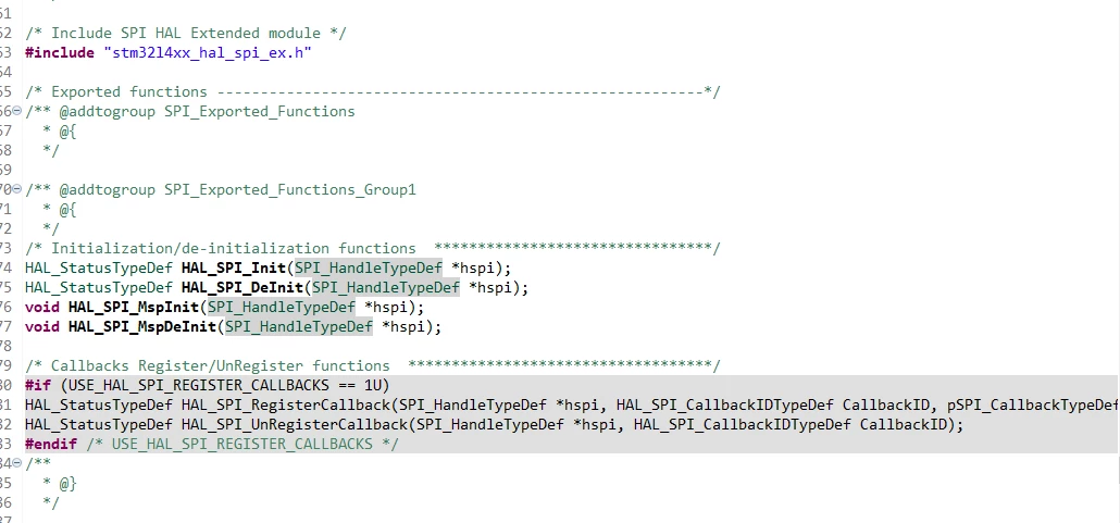

    April 6, 2023
    I check my project ​according to your advice,and run the codes successfully. Thanks!
