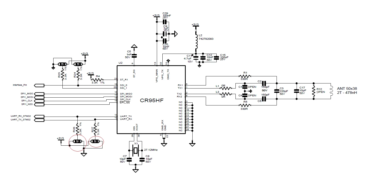

I am working with a local customer on a new CR95HF design and was hoping your team could provide feedback on some of the questions they submitted today related to schematic capture:
1. The RF output of CR95HF (TX1, TX2) is first connected to an EMC filter (L1, L3, C1, C4), do you have recommended component values for this EMC filter? (Note that their product will be first launched in US.)
2. Within the CR95HF demo board schematic (please see attached), it is not clear to them how the two resistors (circled in picture) are mounted. Could you provide some guidance here?
3. We noticed that CR95HF supports two VPS_TX range: 2.7V � 3.3V, 4.5V � 5.5V. What, if any are the performance tradeoffs between these two operating conditions? For example, if they drive a higher VPS_TX, will the NFC range be larger compared to a lower VPS_TX?
Thanks in advance for your help.

NX2520SA, a 27.12-MHz EXS00A-CS01206 crystal oscillator for CR95HF transceiver
http://www.st.com/st-web-ui/static/active/jp/resource/technical/document/user_manual/DM00068980.pdf

The customer came to me this afternoon with one addition question.  Essentially, on the demo board (CR95HF) schematic, it seems that the 27.12MHz crystal used is from NDK (NX2520SA). Could you help identify the detailed manufacturer part number used (As you know, the last digit of part number could affect some parameters such as ESR and load capacitance)?
I looked on the eval board BOM and the part number on that document is identical to the schematic.
Thanks again for the help.
