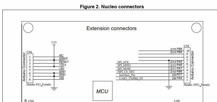

hello,I have a question that X-NUCLEO-NFC03A1 cann't read and write X-NUCLEO-NFC04A1! By the way,My phone'NFC function can read X-NUCLEO-NFC04A1. I have Nucle0-64 STM32L433 to drive X-NUCLEO-NFC03A1.

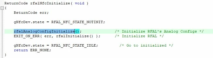

My project is tansplanted accordding to X-CUBE'STM32F401RE-Nucleo. main.c Functiong also is same. But when I am running ,the Program is dead. To the same time ,My warning LED that Nucle0-64 STM32L433 board' LED isn't lighting. Than I shield ---if( !demoIni() )----else-----,LED light. Finally,When I use ndef_example_read.c and ndef_example_write.c,program enter in HardFault_Handle. I also initialise my ST32L433 board through cube_MX,also According to X-CUBE'STM32F401RE-Nucleo.I want to know that NFC-CR95HF is developed ways and procedure. Thank you !

    Thank your for your patiently answer and guidance! According to X-NUCLEO-NFC03A1 instructions'Figure 2 Nucleo connectors, I initialized my NUCLEO-L433RC-P SPI1 that mapping PA5,PA6,PA7,PB6. we shouled use SPI2 mapping PB15 ,PB14,PB13. My error lead to demoIni() failing. Thank you again!

    First,I generate my Project,NUCLEO-L433RC LED is blinking normally.Accordding to your sending X-NUCLEO-NFC03A1, have modified differences . Then I plug the lib NDEF,RFAL,Commponents etc. Importantly,Main.c is plugged demo.c ,demo_ce.c,logger.c, not ndef_demo.c and ndef_dump.c. To the same time ,I shield ---if( !demoIni() )----else----,finding NUCLEO-L433RC LED not blinking. By debugging ,program is died in rfalNfcInitialize().

    can you give more information about your IDE? Keil/IAR/STM32CubeIDE?
    What is your stack size?
    can you give more information about "program died in rfalNfcInitialize()": is an hard fault triggered? Does the issue happen when executing rfalAnalogConfigInitialize or when executing rfalInitialize

    I've ported on NUCLEO-L433RC-P and did not faced any issue. You can unzip the attached package in STM32CubeExpansion_NFC3_V2.1.0\Projects and compile it with STM32CubeIDE. Can you share what was wrong on your side?
    Thanks
    Rgds
    BT
    KJame.1
    KJame.1AuthorBest answer
    June 17, 2020
