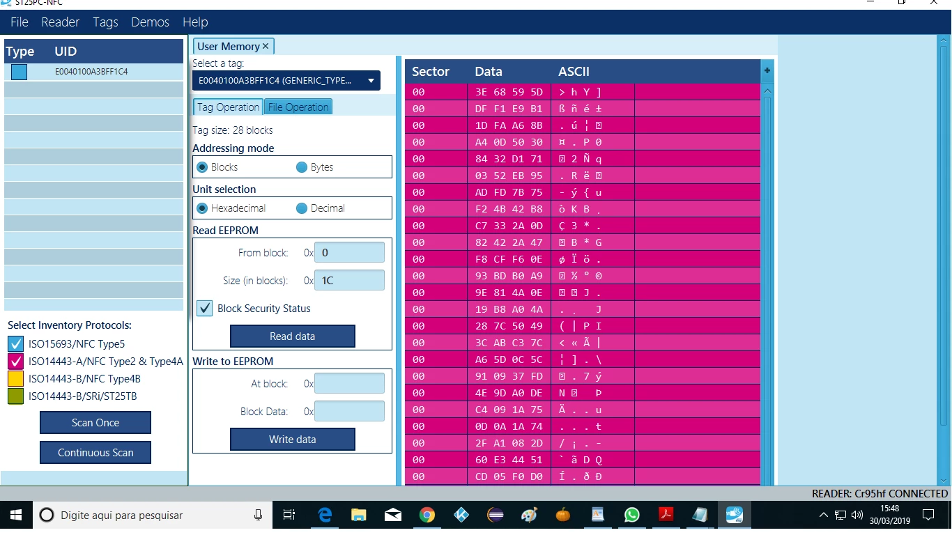

Hello, I am a beginner in NFC Tags and i want to understand what this blocks and hexdecimal means and I want to know how to create it.If is programing or if it has a training for this. Tahnks
Please see the Picture below
It is what the CR95HF reads this tag NXP ICODE SLI (ISO 15693)in user memory

    ​Hi,
    basically, this is the hexadecimal dump of the tag physical memory. The physical memory of a tag following ISO15693 standard is organized in blocks (or pages) of fixed sizes (e.g. 4 bytes).
    The list of commands that can be used to program a tag is defined in the tag manufacturer datasheet.

    But what i meant is how to build this hexadecimal dump of the tag
    For exemple: if i want that the first line (00) block(00) to count boxes in a conveyr belt.
    Which kind of program i have to use for write this instruction in a Tag?

    ​Hi,
    ST provides a complete middleware to build application using ST25 readers. For ST25R95 / CR95HF, you can download the X-CUBE-NFC3 v2.0.0 expansion software. You can then use the rfalNfcvPollerWriteSingleBlock() API to write a block.

    ​Hi,
    the list of supported Nucleo boards is available in User Manual "Getting started with the X-CUBE-NFC3 near field communication transceiver software expansion for STM32Cube™" (UM2045). The X-CUBE-NFC3 software comes with examples of implementation running on XNUCLEO-NFC03A1 plugged on top of one NUCLEO-L476RG, NUCLEO-F401RE or NUCLEO-F103RB. An example of rfalNfcvPollerWriteSingleBlock() is available in the demo.c file of the  X-CUBE-NFC3 package.
