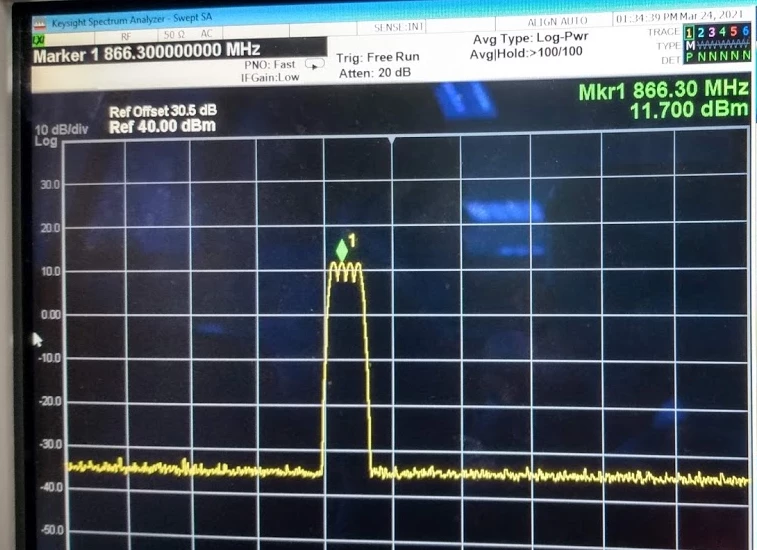

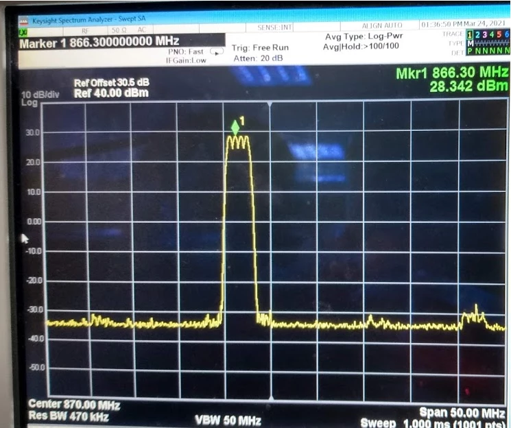

MSilv.3
MSilv.3Author
March 24, 2021
Hello Bart Herse,
I was use the Fast algorithm. So now I used the SLOW algorithm, but I had this result that you can see in this figures below.
I think this tunable capacitors not work very well.
This is tx sign.
0693W000008xnOMQAY.pngAnd then, this is rx sign.
0693W000008xnPZQAY.pngWhen I read the tunable capacitors these are the result: cin= 0x02 clen= 0x0 cout=0x1b.
So, Can you help me please?
Bart Herse
Visitor II
March 24, 2021
Hello MSilv.3,
What is the measurement procedure here?
The images shared suggest that first the carrier cancellation algorithm is run
and then the spectrum analyzer (SA) is connected for a measurement.
Note that when introducing the SA and any measurement cable and adaptors to the RFID circuit the carrier cancellation is void and any value measured with the SA is an incorrect value.
Important is the result of the reflected power that was measured by the reader IC because this is the point where the reflected power should be cancelled.
What reflected power value do you seen when measured by the reader IC?
Cheers,
B

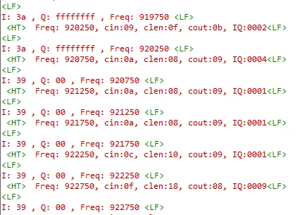

MSilv.3
MSilv.3Author
March 24, 2021
Hello, Bart Herse
This values was about transmissition power and reception power, but like you sad this values were wrong. Thanks for helping me understand this.
So, the values of I and Q can be seen in the figure below. 0693W000008xq4ZQAQ.pngSoon the calculated reflection power value is around 3,22dbm. I think there value are wrong.
Cheers,
Monalisa
Bart Herse
Visitor II
March 30, 2021
Dear MSilv.3,
since this output seems to be specific to you implementation can you please elaborate on how the data was formated/converted?
This should help to interpret the I and Q readings from the reader IC
