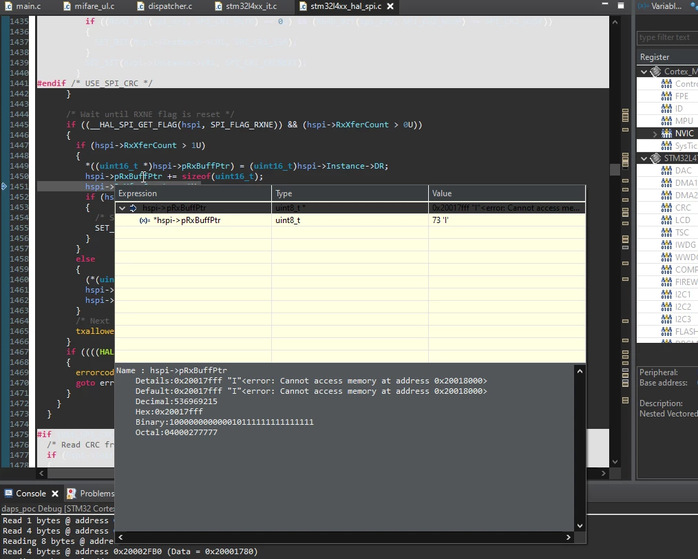

When I leave my code to play for more than one hour I received the error HardFault_Handler(), I found in registers whats the last line executed before entering in the error function, below I put a picture of this part of the code. 0693W00000AMXbnQAH.png
Note: That error is random, don't have a specific moment time when happens.

    Brian TIDAL
    April 26, 2021
    hpsi->pRxBuffPtr is at @0x20017fff which is the end of STM32L476 internal SRAM1 area. Access to next byte (@0x20018000) will cause a fault...
    it looks like a HAL_SPI_TransmitReceive call with an incorrect/corrupted length parameter...
    Rgds
    BT
    GPaiv.1
    GPaiv.1Author
    April 26, 2021
    I resolve the problem increase de size of my buffer then received information by tag.

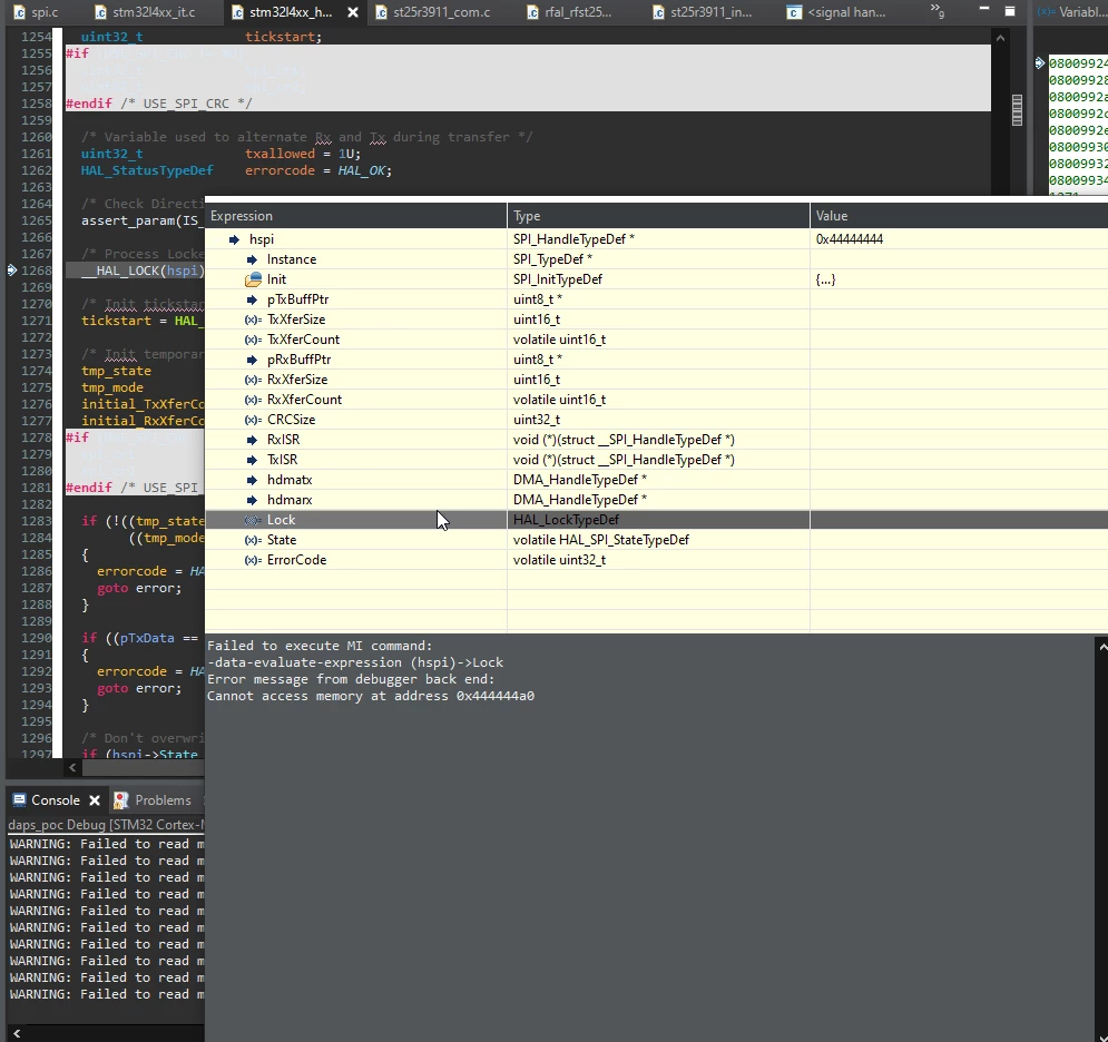

    But now I had a new problem, below has a print of my new problem.
    Brian TIDAL
    April 26, 2021
    hspi pointer seems to be corrupted (value 0x44444444: it looks like a buffer overflow has corrupted this pointer....).
    I would recommend to check buffers size.
    Rgds
    BT
