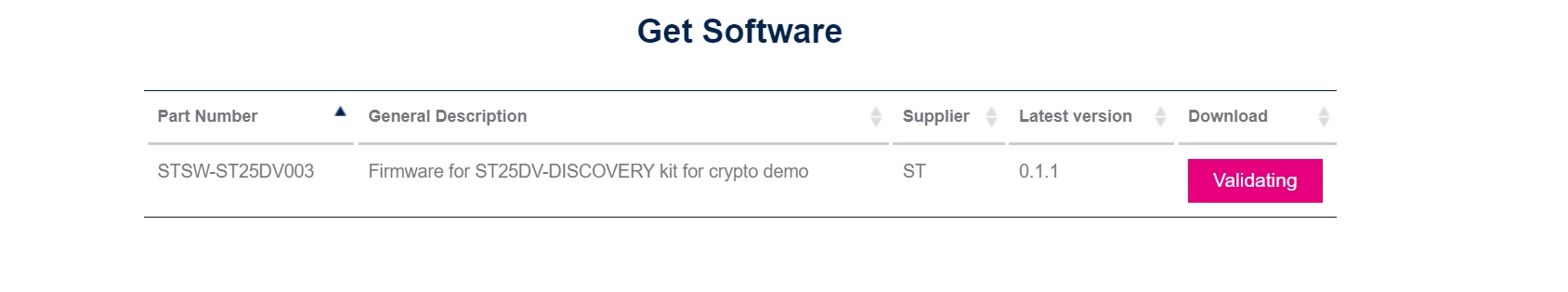

0693W00000YAXWQQA5.pngI would like to use the PC tool provided to test the FTM ( fast transfer mode) via 3916.
I am trying to get the compatible FW for that. Could not be more complicated.
The only FW I found to support it is: STSW-ST25DV003.
( Other FW's have old implementation back to 2015 with SNEP and P2P stuff that are practically irrelevant for today ( ST why do you keep that? ) Its very confusing )
The catch : STSW-ST25DV003 FW has crypto stuff in it ( that I don't need, I only need FTM ) and requires ST approval.
My approval has been validating for a month now. (says 48 hours..)

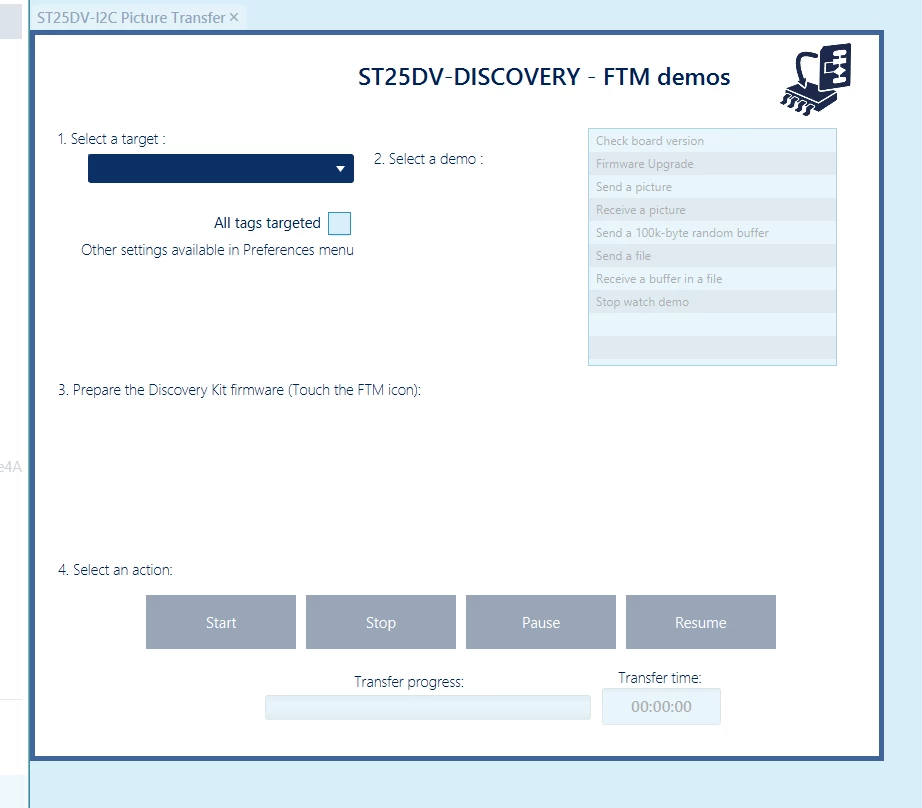

0693W00000YAXWkQAP.pngIs there another FW that supports both FTM and the PC tool for reader 3916?
Could you remove the crypt stuff and just release an FTM fw?
Or better, just validate?
    Best answer by Ulysses HERNIOSUS
    please check https://www.st.com/en/embedded-software/stsw-st25r-lib.html which contains a firmwares for NFC06 and NFC04. I presume it also works with the PC GUI.
    BR, Ulysses
