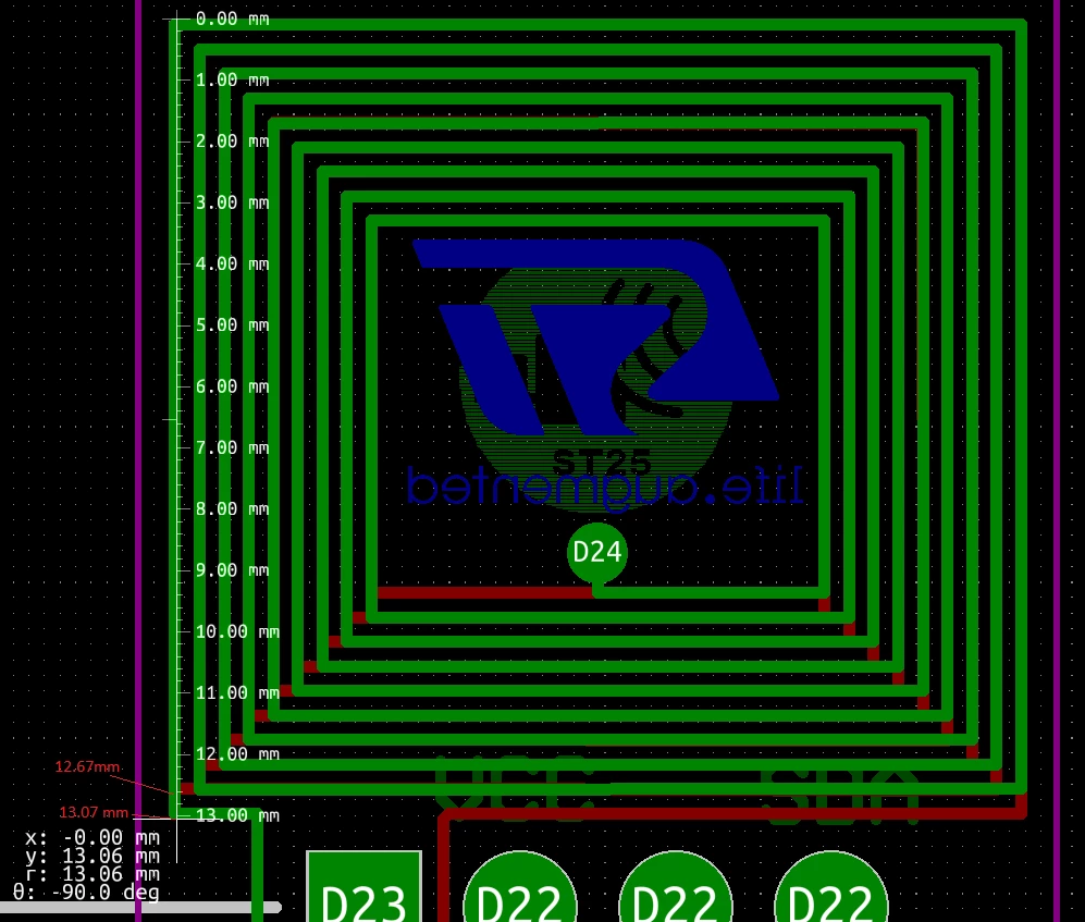

I am also looking for this, and I can't find a single reliable resource with formulas for two-layer antennas. However, I found a PDF from ST (see below), which lists the parameters for a few different single and double layer antennas. I am interested in using the ANT14x14_Double layer antenna as my board is 1.6 mm thick (unlike the ANT7 reference board, which is 0.8mm). Unfortunately, the inductance for this design is not listed, it is simply stated as "ANT8" which I have no idea what means. I can't find a reference design or anything called "ANT8".
Using ST's single-layer calculator, it seems that for the double-layer antennas with 0.8mm substrate thickness, the listed inductance is approximately (but not exactly in all cases) four times the calculated inductance in the single-layer case. I.e. for the ANT15x15_Double layer antenna, putting the parameters into ST's single-layer calculator gives us 1.12 µH, and the PDF lists 4.48 uH, which is exactly 1.12*4. I don't know what the multiplication factor would be in the 1.6 mm case.
Also, looking at the Gerbers, the ANT7 reference design does not seem to use any of the antennas listed in the PDF, at least not exactly.
I am tempted to use the parameters for the ANT14x14_Double layer and making layer traces overlap as in the ANT7 Gerbers. However, it would be very helpful if someone from ST or someone else with more solid knowledge could pitch in and validate this.
A question for @JDirk.1​ : When you measure on the ANT7 gerbers, what do you get for the length and width parameters? One of them seems to be pretty clearly 14.00mm, but the other one is either approx. 12.67 mm or 13.07 mm, depending on whether you include the last "half-segment" in the measurement or not. See my image.

I used the gerber file and for me it was 14,2mm x 13,0mm. 9 windings. ANT7 Antenna. The width of the wire is 0.2mm und the space in between also 0.2mm. I produced this Antenna on 0.8mm PCB. The Antenna is not working ... So in my diameter there is an error. I have the ANT7 evaluation board available as well, its working very well. its given with 14x14mm but i was not able to measure it in the gerber files.
