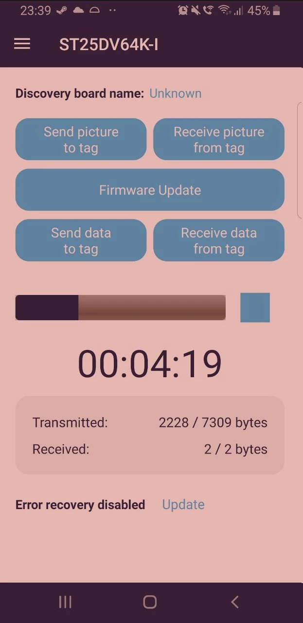

Dear ST Community,
Our whole team is really irritated by the behavior of a ST25 DV64K-I tag.
We want to use the NFC tag to transmit a firmware hex file (.bin).
For testing purposes, we used the ST25 NFC Tap Android App and after successfully scanning the tag, we went to the feature menu -> ST25DV Demonstrations -> FTM demos.
After deactivating the error recovery (when having it enabled it doesn't work at all for us), clicking on the "firmware update" button and picking a firmware from the phones storage, the transmission starts. Interestingly, when we use a small file like 25 KB, everything is working fine and our bootloader also completely processes & receives the file.
However: The actual firmware we want to transmit is about 95 kb big. Everytime we try to transfer those, it fails at about 35.000 - 45.000 byte. It's always around 50 seconds to 1 minute after the transmission starts. I've also debugged the app and the error code "tag not in the field" is written in the console, although neither the sensor nor the phone is moved (it's lying on the sensor).
Before the transmission fails, the timer is still running for about 10 seconds, but no bytes are being transferred. After the 10 seconds timeout, a “command failed�? toast appears.
We can reproduce the error on 2 separate Samsung devices of different models.
Has anyone else faced this error before and found a solution? We need this for an actual product that is already being sold & produced in a greater scale to avoid manually replacing devices to update firmwares.
Looking forward to your ideas on how to fix this issue or what might be the cause.

I found a weird workaround that might help to find out more about the cause and how to fix the issue...
When the transmitted bytes froze but before the timeout actually occurs and cancels the process entirely, I tried to lock the phone and unlock it again. Interestingly, after unlocking it, the progress resumed and the transmitted bytes incremented, until the process was finished with all 95kb....
So I assume it is a directly NFC or sensor related error, that just blocks a connection for a certain amount of time until the device is somehow "reactivated". As we need this feature for our customers tho, this is currently not a good alternative for us to use in production, so we are still looking for a good fix.

Hi Olivier, thank you for your response.
I extracted the LogCat content from the moment after the app started, right before scanning the NFC tag and just after the FTM firmware update transfer failed. You can find it here: https://pastebin.com/C8WC6xMn
According to our firmware developer (we share this account), we use our own harwdare & firmware, but the problem also appears on X-NUCLEO-NFC04A1 + NUCLEO-WL55JC1 and ST25DV64_DISCOVERY_FW_V1.2.0. Not sure if that answers all your questions.

Hi David,
Is it a Flutter App or a standard Android app?
Thanks for the log, Here are some comments:
  • The command GET_BOARD_INFO is sent but receives no answer. I suspect that it is not implemented on FW side (which is not a problem).
  • When the command "writeMsg" is called, there are lot of CMD_FAILED errors (Response: 01 0f). We should understand why. The most likely is that there was a collision between a RF command (= NFC command) and an I2C command. When such collision happens, an error 01 0F will happen.
To investigate further, I recommend to add some debug prints on Firmware side.
Please check also the configuration of the I2C bus. We typically use it at 400kHz but depending of your board (pull up), it can work up to 1MHz.
The goal is to make the I2C communication as short as possible. So the Firmware should not do a constant polling of the ST25DV registers otherwise it will create interferences with the NFC commands.
The MCU can get an interrupt when some data have been put into the Mailbox so it is not necessary to do a polling of ST25DV mailbox control register.
I suggest to check this point first and, if the issue is not solved, to record both the Android logcat and the MCU trace. It would be helpful if every I2C commands sent to the ST25DV tag display a trace and a result.
BTW: When the CMD_FAILED error will be fixed, I recommend to re-enable the error recovery because it worth it: The overhead is low and it will be able to recover in case of error.
