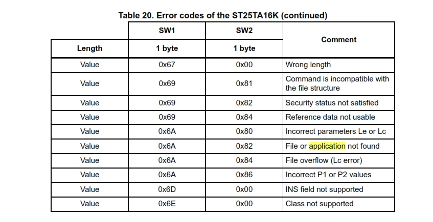

file or application not found mean ??

    ​Hello,
    First of all, thanks for your interest in ST25TA16K product !
    Then, In the NFC Forum Type 4 standard, you have to apply a "select file" or a "select application" command before any read or write command. If you get the error code corresponding to "file or application not found" this means :
    1)  you do not have sent this kind of command
    or
    2) the reference of the file or application you have tried to select is wrong.
    I hope this answer your question,

    How i can assure the reference of the file is correct.....

    ​Hello,
    The file identifiers are contained in the DS chapter 3.1.1
