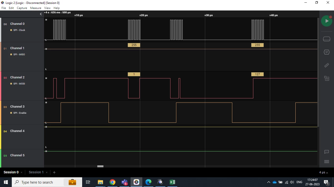

I have checked the error code Its returning ERR_HW_MISMATCH error. I have connected the nucleo board to a custom hardware of renesas micorocontroller and connected via jumper wires for SPI lines and IRQ. Also I'm not able to receive any irq signal.
Also the code is getting exit after coming on EXIT_ON_ERR( error, rfalInitialize() );
Code comes till st25r3916CheckChipID function but then directly returns out of the function.Screenshot (213).png

Brian TIDAL
Jun 27, 2023 11:07 AM UTC
if D1 is the MISO signal, then it seems to be always up...
if D3 is CS signal, then it seems to return high too early...
Make sure to enlarge the column with the signal name so that we can easily find each signal.
Check your SPI configuration and connection. Make sure also to power the device on the nucleo board. In Salae, make sure to configure the SPI decoder with CPOL=0 and CPHA=1 (this should as well be the SPI configuration inside your MCU).

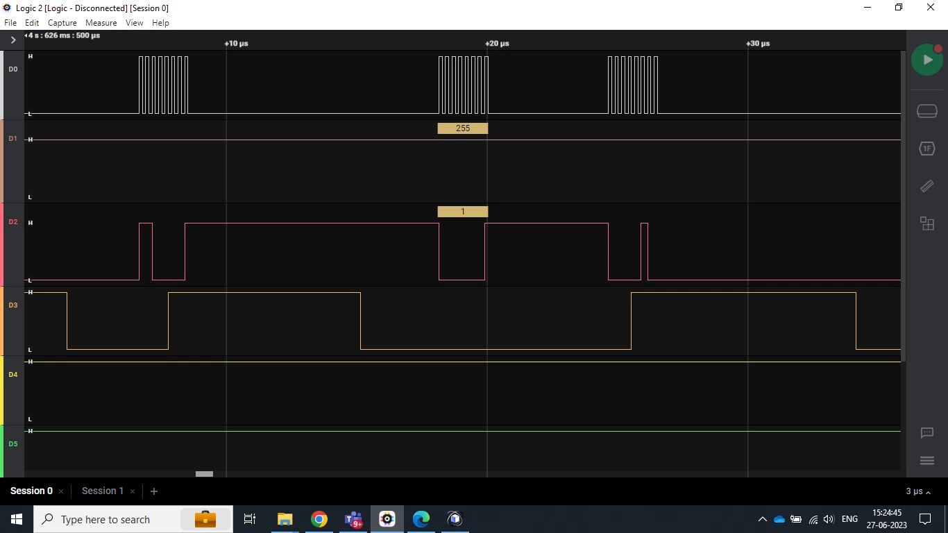

cGosa.1
cGosa.1Author
Senior
Jun 27, 2023 11:57 AM UTC
As mentioned the configuration is made in SPI and in logic analyzer, this is the picture with signal names
Ulysses HERNIOSUS
Jun 27, 2023 12:51 PM UTC
the driving of CS is obviously incorrect as already hinted by Brian. The chip gets deselected in the middle of a byte. Likely the SPI driver of Renesas returns before having completely finished the transmission. Then the software generated CS going to deselect is too early.
Just record the checkChipID(), it should have something like 0x7f on MOSI followed by the device ID on MISO.
Regards, Ulysses

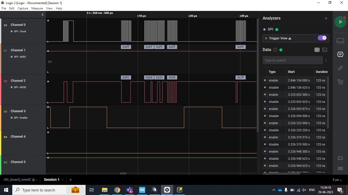

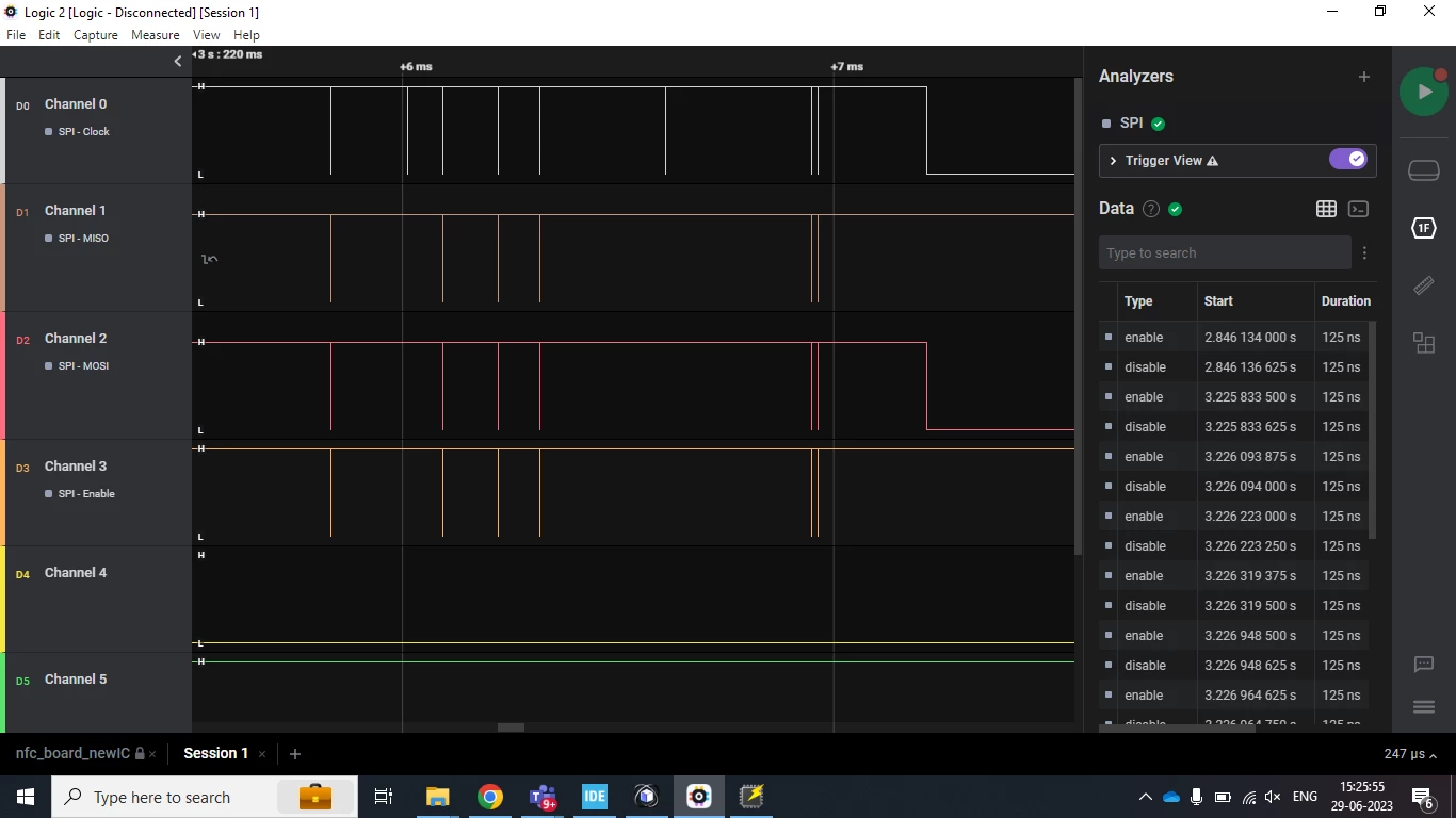

So currently as per the SPI configuration ,Screenshot (219).pngScreenshot (220).png
This is the logic analyzer trace
Ulysses HERNIOSUS
Jun 29, 2023 10:58 AM UTC
the shots don't show the complete 0x7f frame ( both bytes until SPI-Enable going high again).
Please also share the trace file as well.
Ulysses

Jun 29, 2023 11:43 AM UTC
HI,
Please find logic analyzer file: nfc_ssb29-6_1.sal, Nfc_29_6_2.sal
