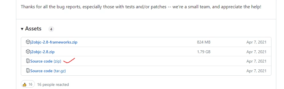

1. Downloaded IOS NFC tap source code(STSW-ST25IOS001)
2.Downloaded Source code from https://github.com/google/j2objc/releases
3. Build using command $make dist . It took some time and created dist folder with lib,frameworks,include

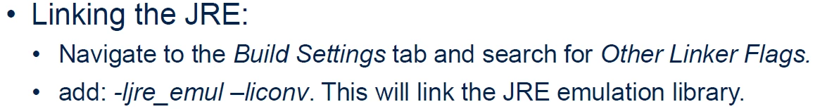

4.Linking JRE also done.

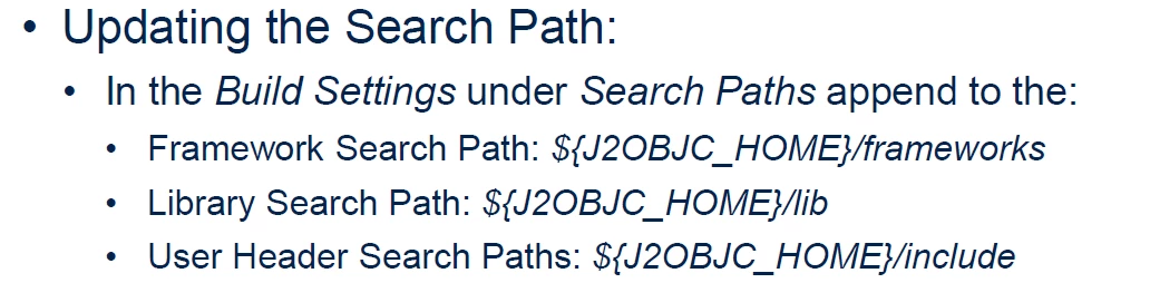

5. Updated search paths with dist folder.

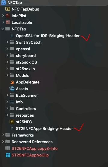

6. There are 2 bridging headers. In which file we need to import header files?
7. Do we need to download any module and link like below?
Thanks,

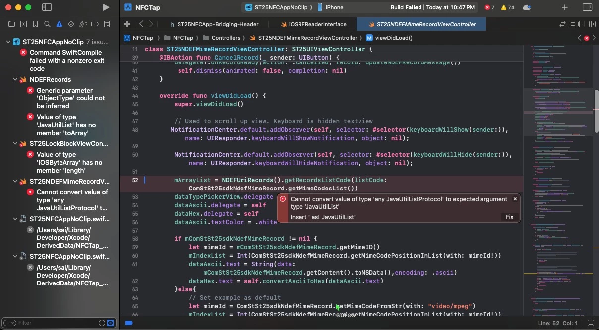

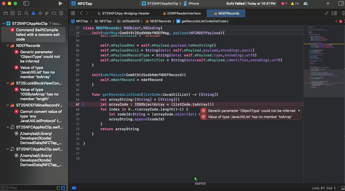

Hi Victor,

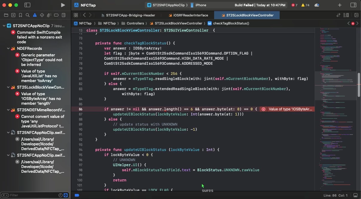

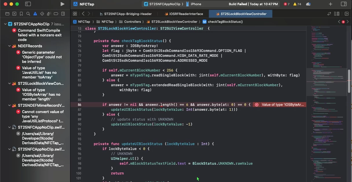

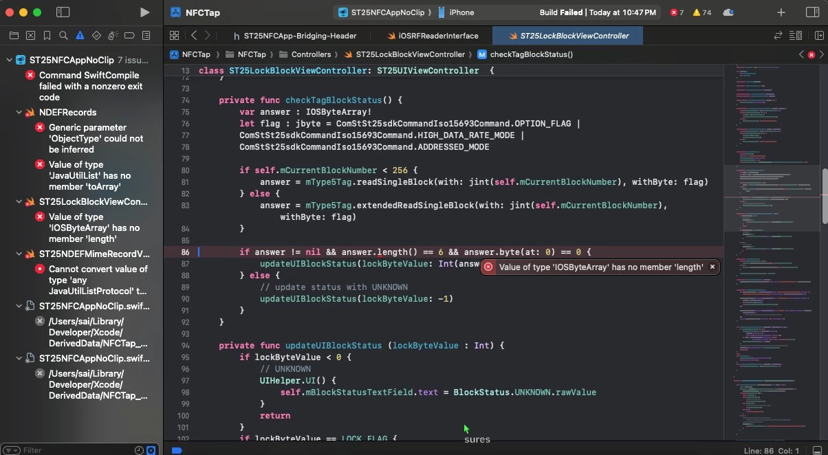

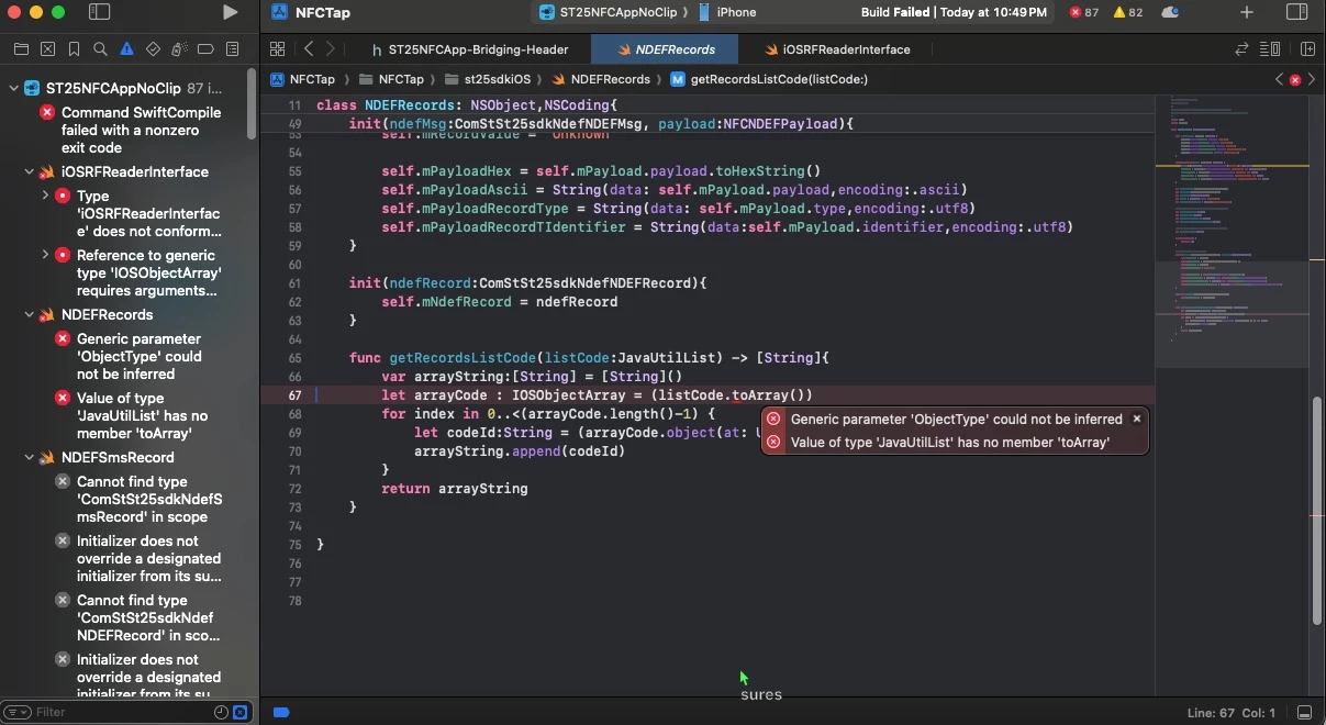

Now i am getting below code errors.
Any solution for this?

victor laraison
June 3, 2024
Hi Suresh,
At least we're making a little progress...
I guess issues are coming from the latest version of J2OBC used. I delivered iOS NFC Tap with J2OBJC V2.4.
What is your version ?
Thx and br,
SVemp.1
SVemp.1Author
June 3, 2024
Hi Victor,
I have used 2.8 release. Let me check with 2.4 version and come back to you.
Thanks for the reply.

victor laraison
June 5, 2024
hi suresh,
any update regarding version of J2OBJC ?
thx and br,
SVemp.1
SVemp.1AuthorBest answer
June 5, 2024
Hi Victor,
Sorry for late reply, Just wanted to make sure everything is working fine. We can close this thread as it working fine.
Changing to version 2.4 from 2.8 is resolved the compile issue.
Just wanted to iterate all the steps for people new to IOS.
1. Downloaded IOS NFC tap source code(STSW-ST25IOS001) (Version 7.4.0 )
2.Check compatible version of J2OJBC version(2.4 is compatible for 7.4.0)
3. Goto downloaded folder and Build using command $make dist . It took some time and created dist folder with lib,frameworks,include
4.Linking JRE also done. Make sure there no inverted colons in path i.e "ljre_emul liconv". Path should look like below.
Example: Home path should be   => J2objFolder/dist/
6. Update Bundle path. Updating bundle path may remove all above settings. So recheck again.
7. Update header file in bridge.
Compile the code.
