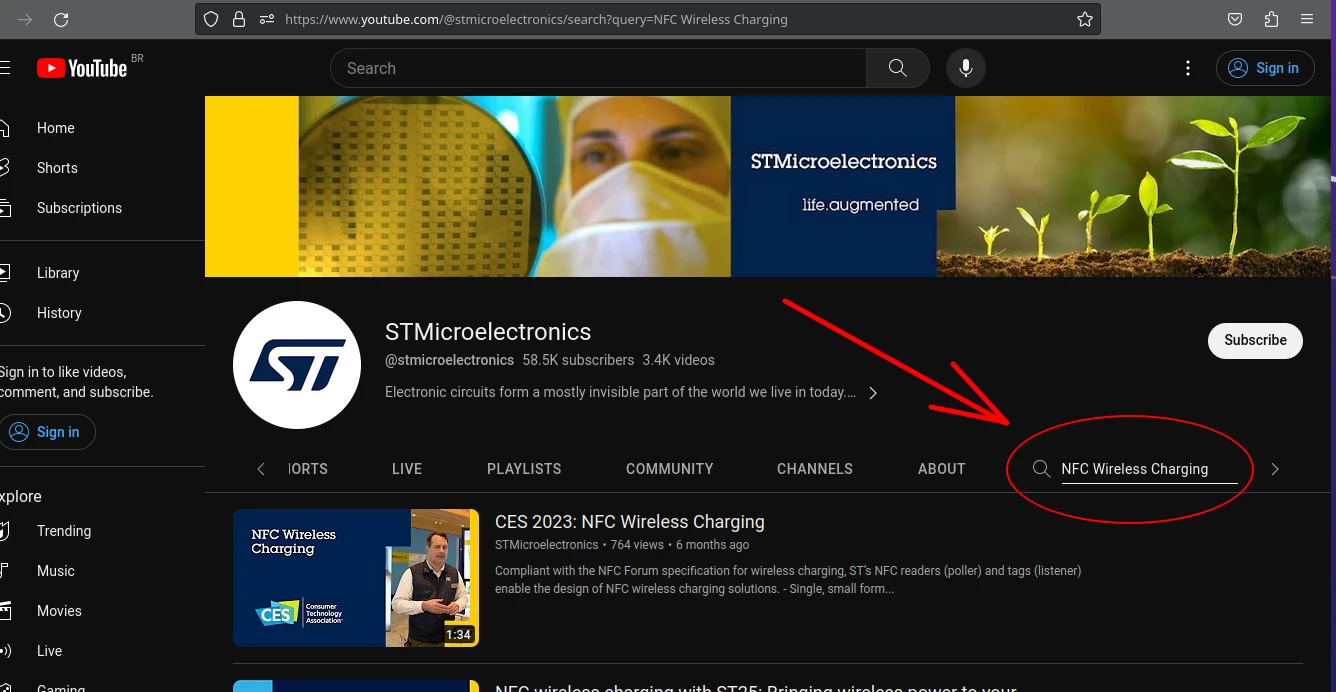

Hi @RhSilicon
I watched the video and learned what NFC WLC can do. As for the listener, I noticed that its L4 power supply is without power supply, and it uses battery charging to reach up to 1W energy. May I ask how to achieve this? Do you have any relevant introduction?

RhSilicon
Lead
August 19, 2023
Maybe few people have these answers, due to being recent technologies, but I found a forum that maybe can help to find more answers:
Wireless charging makes everything in our lives more convenient. First announced in 2021, the new NFC Forum Wireless Charging Specification will unlock this potential in all of our mobile accessories.
With hundreds of millions of NFC-enabled devices in the market today, NFC technology is one of the most versatile and secure technologies around. The NFC Forum and our members regularly make news with innovative products, new specifications, and life-enhancing case studies.
https://nfc-forum.org
