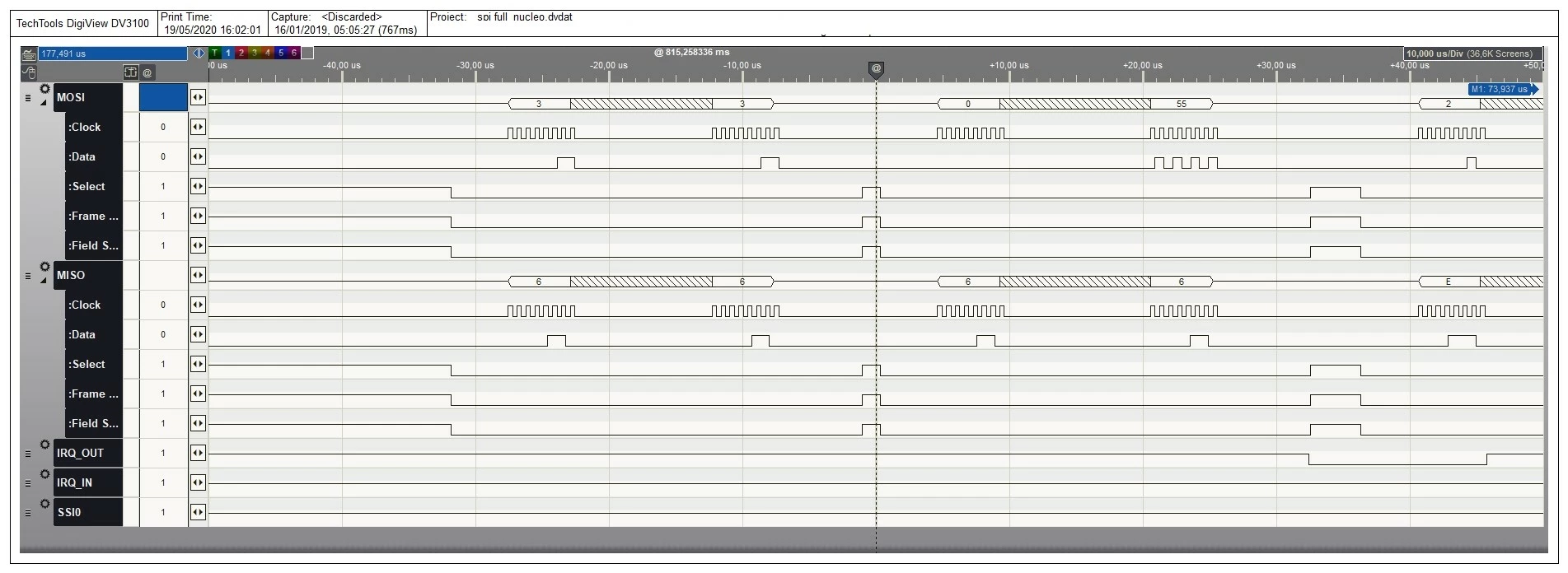

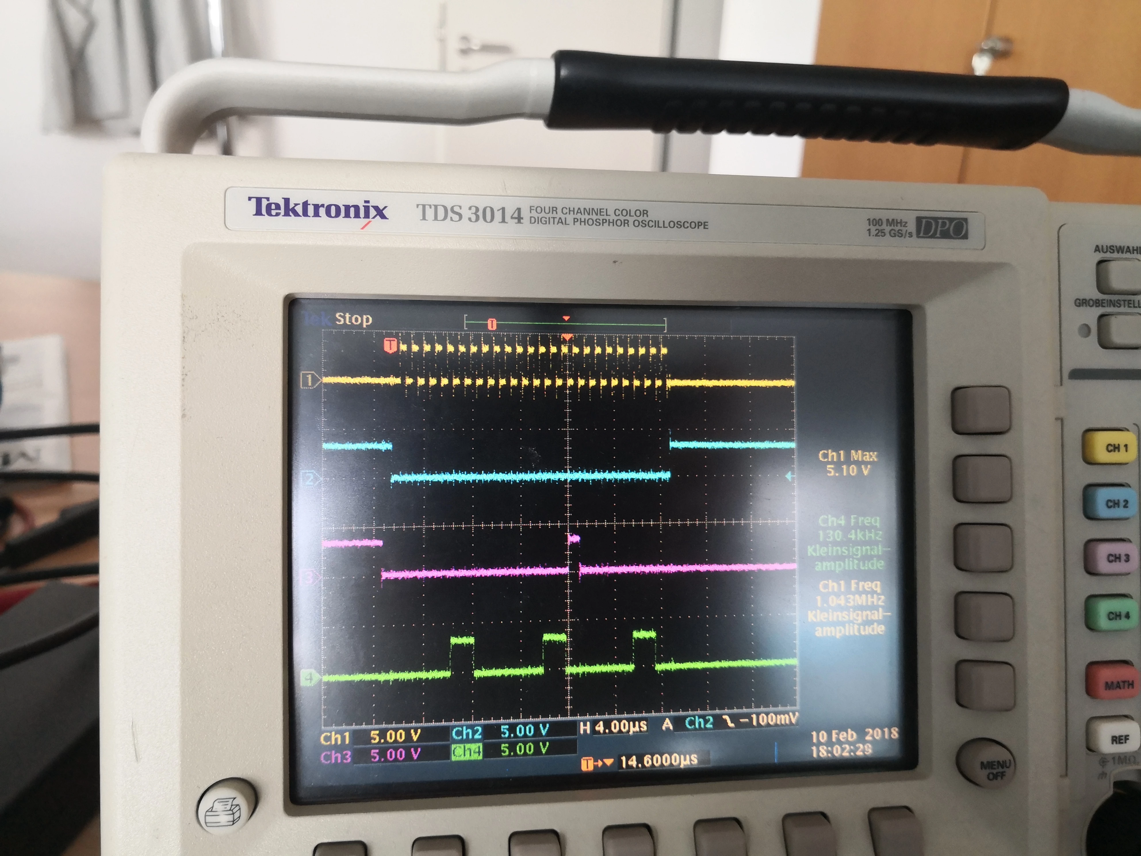

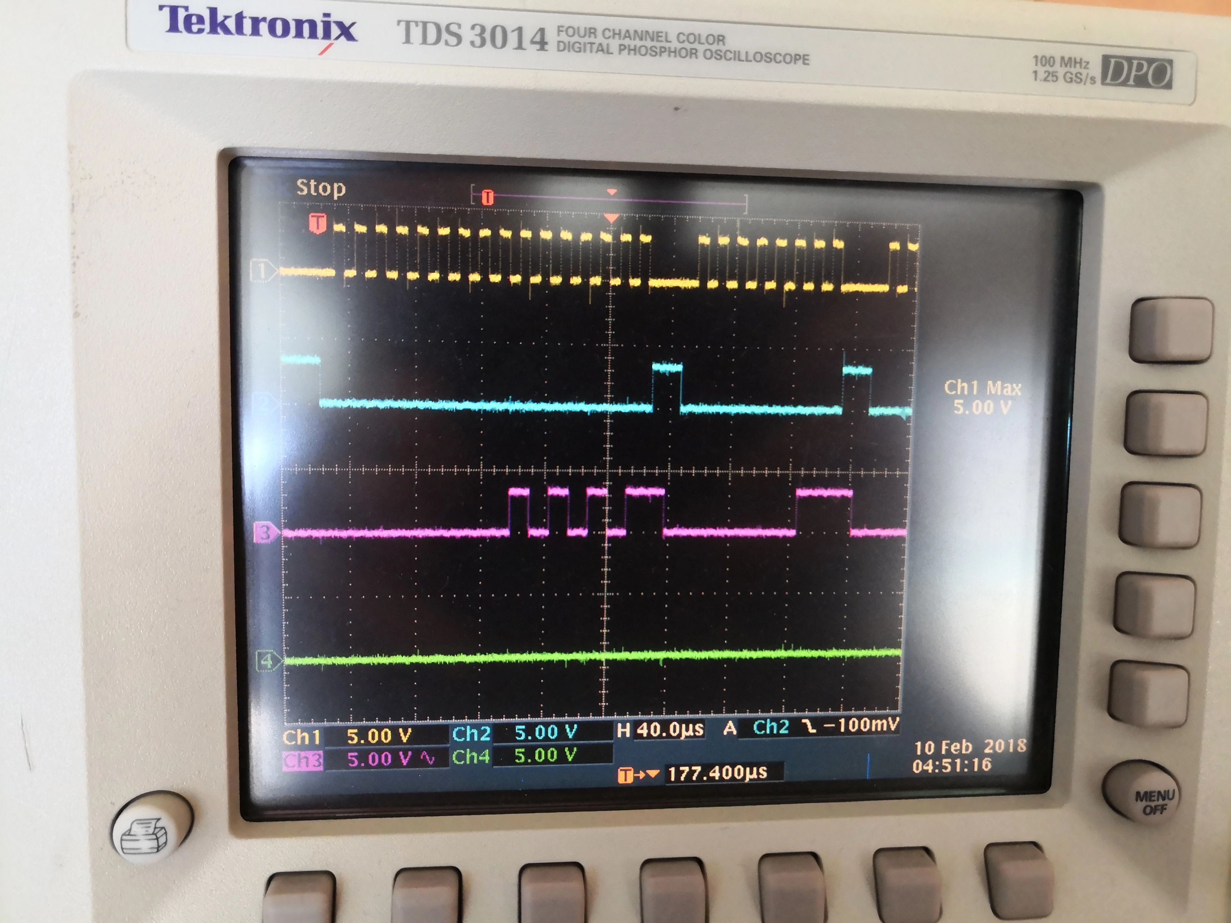

For better understanding I add a picture of the SPI Communication.
In the Picture:
yellow: SPI_CLK
blue: CS
red: MOSI
green: MISO
Can someone help me why the Chip is not responding?

    It is possible as well to poll for readiness by sending a poll control byte (0x03) after the startup sequence, If bit2 of the response byte is 1, the CR95HF is ready to receive commands. When sending the poll control byte to poll for readiness after startup, the usual response is 0x06. See attached screenshot from a logic analyzer with initial poll and then echo command.
    Regarding the pull up resistors, I had a look on the X-NUCLEO-NFC03A1 schematics (see UM1799), and I've not seen any pull up on the SPI_CS signal.
    Rgds
    BT
