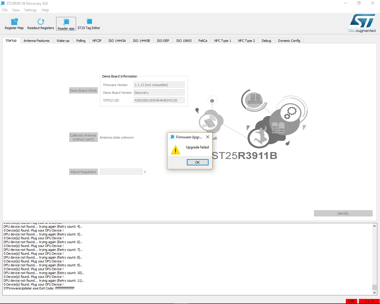

    1) but if windows sees the "ST25R3911B-DISCO" as a generic device I cannot use it as a com port so it is not possible to program it right?

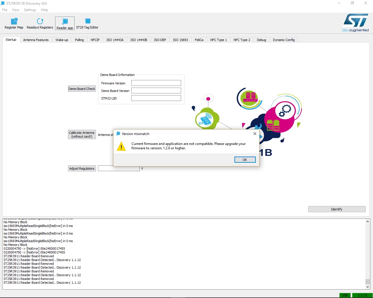

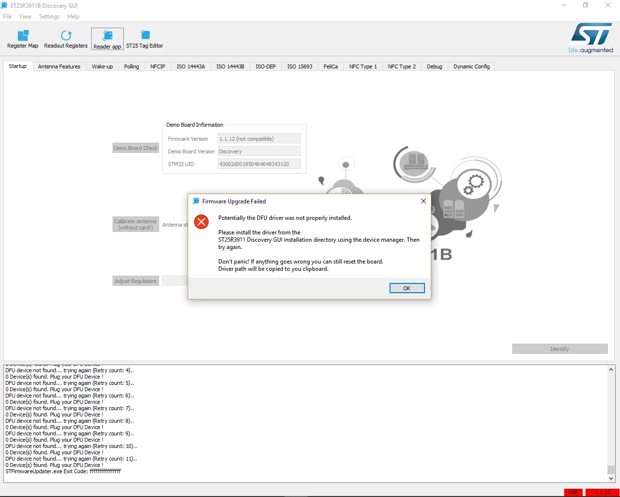

    2) I tried to use the "ST25R3911B Discovery GUI" program but it says to update the firmware but following the procedure it generates these errors shown in the images

    Hi Francesco,
    The ST25R3911B-DISCO cannot be debugged without external debugger. It does not have an on-board ST-Link. You will need to attach an external debugger to the Cortex-M 9-pin debug interface.
    Firmware update on the ST25R3911B-DISCO works through the USB DFU bootloader inside STM32L476. If that is not working then you may be hit by new driver coming with STM32CubeProgrammer. You can resolve by:
    1.      Go to device manager, search “Universal Serial Bus devices -> STM32 Bootloader�? (winusb.sys in the driver details)
    2.      Uninstall with “Delete the driver software for this device�? checked (!)
    3.      Reset the board, keeping USB DFU mode: e.g. press boot button while resetting
    4.      Go to device manager, search “Other devices -> STM32 BOOTLOADER�? (no driver installed)
    5.       “Update driver software�?, select e.g. C:\PROGRAM FILES (X86)\STMICROELECTRONICS\ST25R3916_DISCOVERY_GUI\DRIVER\DFUSE
    6.      Now there should be an “Universal Serial Bus controllers -> STM Device in DFU mode�? (STTub30.sys in the driver details) in the device manager and firmware update should work.
