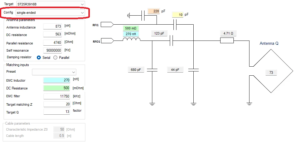

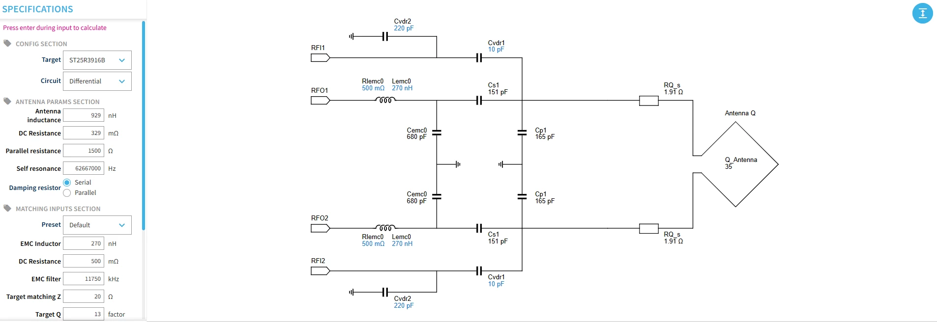

4.) I would recommend to follow the design process in AN5276. In the AMT (Antenna matching tool) you then can simply select "single ended antenna":
There is also an Online version of the tool available: https://eds.st.com/nfc-tuningcircuit/
Please let us know, if you have additional questions.
