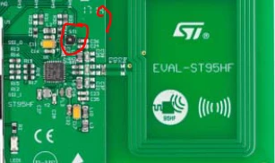

Demodulator output -EVAL ST95HF
Posted on May 25, 2018 at 17:54
I am using  EVAL-ST95HF board and would want to see the demodulated signal using the oscilloscope. There's a Test Point-ST1 on board. Is that the de-modulator output pin?
I have attached an image for your reference.

    Hi Preetha,
    No, there are no way to get the demolutator output on the boards.
    BR
    PB

    Hello Prethaa,
    Unfortunately this IO is not the demodulator output and their are no pins that reflect in functional the internal signal.
    Regards
    PB

    Hi Peter,
    Thanks for your reply. Is there any method to check the demodulator output (using software)?
    Thanks,
    Preetha

    Hi Preetha,
    BR
    PB
