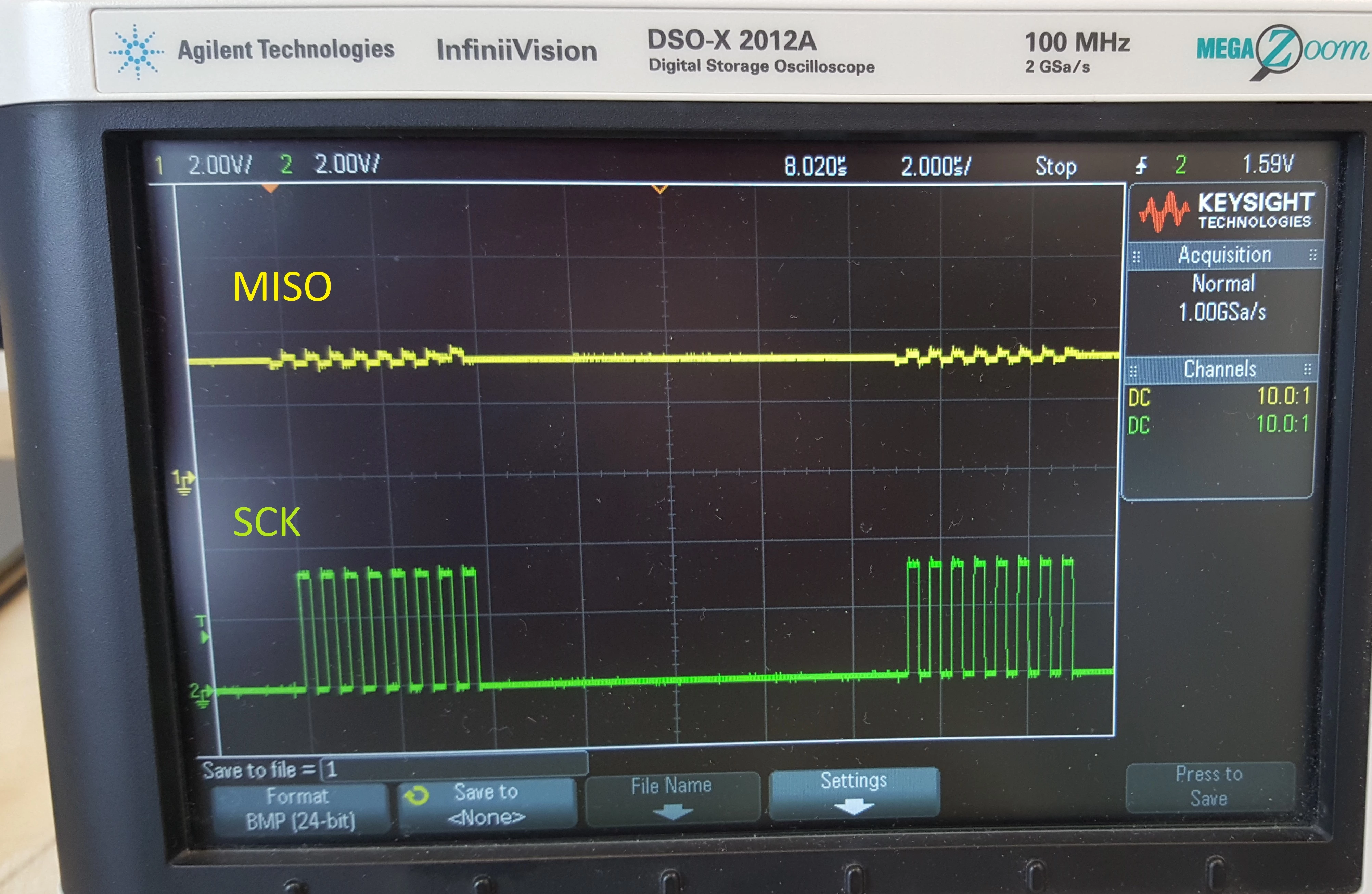

0693W000008GePeQAK.jpgHi,
I am using the X-NUCLEO-NFC03A1 board with an Atmega328p MCU and atmel studio.
I have been trying to communicate with the CR95HF via SPI but I cant seem to get any reply on the MISO line. The MISO line never drops below a certain voltage level (around 100mV).
Any idea what might be causing this? I checked that the SCK, MOSI and CS signals all have good integrity on the CR95HF chip. I have attached a picture of the SCK and MISO signals.
Thanks in advance for your help

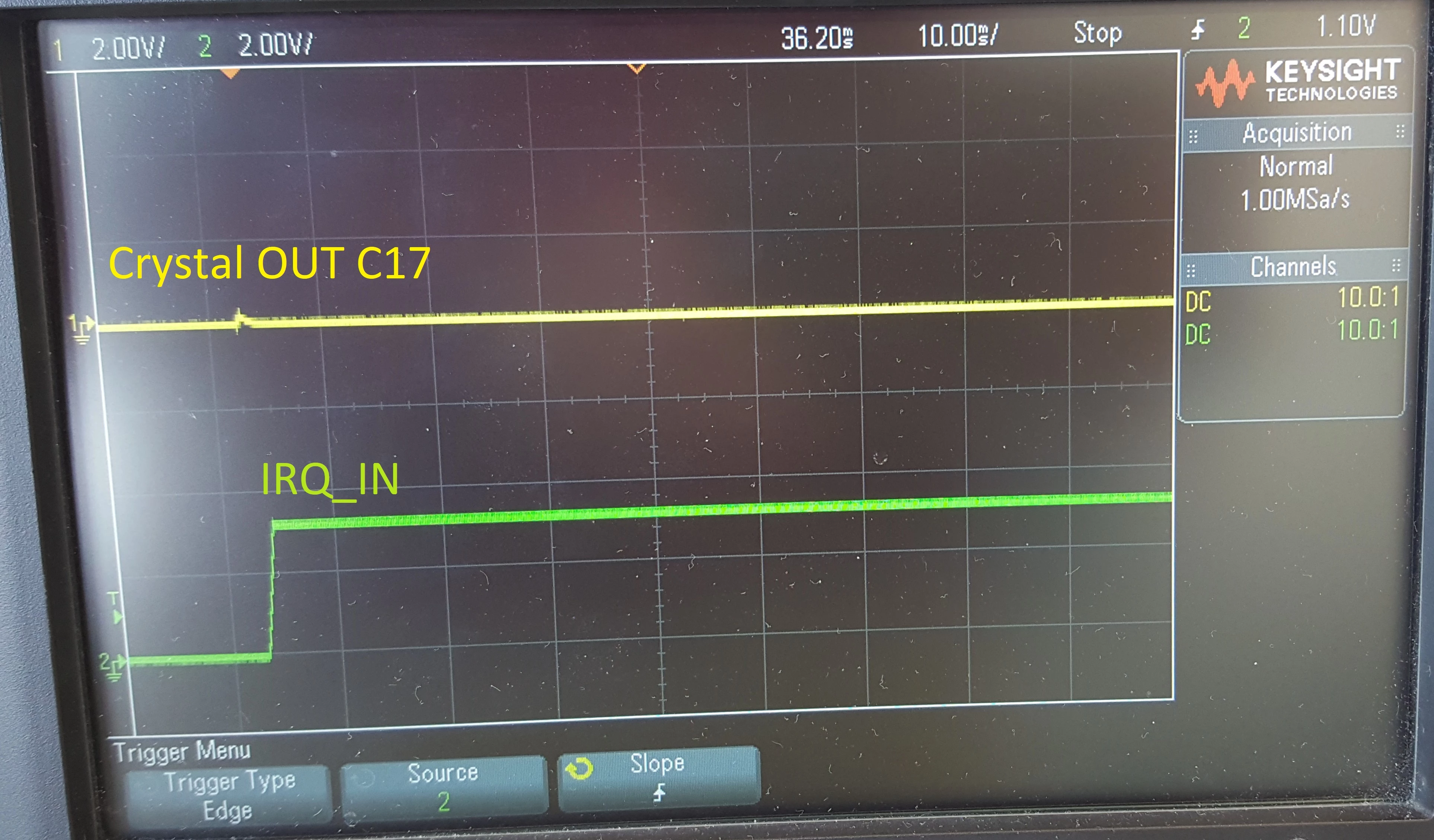

    on your scope screenshot, I see only nIRQ_IN rising once from 0 to 3V3. Can you confirm that you follow the startup sequence as described in ST25R95 datasheet §3.2
    • after the initial t0 delay after power on, there must be an initial interrupt for the interface selection (t1 duration) i.e nIRQ_IN going from 3V3 to 0
    • then after t1, rising nIRQ_IN will cause the oscillator to start
    Can you provide a screenshot of the full startup sequence from power on to t3?
    If this startup sequence is properly followed and the X-NUCLEO-NFC03A1 still not replying, can you plug this board on a NUCLEO-L476RG, NUCLEO-F401RE or NUCLEOF103RB board and run the firmware from X-CUBE-NFC3 (binary are provided). This will help to verify that the X-NUCLEO-NFC03A1 has not been damaged.
    How is powered the X-NUCLEO-NFC03A1? External power supply?
    Can you provide the interconnection between your MCU mother board and the X-NUCLEO-NFC03A1 daughter board? make sure to follow UM2479 table 1 and table 2 for the interconnection?

    can you probe the IRQ_IN during the startup sequence (see ST25R95 datasheet §3.2) and share the startup sequence with me.
    I would also suggest to check that after the completion of the startup sequence:
    • the 27.12 MHz cristal is properly clocking the device (just probe and one should see something similar to figure 3 from AN3433)
    • the nIRQ_OUT is high (i recommand to use IRQ_OUT during SPI communication)
    How is the MISO connected to the X-NUCLEO-NFC03A1: is there any pull up resistor on MCU PCB side? Can you disconnect the MISO on MCU side and probe the MISO on X-NUCLEO-NFC03A1 side (i.e. with MISO being left floating)?
    Rgds
    BT

    Please see the attached image, it seems that there is no output form the crystal. I measured the signal on XIN and XOUT pins individually with no resultant clock.
    I disconnected the MISO from the MCU and the result was the same as seen in the previous image.
    Any suggestions?
    Regards,
    SMahm.2

    I followed the startup sequence you indicated and its working now, thanks.
