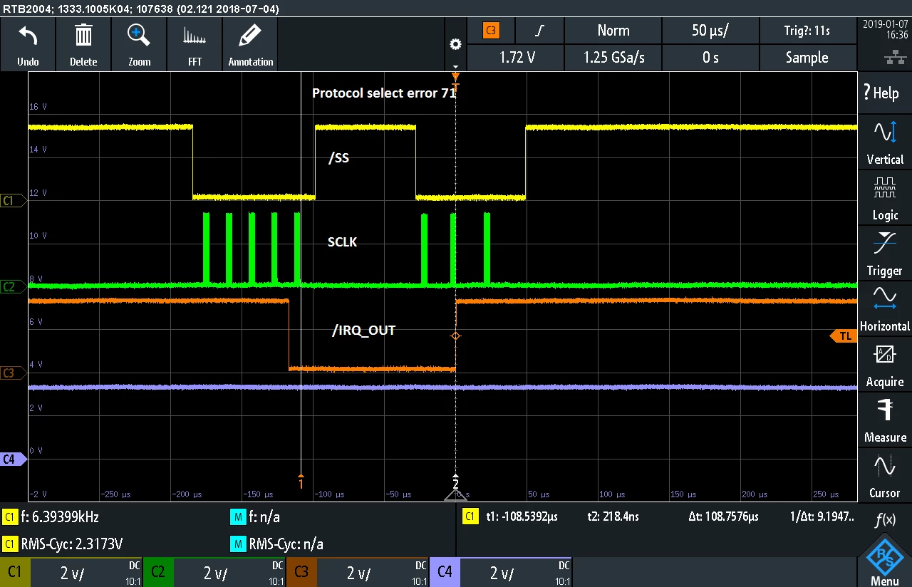

I have a CR95HF transceiver connected over SPI interface running at 2MHz. When I send the protocol select command I get the error 0x71 (EinternalError) .
The IRQ_OUT goes after the 4-th byte low .
Clock, MISO, MOSI looks ok.
Send data 00 02 02 01 0d
Get data 0E 71 00
What means this error?

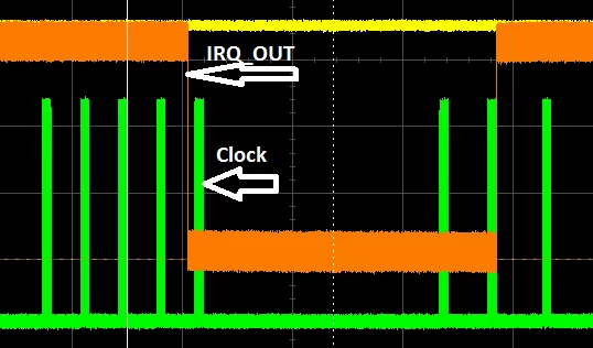

    Hi Gaby
    In your first screen capture, the IRQ_OUT goes low before the end of the frame whereas it should goes low after the reception of the full frame. So it seems there is a transmission error on the first bytes and the CR95HF reacts immediately and send an error response.

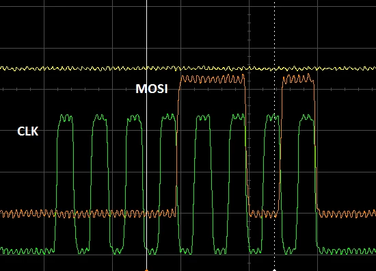

    Would you please make sure that your SPI clock frequency is not exceeding CR95HF max value (2.0 MHz).? On my side, I use a lower SPI clock frequency (~1.5 MHz) with an X-NUCLEO-NFC03A1 expansion board and I do not face communication issue. Would you please try a lower frequency than the 2.0MHz limit (e.g. 1.5 MHz) ?
    Also, make sure
    • to use either CPOL=0/CPHA=1 or CPOL=1/CPHA=1.
    • to follow SPI characteristics from CR95HF Datasheet table 33 (in particular tSU(NSS))
    • to wait for the completion of the startup sequence in particular to wait for t3 expiry before sending the first command

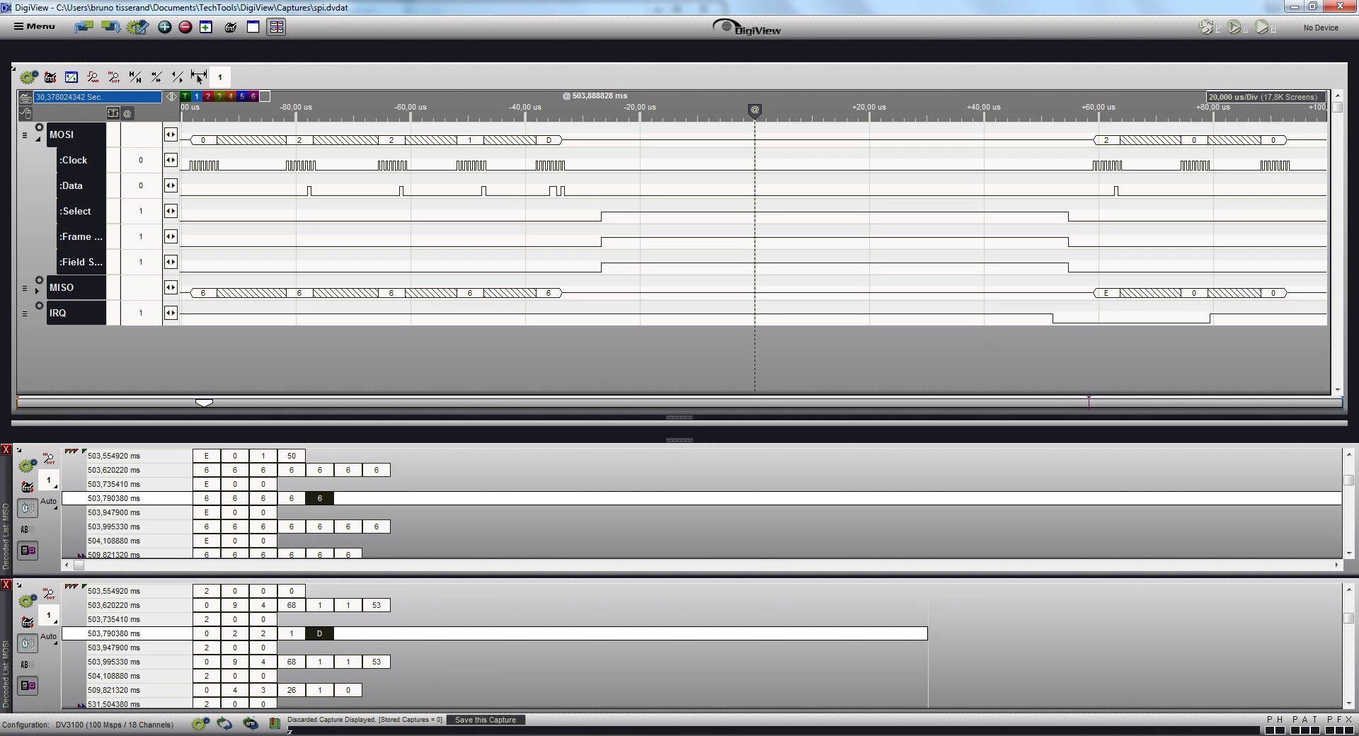

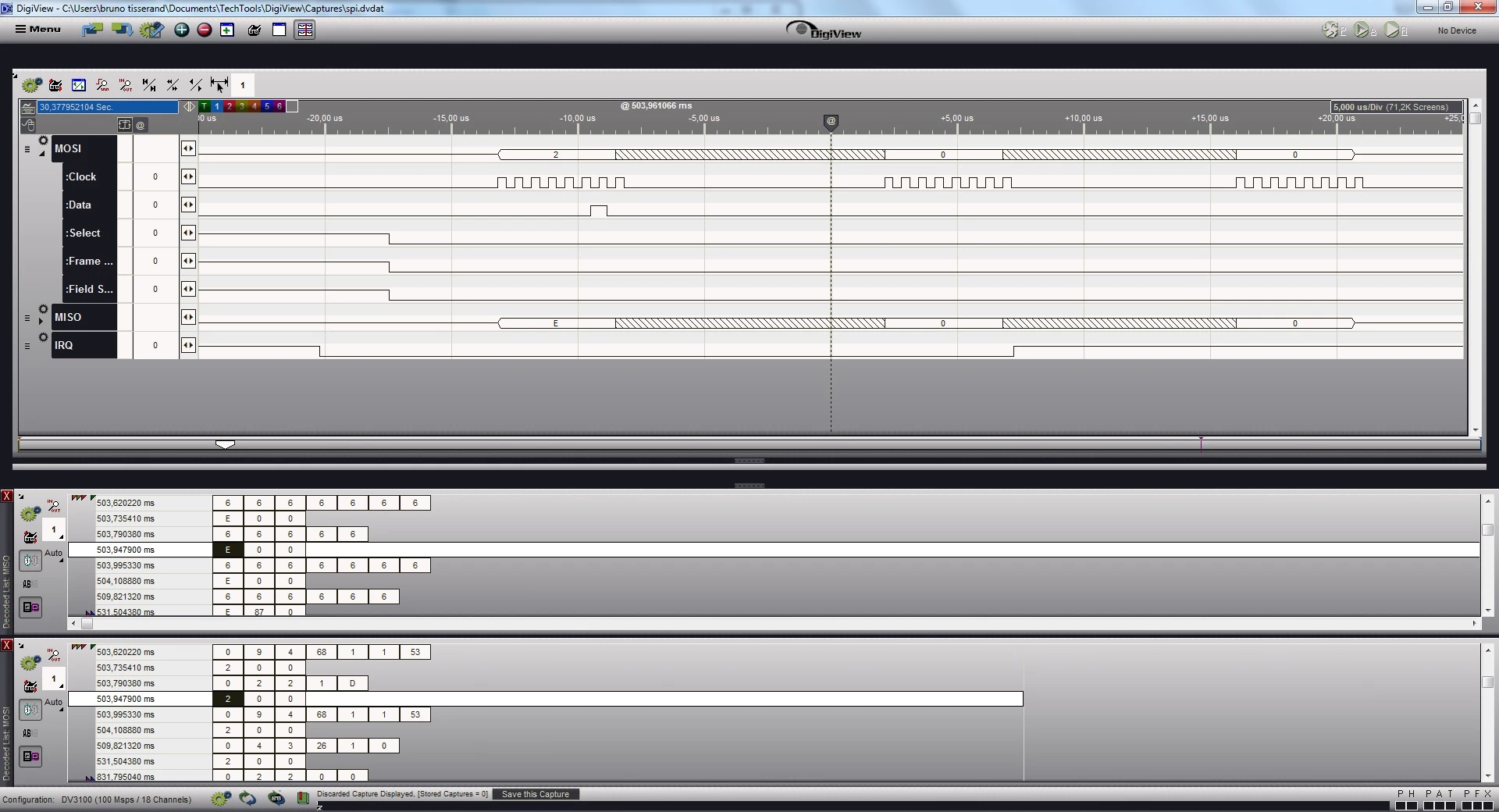

    Once the SPI is initialized and the startup sequence is completed, the echo command (0x55) can be used to check the communication interface.
    Here is an example of SPI comminication:
    >>> (0x00) 0x0202010D (Protocol Select)
    <<< (0x0E) 0x0000 (Result Code reply)

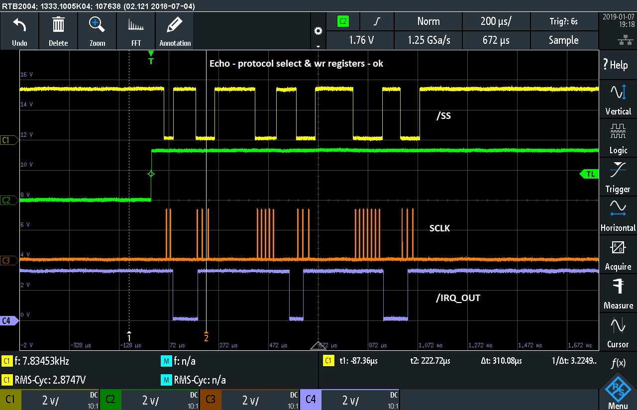

    I changed the start sequence:
       /IRQ_IN pulse
       delay
       echo command
       get echo answer
       select protocol command
       get answer
       write registers command
       get answer
    In this way it works.
    Attached some fotos, maybe it will be help somebody else :)
