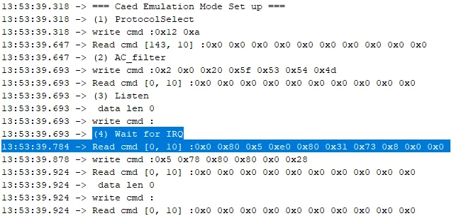

    Hi
    this is a great achievement:
    0x00, 0x80, 0x05, 0xe0, 0x80, 0x31, 0x73, 0x08, 0x00, 0x00 is basically the E0 80 RATS frame (Request for Answer To Select) that is sent by the Android Phone after the anti collision and the activation. This means the anti collision (AC Filter) is properly working and the Android Phone is now trying to move to ISO14443-4 layer (aka ISO-DEP) with the RATS command. I see that you send the ATS answer (05 78 80 80 00), then make sure to then send the Listen command to trigger the reception of the next command. Note that the logging of the various exchanges may have an impact on the real time: for example the phone is waiting for the ATS within a certain timeout, if the logging through UART is delaying too much the sending of the ATS, the waiting time on phone side may elapse and this can cause a communication failure.
    Rgds
    BT

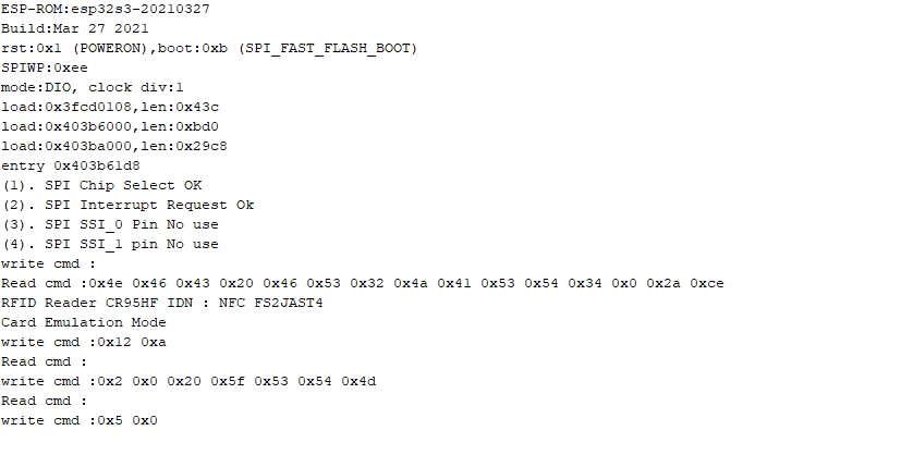

    ​ 4. Read Chip ID (CR95HF)
    1) slave(CS) pin Low -> SPI Setting(); ->SPI transfer() packet Tx : 0x00(control byte), 0x01 (IDN cmd), 0x00(len)
    -> slave Pin High -> SPI.endTransaction
    ※Tx packet : 0x00, 0x51, 0x00
    2) slave(CS) pin Low -> SPI Setting(); -> packet Tx : 0x03(control byte), 0x00
    -> slave Pin High -> SPI.endTransaction -> for( i=0; i<data; i++) save[i] = SPI transfer(); packet Tx : 0x03,
    0x00
    ※Tx packet : 0x03, 0x00 after -> if (SPI transfer & 0x08) -> slave(CS) pin Low -> SPI Setting(); -> packet
    Tx : 0x02(control byte), 0x00 -> for(i=0; i<data; i++) rdata[i]=SPI transfer(); -> slave Pin High
    ※Tx packet : 0x02, 0x00
    ※Rx packet(rdata[]) : 0x4e 0x46 0x43 0x20 0x46 0x53 0x32 0x4a 0x41 0x53 0x54 0x34 0x0 0x2a 0xce
    result : RFID Reader CR95HF IDN : NFC FS2JAST4

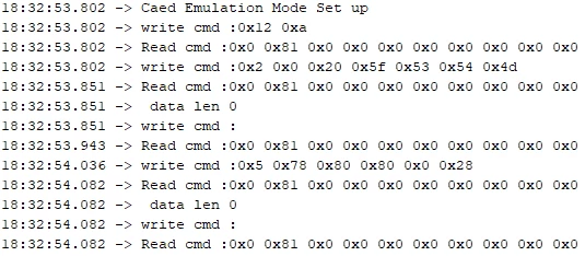

    Tx packet : 0x00 (controlbyte), 0x02(protocol select cmd), 0x02(len), 0x12, 0x08
    rx packet : 0x00 should be returned if read normally, but no actual value is returned
    2) AC filter
    Tx packet : 0x00( controlbyte), 0x0D(AC_filter cmd), 0x07(len), 0x02, 0x00, 0x20, 0x5F(UID), .0x53(UID),
    0x54(UID), 0x4D(UID)
    Rx packet : 0x00 should be returned if read normally, but no actual value is returned
    3) Listen : I wrote a write code, but this part is not written :sad_but_relieved_face:
    Tx packet : 0x00(controlbyte), 0x05 (listen cmd), 0x00 (len)
    Rx :0x00 should be returned if read normally, but no actual value is returned
    4) Tag Send
    Tx packet :0x00(control byte), 0x06, 0x06, 0x05, 0x78, 0x80, 0x80, 0x00, 0x28
    Rx : 0x00 should be returned if read normally, but no actual value is returned
    I've written it up to here

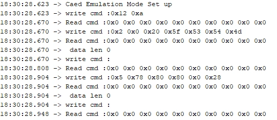

    0
    0693W00000QNwC0QAL.png​
    ​Since there is no logic analyzer, we replaced it with a terminal window provided by Arduino Integrated Development Environment
    card emulation code : help me plz :sad_but_relieved_face:

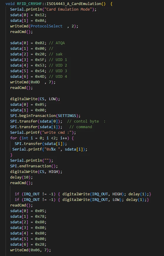

    void card_Emulation_14443A(void)
     Serial.println("Caed Emulation Mode Set up");
     sdata[0] = 0x12;
     sdata[1] = 0x08;
     writeCmd(ProtocolSelect, 2); // Card Emulation Mode Tag type select 14443A
     readCmd();
     sdata[0] = 0x02; //ATQA
     sdata[1] = 0x00;
     sdata[2] = 0x20; // sak
     sdata[3] = 0x5F; // User Tag UID
     sdata[4] = 0x53; // User Tag UID
     sdata[5] = 0x54; // User Tag UID
     sdata[6] = 0x4D; // User Tag UID
     writeCmd(AC_filter ,7);
     readCmd();
     writeCmd(Listen ,0);
     readCmd();
     while(!EchoResponse()) {
      if (IRQ_IN != -1) { digitalWrite(IRQ_IN, HIGH); delay(10);}
      if (IRQ_IN != -1) { digitalWrite(IRQ_IN, LOW); delay(10);}
      readCmd();
     sdata[0] = 0x05;
     sdata[1] = 0x78;
     sdata[2] = 0x80;
     sdata[3] = 0x80;
     sdata[4] = 0x00;
     sdata[5] = 0x28;
     writeCmd(Tag_Send ,6);
     readCmd();
     readCmd();
    DJeon.4

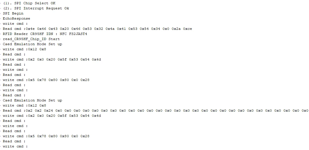

    Brian TIDAL
    Aug 22, 2022 3:28 PM UTC
    make sure to follow the SPI communication protocol as described in §4.1 of the ST25R95 datasheet. In particular, before reading the response to a command, "the application software needs to wait for the ST25R95 to be ready to send the response. Not following this procedure may cause unpredictable behavior". This can be done by:
    • Polling the ST25R95 until it is ready (0x03 poll control byte)
    • waiting for IRQ_OUT: this is what I usually recommend (very simple to use)
    So, after sending "0x00 0x02 0x02 0x12 0x0A" (CE mode ProtocolSelect), make sure to poll the ST25R95 or to wait for the IRQ_OUT before reading the response to the command.
    The  RFID_CR95HF::readCmd() looks erroneous:

    DJeon.4
    DJeon.4Author
    Sep 1, 2022 8:59 AM UTC
    Hello.
    Brian TIDAL
    We proceeded according to the sequence you told us but failed to implement the card emulation mode.
    Please check if the cmd I entered is correct.
    1. spi setting
    2. cr95hf wake up ( echo Response)
    • irq_in : high , irq_out : high , ss:low set

    ​Brian TIDAL's sequence changes from 4. to the mobile phone Tag reader mode and recognizes CR95HF, but it doesn't work. I'm not sure where it went wrong.
    ​Help me
    <​Before contacting the CR95HF in Samsung mobile NFC reader mode...>
    0693W00000SuHZWQA3.png<after...>
    <card emulation mode code>
     sdata[0] = 0x12;
     sdata[1] = 0x0A;
     delay(10);
     CardEmulate_readCmd();
     sdata[1] = 0x00;
     delay(10);
     delay(100);
     delay(100);
     sdata[0] = 0x05;
     sdata[1] = 0x78;
     sdata[2] = 0x80;
     sdata[3] = 0x80;
     sdata[4] = 0x00;
     sdata[5] = 0x28;
     delay(10);
     delay(10);

    Brian TIDAL
    Sep 1, 2022 9:41 AM UTC
    can you confirm that the protocolSelect (CE mode) command properly returns 0x00 0x00 and that AC Filter command also returns 0x00 0x00?
    Can you provide a LogicAnalyzer trace of SPI CLK/MOSI/MISO/SS + IRQ_OUT?
    Thanks

    DJeon.4
    DJeon.4Author
    Sep 2, 2022 6:11 AM UTC
    4. When the wait for IRQ recognizes the mobile phone, it returns the value as follows.
    Brian TIDAL
    Brian TIDALBest answer
    Sep 2, 2022 9:41 AM UTC
    Hi
    Rgds
    BT
