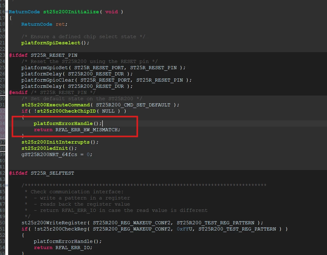

August 27, 2024
Thanks for your response Brian,
I'm using a custom board with ST25R100.
yes, I'm the X-CUBE-NFC9 expansion package.
The RESET PIN of ST25R100 is connected to ground. As shown in datasheet of ST25R100 chip.
Interrupt pin of the ST25R100 is properly configured as above.
but during debug time, code is stuck in  "platformErrorHandle();" function. I have attached a snippet bellow:
& also i have attached .ioc file here.

Hi Hitesh,
the SPI configuration is incorrect. See Datasheet §5.8.2 "The ST25R100 has a standard serial peripheral interface with clock polarity of 0, a clock phase of 1"
The proper configuration should be:
When reading the identity register 3Fh, the returned value has a wrong value. This causes st25r200CheckChipID() to return an error.
