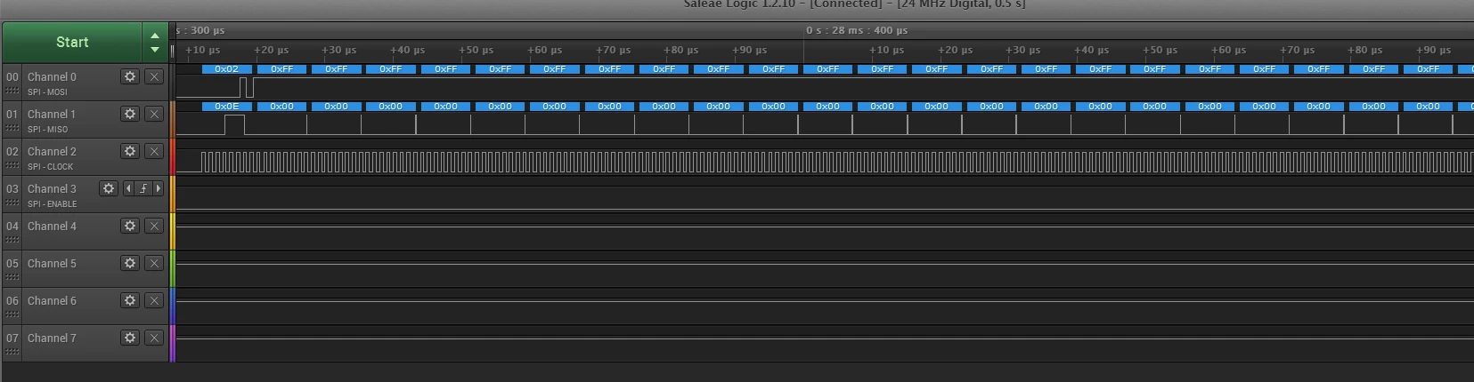

i try to use the nfc reader cr95hf (MIKROE-143) since a few days. as mcu i use the evaluation board nRF52832. unfortunately i don't succeed so far.

after step 1:
after step 2:
after step 3:
where does this strange response come from (0x0E 0x00 0x00 0x00 0x00 0x00 0x00 0x00.... 0x00 0x00 0x00 0x00)?
why do i get 0x0E so often?
i kept the startup routine. i checked this with an oscilloscope.
The tag is certainly not empty (checked with my smartphone).

    I beleive you setup is correct
    The SPI interface is working properly the issue come from the command you send ( uint8_t invcommand[5] = {0x00, 0x02, 0x02, 0x01,0x21};) which is not a known command for the CR95HF
    Assuming you are in ISO 15693 you need first to initiate your protocol using the protocol select command I suggest to modify as follow : uint8_t invcommand[4] = { 0x02, 0x02, 0x01,0x21};
    according to the specification https://www.st.com/resource/en/datasheet/cr95hf.pdf see sheet 20/21
    The SPI answer 0x0E means that the busy flag is off only the bit 3 is significant.
    I can also suggest to check your SPI interface using the echo command described in the datasheet.
    This command will work after reset whatever is the protocol.
