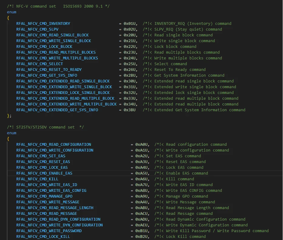

Why does this enum (in rfal_nfcv.h) do not contain the command code for some commands (eg:- Write AFI, Lock AFI etc )? I also do not see an api to do this -  If I need to write to AFI, Am I supposed to use directly api rfalNfcvPollerTransceiveReq() with 0x27h command code ?

AFI feature is optional in ISO15693 and not supported in NFC Forum technical specification. The support of Write/Lock AFI can be added in the RFAL:
In rfal_nfcv.h, add the following lines in the NFC-V command set  enum
 RFAL_NFCV_CMD_WRITE_AFI = 0x27U, /*!< Write AFI */
 RFAL_NFCV_CMD_LOCK_AFI = 0x28U, /*!< Lock AFI */
In rfal_nfcv.c, add the following functions
ReturnCode rfalNfcvPollerWriteAFI( uint8_t flags, const uint8_t* uid, uint8_t afi )
 uint16_t rcvLen;
 rfalNfcvGenericRes res;
 uint8_t data;
 /* Check for valid parameters */
 data = afi;
 return rfalNfcvPollerTransceiveReq( RFAL_NFCV_CMD_WRITE_AFI, flags, RFAL_NFCV_PARAM_SKIP, uid, &data, sizeof(uint8_t), (uint8_t*)&res, sizeof(rfalNfcvGenericRes), &rcvLen );
ReturnCode rfalNfcvPollerLockAFI( uint8_t flags, const uint8_t* uid )
 uint16_t rcvLen;
 return rfalNfcvPollerTransceiveReq( RFAL_NFCV_CMD_LOCK_BLOCK, flags, RFAL_NFCV_PARAM_SKIP, uid, NULL, 0, (uint8_t*)&res, sizeof(rfalNfcvGenericRes), &rcvLen );
Note that you may need to modify the rfalNfcvPollerInventory function if you want to send the AFI during the inventory.

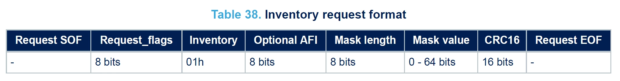

The AFI mentioned in the inventory request, Is this Tag's AFI ? What is the need of including AFI in the request ?

The Application Family Identifier (AFI) represents the type of application targeted by the device and is used to extract from all the tags present only the tags meeting the required application.
The ISO 15693 provides the tag decision tree for the AFI. If the inventory contains AFI value=0, all tags supporting the AFI feature reply else (inventory with AFI value different from 0) only tags matching the AFI value reply.
