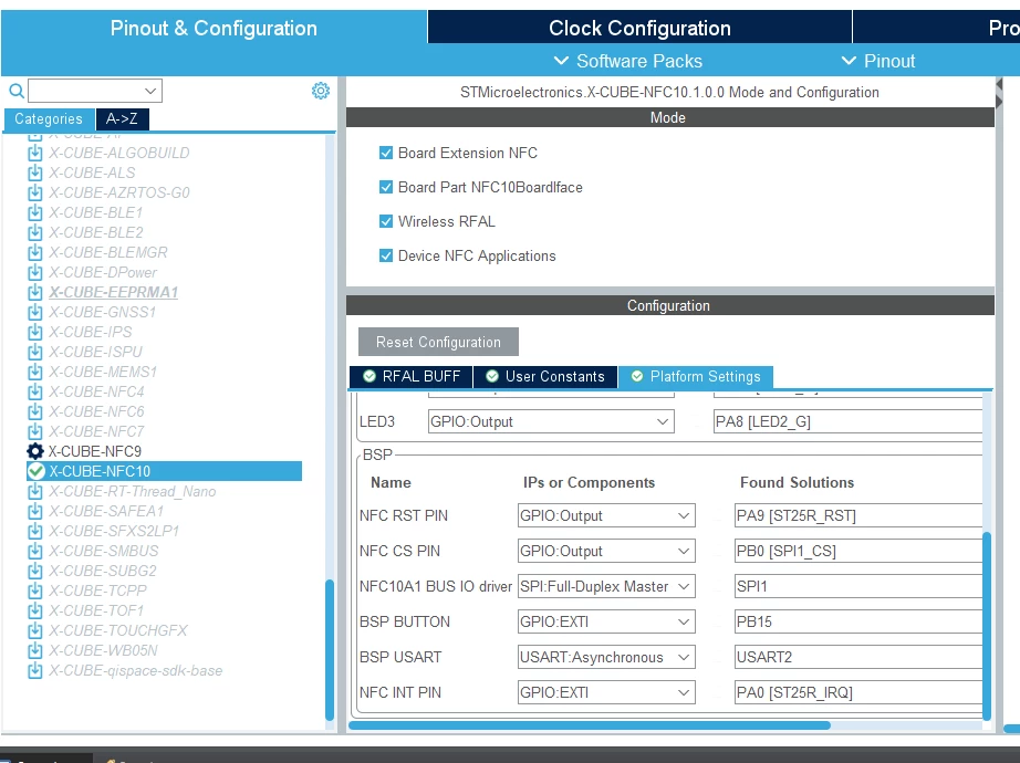

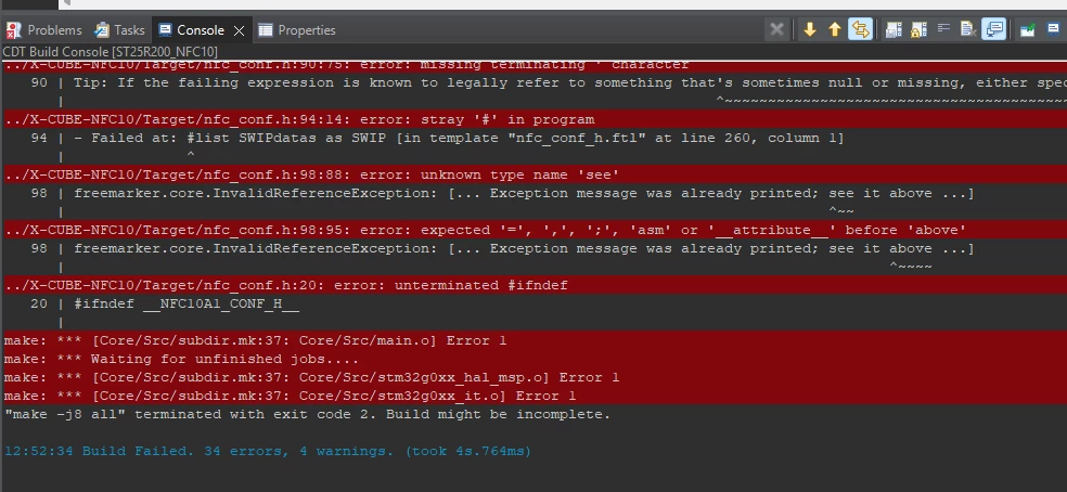

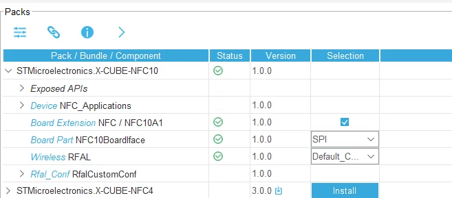

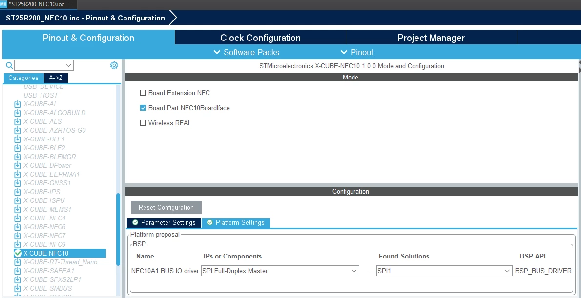

hi,
I tried using the X-CUBE-NFC10 package ,
but the package doesn’t build the project well,
This is my steps:
1-Configuration hardware I took from steval-25r200sa :
2- Configure the x-cube-nfc10
3- Enable the nfc 10 :
4- Generate code :
5- Build :
6- Adding nfc_conf.h , I copy into nfc_conf.txt:
this is my steps, what did i do wrong ?
best regards,
noam.

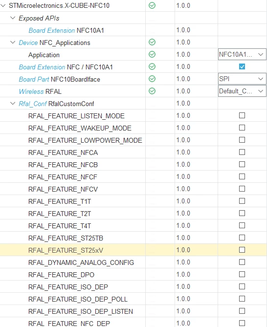

Brian TIDAL
March 19, 2025
make sure to follow the various steps described in STMicroelectronics.X-CUBE-NFC10_GettingStarted.pdf (available in <yourHomeDir>\STM32Cube\Repository\Packs\STMicroelectronics\X-CUBE-NFC10\1.0.0\Documentation)
In particular:
and
Rgds
BT

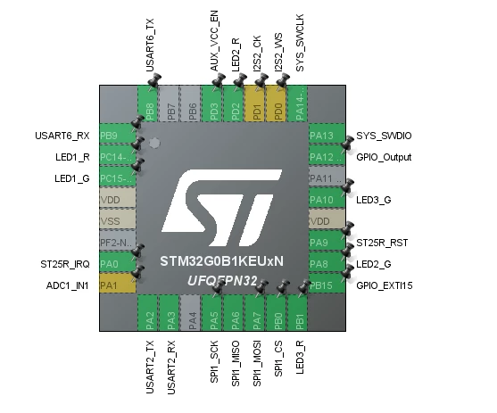

March 19, 2025
Hi
Thanks BT for your reply,
so i created a new project .
i took the .ioc file from steval -25R200SA evaluation board FW.
i created the project from the nfc10 :
i defined all missing HW (button EXTI and LED)
generate the project:
download the project to the stm32 .

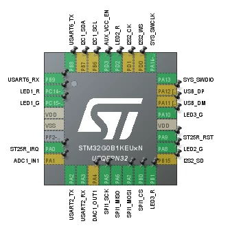

with debugging , i can see ,the stm32 cant identify the chip id of the st25r200.
on this function :
bool st25r200CheckChipID( uint8_t *rev )
uint8_t ID;
ID = 0;
st25r200ReadRegister( ST25R200_REG_IC_ID, &ID );
/* Check if IC Identity Register contains ST25R200's IC type code */
if( (ID & ST25R200_REG_IC_ID_ic_type_mask) != ST25R200_REG_IC_ID_ic_type_st25r200 )
return false;
if(rev != NULL)
*rev = (ID & ST25R200_REG_IC_ID_ic_rev_mask);
return true;
after st25r200ReadRegister( ST25R200_REG_IC_ID, &ID ); function the ID remain 0.
so i cant read the st25r200 id. why is that ?
after that ,the software got stuck  on  error handler on while(1)
void Error_Handler(void)
__disable_irq();
while (1)
what the reason for that , the main issue is to understand why the st25r200 chip not recognize the id number.
again, this hardware is working fine, when use the STEVAL-25R200-STM32G0B1 FW.
best regards ,
noam.
Brian TIDAL
March 19, 2025
check your SPI configuration and make sure the Reset pin of the ST25R200 is low. The st25r200CheckChipID fails due to no reply on the SPI (i.e. no reply ==> 0x00 is read on the MISO), so either the Reset pin is floating or the SPI configuration is incorrect.
BT
