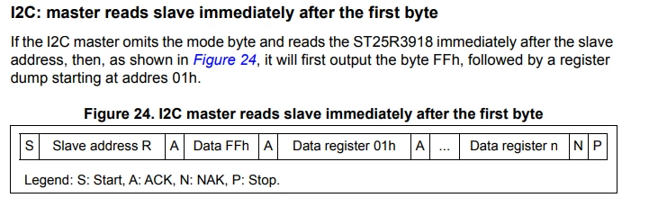

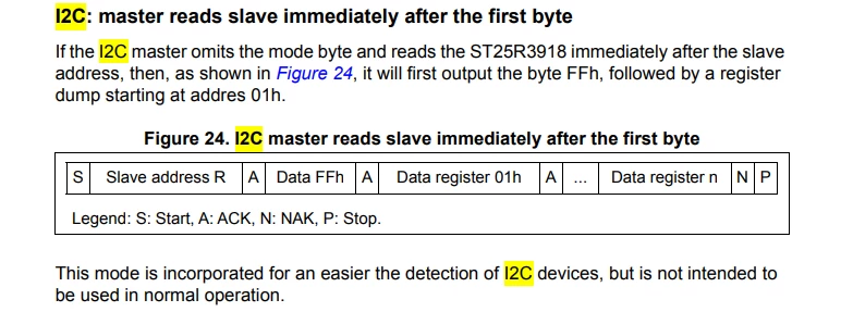

it seems that even though I set mode byte what I read is for situation described here:
so it seems mode byte is ommitted even though I set it

    I can read chip ID reg(0x3F) and any reg for ST25R3918 but only in this mode(when doing a dump of registers):
even though I send byte mode according to the datasheet and the Wire.endTransmission() afterwards returns 0(transfer completed)
