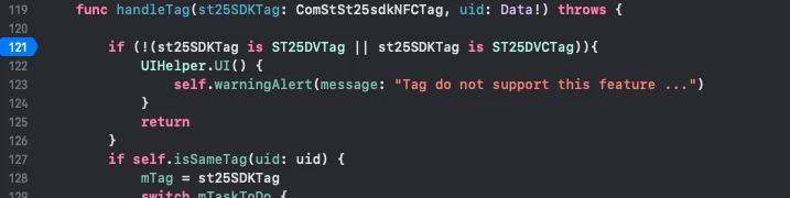

In specific, I get problem with following code in from "ST25DVMailboxManagementViewController"
The following condition fails in my code, but succeeds in iOS NFCTap App.
if (!(st25SDKTag is ST25DVTag || st25SDKTag is ST25DVCTag)){}
Did anyone face something similar?

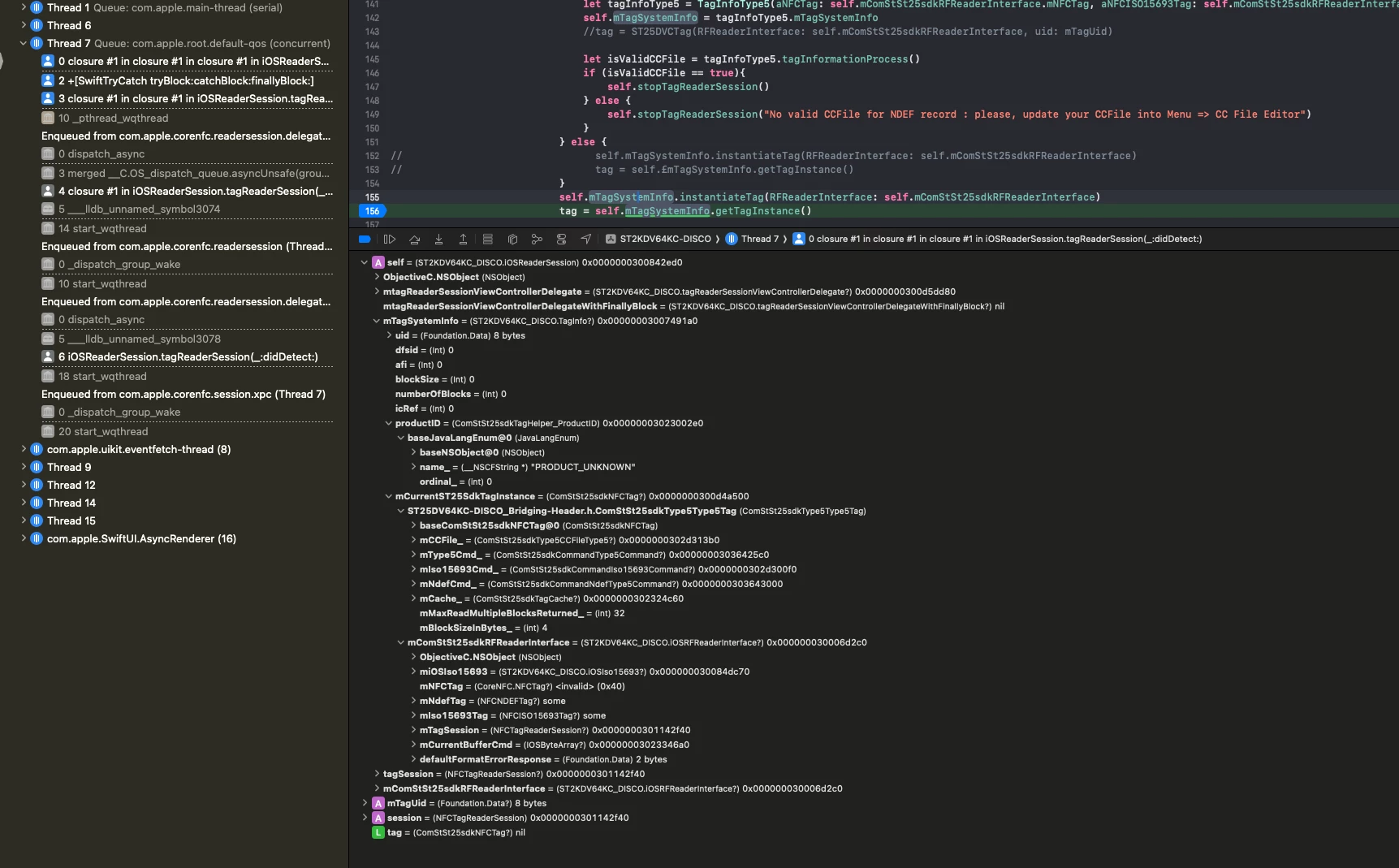

Here I have also attached my debug window. (My goal is to only be able to activate mailbox.)

victor laraison
November 8, 2024
thx for info.
It would seem your type5tag is not instanciated correctly.
Have you called the function "instantiateTag" (from Model/TagInfoHelper.swift) somewhere into your code ?
if not, please have a look into iOSReaderSession.swift file where we call the instantiate method for getting the ST25Tag product (in red color) :
self.mComStSt25sdkRFReaderInterface = iOSRFReaderInterface(aNFCTag: mNFCTag,aSession: session)

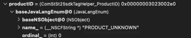

victor laraison
victor laraisonBest answer
November 8, 2024
pb is that the mTagSystemInfo.ProductId is not defined, and set to default value. So , you get generic type5 as tag.
I suggest you to have a look into "TagInfoHelper.swift" and "readTagInfo.swift" to know how to call the "setProductId" function with correct parameter.
func setProductID (productID: ComStSt25sdkTagHelper_ProductID) {
self.productID = productID
In first, you have to getSystemInfo that give you tag information :
let response:Data = (miOSIso15693Tag?.getSystemInfo())!
if (response[0] == 0x00){
let dfsid:Int = Int(response[10])
let afi:Int = Int(response[11])
let numberOfBlocks:Int = Int(response[12])+1
let blockSize:Int = Int(response[13])
let icRef:Int = Int(response[14])
self.mTagSystemInfo = TagInfo(uid : mUID!, dfsid: dfsid, afi: afi, blockSize: blockSize, numberOfBlocks: numberOfBlocks, icRef: icRef)
then, call the TagInfoHelper.decodeProductID function for getting ProductId
 pdt = decodeProductID(uid: self.mTagSystemInfo.uid, tag: mNFCTag!, icRef: self.mTagSystemInfo.icRef, self.mTagSystemInfo.numberOfBlocks)
self.mTagSystemInfo.setProductID(productID: pdt)
And finally, whenever you will instance tag, you will get right tag info.
Hope it helps.

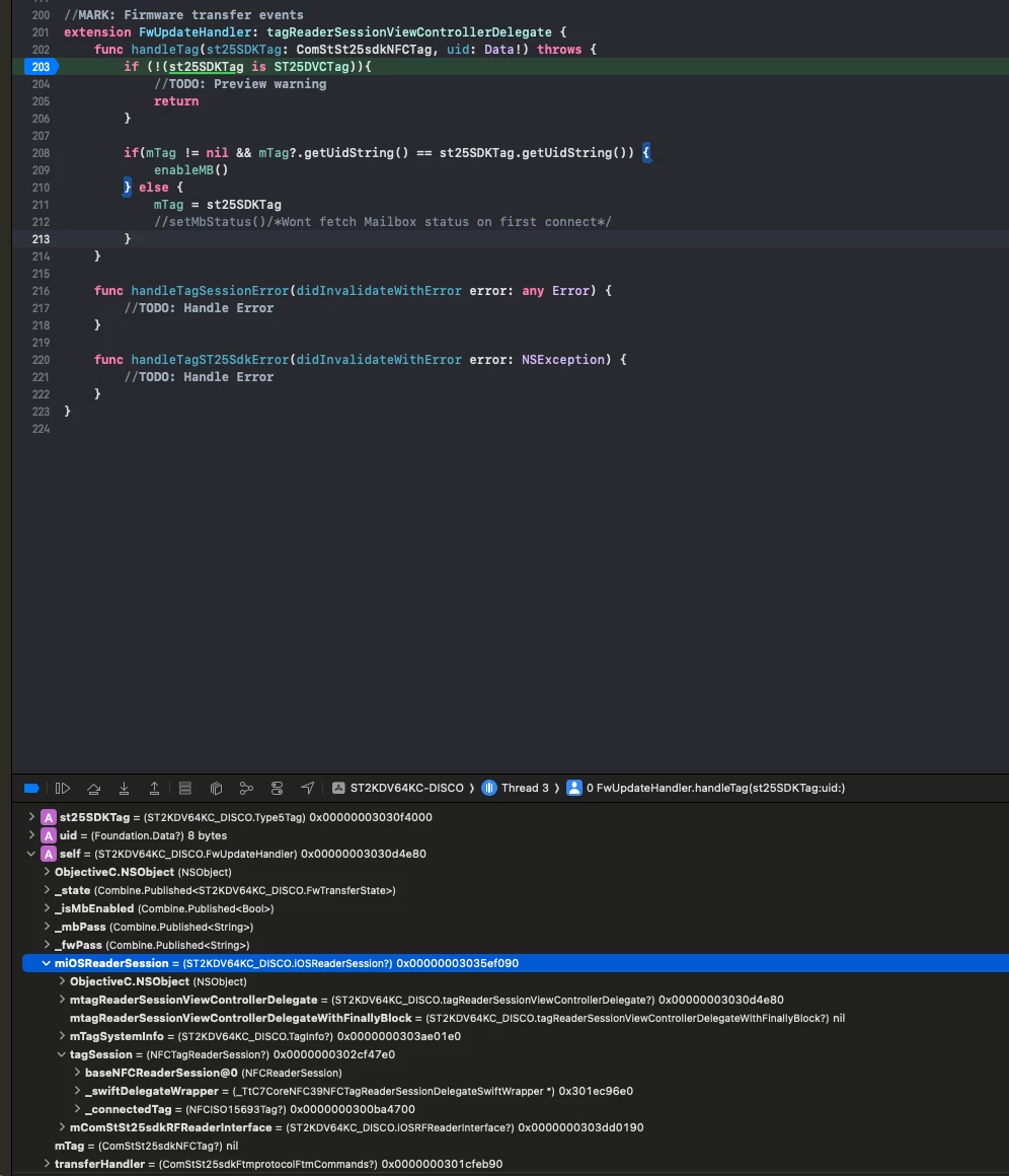

AlyAuthor
November 9, 2024
Hey Victor,
This was a very helpful thing to point out as my iOSReaderSession was never setting the product ID.
Upon further inspection, I noticed that the functionality already existed inside TagInfoHelper and TagInfoType5.
Therefore, upon detecting a tag, I now call following so that the product ID is set.
let isValidCCFile = tagInfoType5.tagInformationProcess()
 if (isValidCCFile == true){
 self.stopTagReaderSession()
 } else {
 self.stopTagReaderSession("No valid CCFile for NDEF record : please, update your CCFile into Menu => CC File Editor")
But sadly, even after doing that, the results are same, and the tag type cast always fails.
What else could be missing?
p.s: I have also attached code segment for clarification.
My Tag handler:
iOSReaderSession

AlyAuthor
November 12, 2024
Hey Vincent,
Sure, I have attached the debug log here,
Please let me know what you find:
Thanks in advance.

victor laraison
November 12, 2024
Hi again Aly,
I see that your ProductId is still set to ProdutUnknown.
Please, check that functions for tag identification are called correctly into your code. ref to previous post above.
