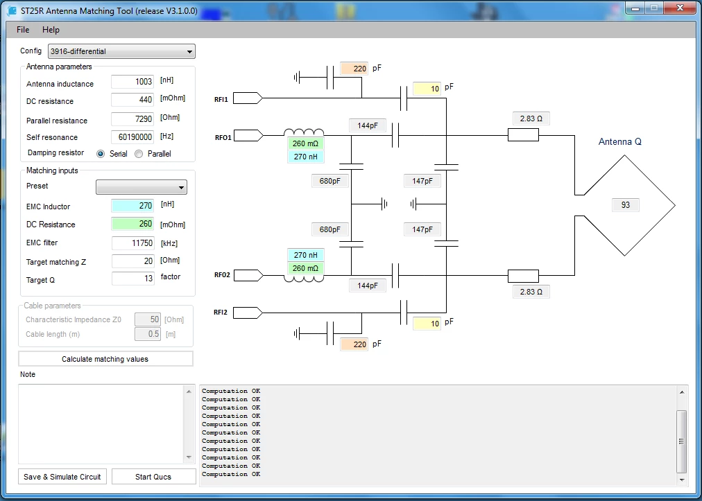

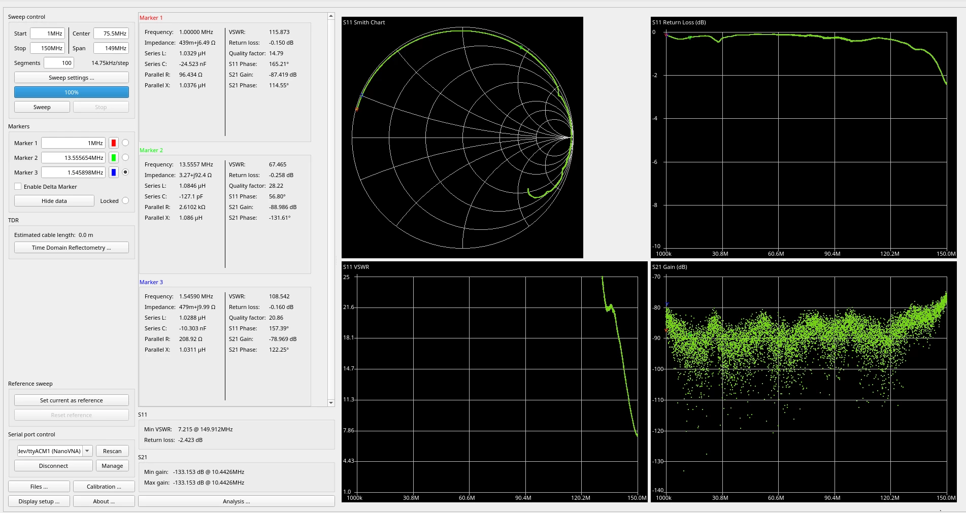

The antenna design is very similar to the ST25R3916 Discovery Board (2 turns, 65mm x 85 mm). For the the antenna analysis I have measured its real parameters following the indications of the AN5276 Application Note:
This is LANT = 1.03 uH RSDC = 440m Ohms fres = 60.19 MHz Rp @ fres = 7.29 Kohms
Buy using the ST25R Antenna Matching Tool I get the following values for the custom board:
On the Firmware side the Initialization is successful (ERR_NONE)... but does not detect any tag during execution of the detection cycle routines.

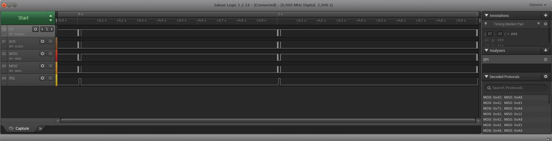

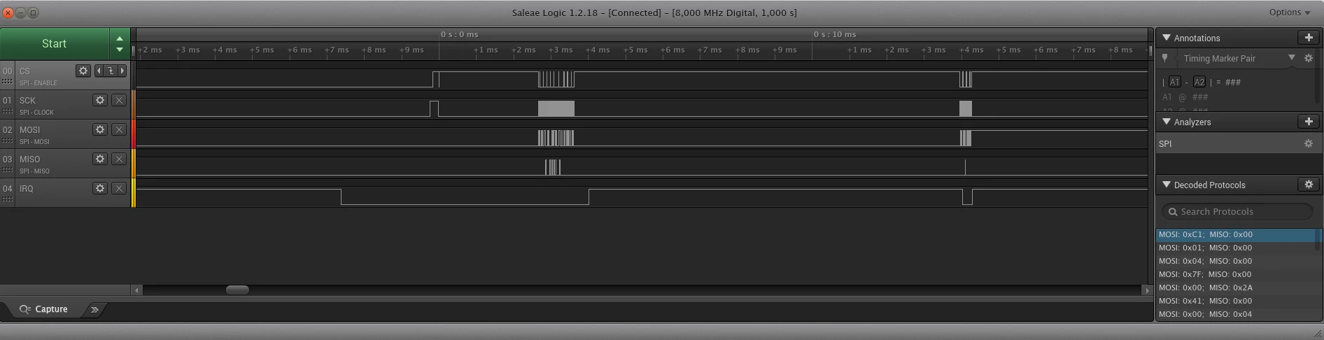

Gaston
GastonAuthor
Dec 17, 2020 12:51 PM UTC
Hi Travis,
Here's the SPI traces:
During Initialization
Work Cycle
0693W000006G7rmQAC.pngDecoded SPI files (during init & cycle loop) are attached in zip format.
regards,
gaston
