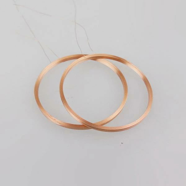

    Henry Crane
    September 1, 2020
    sorry to answer to you with a question but I am not your to understand your need. do you plan to design a multilayer circular antenna similar to a solenoid, or a planar (spiral) coil?
    Best Regards,
    HC
    vaibh_p
    vaibh_pAuthor
    September 2, 2020
    Hello Henry ,
    We want to design antenna as shown in figure.
    So we need reference for calculating the inductance of such antennas.
    I guess this is one called as "Multilayer Circular Antenna" ?0693W000003QXxAQAW.jpg
