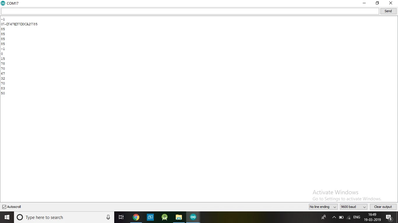

We've connected CR95HF with arduino uno via UART but it seems to give random outputs on the serial monitor.

The Serial Monitor:

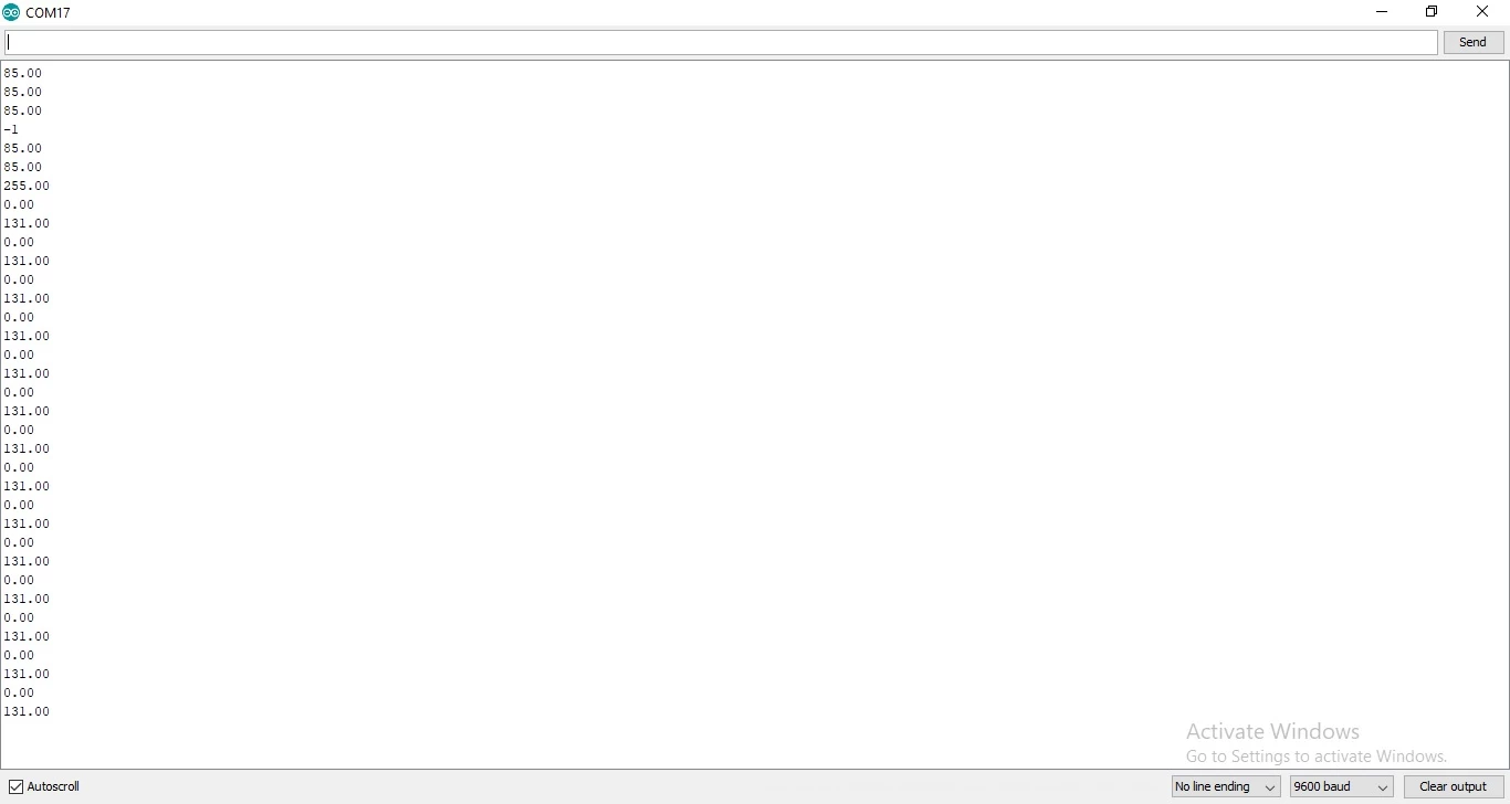

    PGupt.17
    PGupt.17Author
    April 2, 2019
    @Brian TIDAL_O​  I don't think so it solved much.

    I am not sure to understand why you are using float to read the CR95HF UART output.
    From what I can see in your serial monitor trace:
    • you send echo command (0x55) and you get 85 answer (i.e. 0x55 ==> echo answer) from the CR95HF
    • you repeat this 2 times then line 32 there is a strange  serial.println(BTserial.read(). I guess this is a mistake.
    • then repeat this 2 times the sending of echo command and receive the proper echo answer (85 = 0x55)
    • having the proper echo answer proves that the UART interface is operational
    • then you sent 02020201h to select protocol ISO14443 but the last parameter (01h) is invalid (bits 3:0 are RFU)  so this command is failing
    • then you try to send a REQA using SendRecv command  which return 131 (0x83 = Invalid protocol) as the ProtocolSelect has failed.
    So from what I see, the UART is working properly. You have to fix the ProtocolSelect command (e.g 02020200h) and fix the reception of command response:

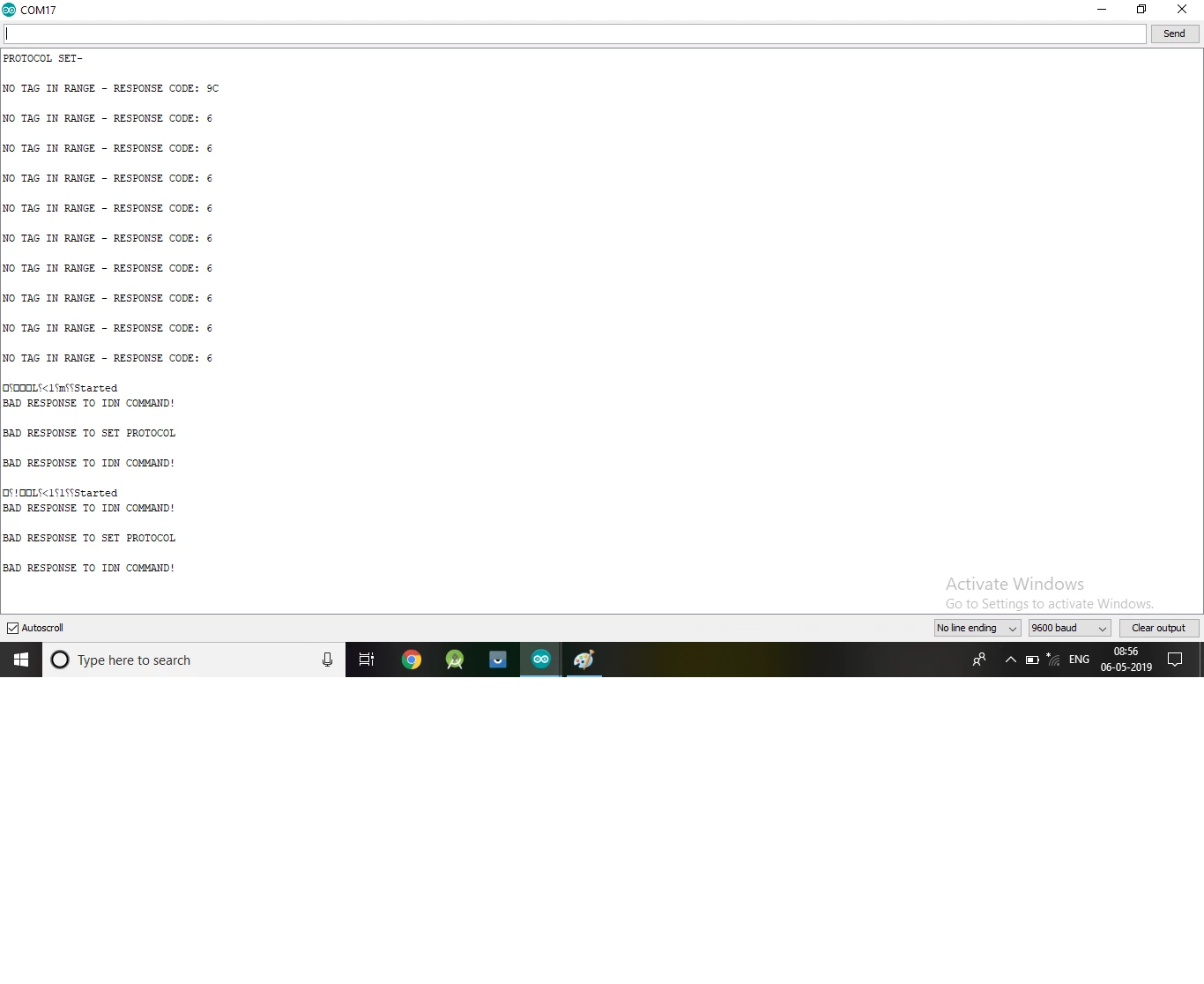

    I'm using a BM019 board now for evaluation purpose. The board is connected via SPI with a ESP8266 mod - Nodemcu board. The Inventory command runs for a few cycles and then anomalies stars to follow. We're coding using Arduino IDE. Here's my code:

    Here's the Serial Monitor:

    Did all the changes you suggested, still the problem exists. This code was written for an Arduino UNO and it works absolutely well with it as we have tested it with an UNO as well. But with Nodemcu this problem follows. Kindly help me out with the full code to solve this problem as we've already bought 50 CR9fHF chips and we have to make it work with a Nodemcu.

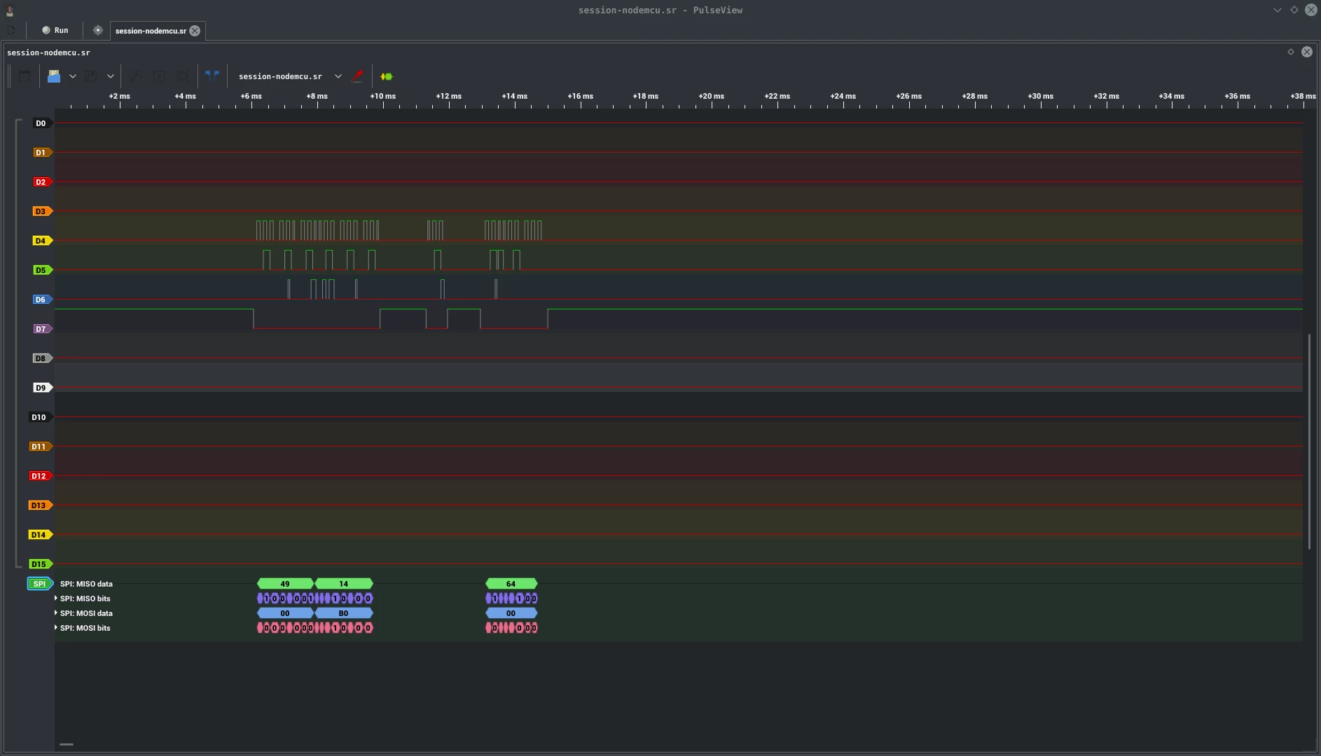

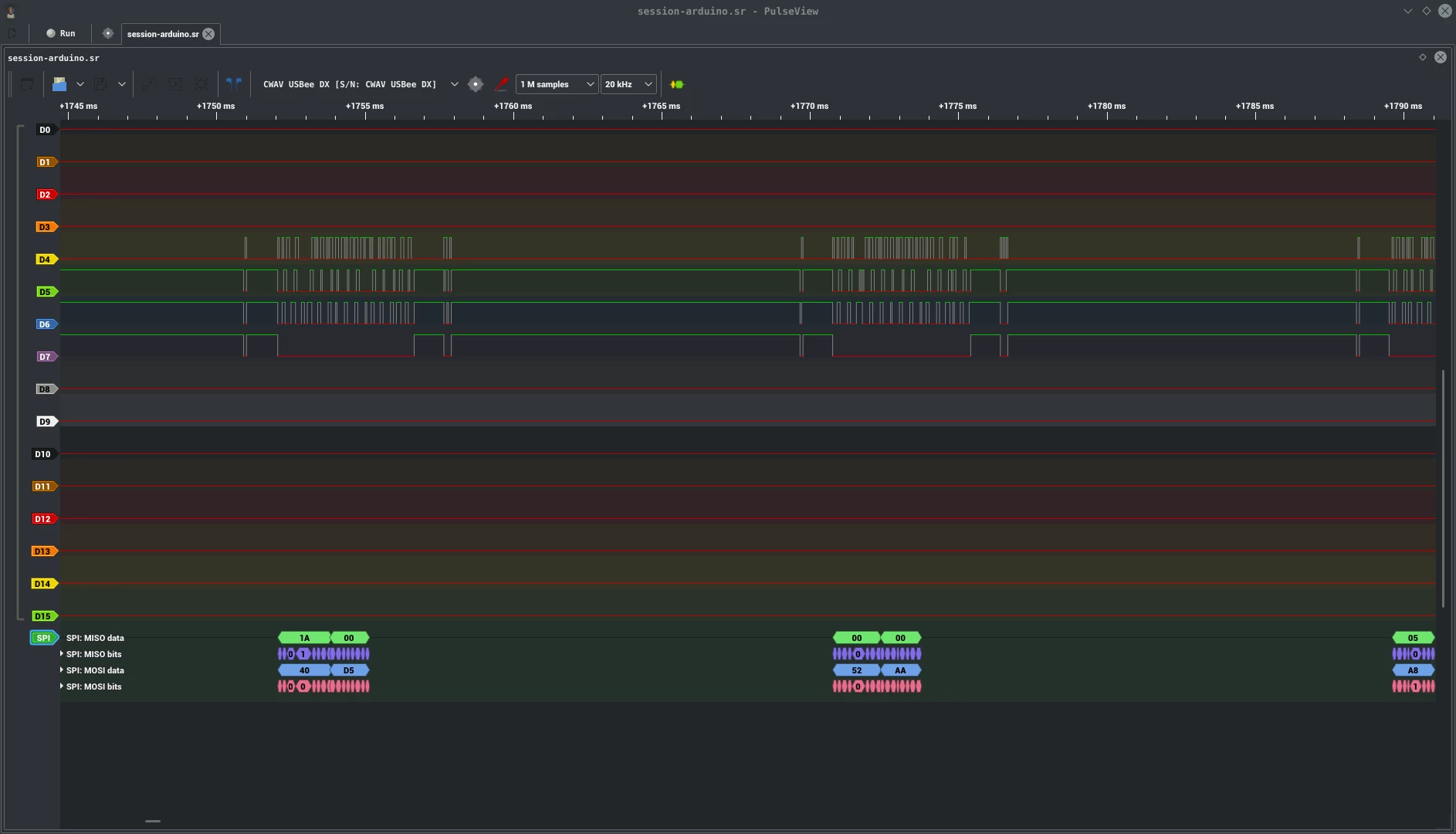

    IFroi
    July 9, 2019
    I dont know if this thread is still active but currently I'm working in a project with the same sensor (BM019). The official code for Arduino works great on Arduino Uno, but unfortunately not on a ESP8266 and I think is something related with the SPI. The clock speed is in Arduino 16Mhz and as I set the following:
    SPI.setClockDivider(SPI_CLOCK_DIV32)
    The speed for the bus would be 500Khz. In the esp8266 I think the speed is 80Mhz, but I set the speed manually with this:
     SPI.beginTransaction(SPISettings(15000, MSBFIRST, SPI_MODE0)); //15khz
    I think that this sensor dont handle high speeds I dont find the threshold on the datasheet, despite that apperently change clock speeds in esp8266 doesnt seems to affect the behavior. I made a couple of tests with a logic analyzer and got a weird behavior for the ESP.
    And this is the correct behavior for the Arduino
    Apart from the clock speed, looks like works completly different on the ESP, my first thought was that the data overlap because of the default high speed of the ESP but seems that do the same at any speed.
    Thanks in advice

    ​Hi,
    I would suggest to create a new thread as this one was initially related to an UART communication issue. Please make sure to describe your HW setup (i.e. ESP8266 MCU connected to BM019 module over SPI), the serial communication setup and your SW setup.
    Regarding your question about the SPI clock frequency, the max value is defined in the CR95HF Datasheet: 2.0 MHz. Make sure to check the various SPI parameters as defined in §6.4 SPI characteristics of the Datasheet.
    I had a look to the screen shots: I believe the logic analyzer is not properly configured as the MOSI and MISO values do not make any sense. Make sure to trace SCK, MISO, MISO, SPI_SS, IRQ_IN, IRQ_OUT and to provide the logic analyzer channel configuration (i.e. what is D4, what is D5, etc.). If possible, attach the logic analyzer log file rather than screen shots. Which logic analyzer do you use?
    The typical startup sequence is to send a echo command, receive the echo answer and then send an IDN command:
    MOSI 00 55 02 XX 00 01 00 02 XX XX XX XX XX XX XX XX XX XX XX XX ...
    MISO XX XX XX 55 XX XX XX XX 00 0F 4E 46 43 20 46 53 32 4A 41 53 ...
    IRQ_OUT -------------______------------------------------_________________________________________ ...
     ECHO IDN
     ECHO RSP IDN RSP
    Rgds
