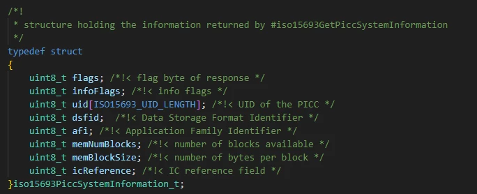

I was just playing around iso15693GetSystemInformation() function: and got this, comparing this output with F/W code, data mapping makes sense but the outcome of data does not make sense to me, any idea?
Received from Tag type-V: [HEX: 00 0B 92 D6 1C 62 03 48 02 E0 00 00 48 E4 43]
F/W Code Sys Info Structure:
Based on converting these values from signed bytes to HEX, I can see bytes[2:10] are UID, which makes byte-0 & 1 flag & infoflags respectively. Leaving last remaining 5 bytes as dsfid, afi, memblocks, memblockSize, icRef.
Where, Mem Blocks is 72, which does not look right, I would expect 512 blocks of size 4 bytes as per datasheet. This is off putting my understanding, I feel like a ***.
BR, JJ

Reading the data sheet of ST25TV16K (6.4.22) the Get System Info is as expected: the info flag 0x0b means no block information provided, E4 43 I presume to be CRC16.

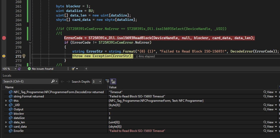

For the iso15693ReadBlock(): block_nr refers to the Block Number parameter of "6.4.6 Read Single Block". I don't see in your explanation the actual data fed in nor the return (status) code and data after execution. UID I think you could also leave at NULL - the function should then execute the Read Single Block without UID in broadcast mode.

Coming back to ReadSingleBlock(), I tried supplying null for UID, but the function return back with Timeout error.

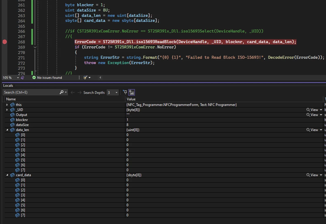

With UID supplied, function succeeds with NoError code but no data received.

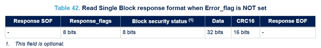

this is a C style interface. With data_len/sizeof_data you need to communicate the size of the buffer you provide to the DLL and after the function returns the data_len will be adapted to the actual returned size. You will need to feed in a pointer to a uint32_t with value of 8.
I suspect in your case the firmware was provided with a zero length buffer which it was not filling.

I got what you mean, I was supplying wrong data_len/sizeof_data, as I had an array declared but all with 0 data by default, as soon as I corrected that I  am seeing data now. In my case as I have flashed whole tag memory with 0xFF pattern I see -1 as data which is 0xFF in HEX.
I tried WriteSingleBlock as well, and it is working now as expected. I am able to read/write single block at a time.

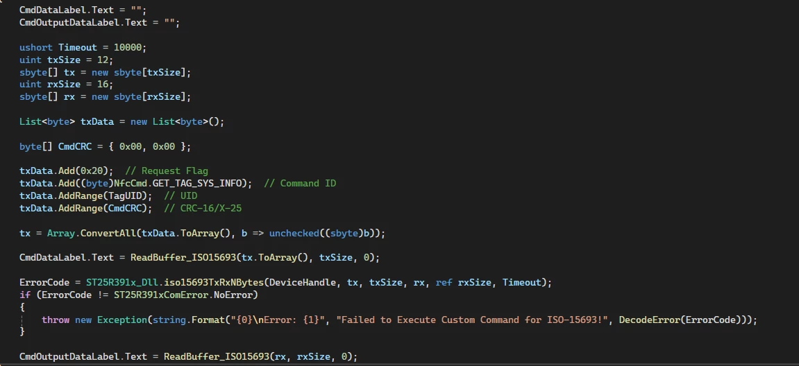

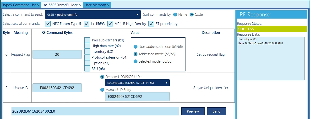

Thank you for your help so far, as per your suggestion I have been trying to build custom commands, in order to do that I am using ST25PC-NFC tool's Frame Builder, as I am only interested for ISO15693 for me it is Iso15693FrameBuilder tab. Again to start simply, to understand how to use iso15693TxRxNBytes() I am just trying to send Get-System-Info of the tag. So I built a frame using the tool and tried the same via tool to make sure I'm not sending any nonsense command, it works fine.
I am sending the same frame via my program, but it is ending up in an ERROR 01, with Error code 02 Command not recognised (format error). Remaining two bytes are CRC16 (X-25).
As I was not getting expected results I started retrospection of what could be wrong, every single time I was ending up doubting on Request_Flag byte, which is common input for any command, I started playing around it, tried to generate possible values via ST215PC-NFC tool, tried to execute it on tool, and then use the same Request Flag value to see if works on my program, but no success so far.
My code to send Get-Sys-Info command:
For, CRC-16, in snippet it shows as ZERO, as I have left it like that, in other case I have calculated CRC16/X-25 and provided as part of command, in both case it has failed with the same Error Code. I have also maximised the timeout.
Could you please guide me, what am I missing here?

With the API that you are using you should not use the CRC, it will be automatically generated inside firmware and appended. In your case you would end up with two extra data bytes followed by the real CRC.
AFAIK anyhow the firmware will adapt the Request Flag to fit the physical comm params - One subcarrier + high data rate, so your pre-calculated CRC would even be incorrect.
Only with the Physiscal variant (iso15693PhyTxRxNBytes) you need to supply a pre-calculated CRC.
BR, Ulysses

Just Brilliant @Ulysses HERNIOSUS
I have tried multiple custom commands based on your suggestion and it is working very well! I can not thank you enough for your help & guidance on this. Without it it'd be not possible to get to this stage for me.
