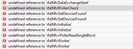

I followed your instructions to port one of the basic examples to the F446RE.
It works up to the point, that some "undefined reference to" errors occur.
I already checked the forum to solve the problem, but without success.
It seems to be a linker problem...but to which library path i have to link?

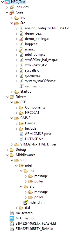

The project structure is
Do you have any further information which helps to get the system running?

the mentioned functions are defined in rfal_nfc.c. Should be under the last directory of the shown "Middlewares".
BR, Ulysses

Hi Sebastian,
there is no specific linker option or lib/libpathc/etc.. Make sure rfal_nfc.c is compiled and that rfal_nfc.o is in the list of objects being linked by the linker.
Rgds
