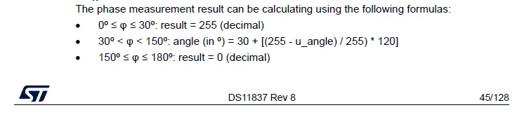

I hooked up an oscilloscope to my tx and rx lines, at the antenna end, and measured the phase difference between the two lines at startup. I did this because the hardware engineer working with me on this project tuned the antenna to work at 13.56 Mhz. The measured value was ~16 deg and frequency ~13.590Mhz. I want to set this phase as my target. I'm now curious to know, how do you map the degrees to the register value. To set the 90 degree phase, the register is set to 0b1000000. This is confusing and not sure how to map the 16 deg phase to bits. The datasheet also only points to the command table, but doesn't explain the bits.
I will also implement your recommendation regarding AAT and LPCD.
Thanks,
Adan
Ulysses HERNIOSUS
October 21, 2022
I would rather look at what the chip internal phase and amp measurement are revealing. I think 16 deg would be outside of the range of the chip internal measurements.
Please refer to the section in the DS about "Measure Phase":
Best Regards, Ulysses

I went through all 16 trim values as you recommended and it appears that no combination of tre bits gets the phase to exactly 90 deg. As mentioned before, the default 90 deg target was used.
I have attached an excel document showing the results I obtained. I used two different boards and wrote down my results.
After looking at the results, is it safe to assume that the reason why tri_err bit is being set is because during the calibration sequence, the chip was not able to get the 90 deg target?
Also, to me, it appears that there are two paths forward in my situation:
  1. The hardware engineer changes the cap values to allow the system to achieve the 90 target (hardware fix), or ..
  2. In software I change the target phase to be, say 80, as an example.
Would you agree? Oh and also fix the amplitude issue you mentioned in your previous post.
Thanks,
Adan
Ulysses HERNIOSUS
October 25, 2022
Hi Adan,
correct, chip could not get close enough to 90deg. Your approach sounds good.
BR, Ulysses
APant.2
APant.2Author
October 25, 2022
Ulysses,
I assume the equation, deg = 30 + [ ( (255 - x) / 255 ) * 120 ], is used to determine what value to write to the target register? Where if you want a 70 deg phase shift, you solve for x. The value you get for x is then written to the register.
Thanks,
Adan
Ulysses HERNIOSUS
November 2, 2022
correct.
