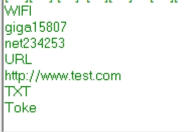

Hi
I am trying to create an application using arduino which will read 4 NDEF text messages where will be stored data needed to establish Wi-Fi connection (host, ssid, password, token).
I did try to run example from stduion ST25 library and thats work fine but only for URL NDEF.
Do you have any working example to show how to read (not need to write) 4 different text NDEF and use those data as I described above?
I would be very gratefull for any help.
thank you!

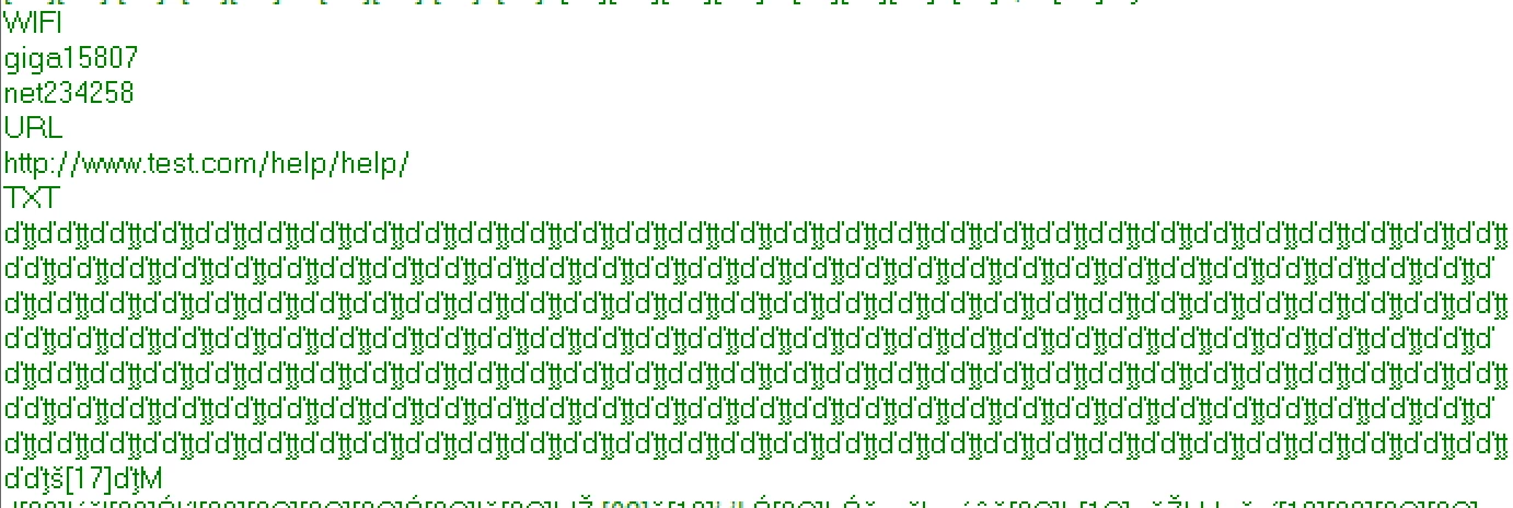

RMako.2
RMako.2Author
May 25, 2022
hello
Unfortunately doesn't help.
I tried to play with NDEF_TEXT_MAX_LENGTH for text, URI_Message for URI, NetworkSSID, NetworkKey for WiFi, NDEF_RECORD_MAX_SIZE sizes
I cannot read more than 42 charakters, if any of messages is longer it is finish by error.
Rene Lenerve
Rene LenerveBest answer
June 8, 2022
Hi @Community member​,
If by updating this value, this allow you to obtain only 2 bytes more, it means for me that you have not enough memory available in your system. You can have some information with the compiler to know more about memory space used by your code.
Another thing to check, that could result in a limitation of bytes to read, is if your i2c read function is limited by a timeout. A read of 42 bytes can spent around 1ms for a speed set to 400kbit/s on I2C.
Hope this can help you.
