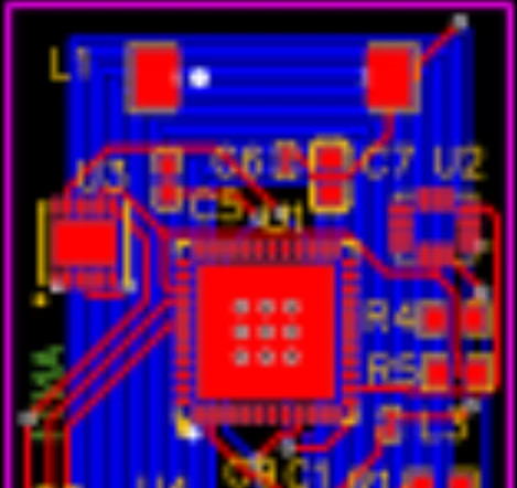

can you please suggest on what type of antennas do you suggest to be used along with ST25DV16K ? I was hoping to use NFC_ANTENNA_25X15 between the pins AC0 & AC1.
Also can you please suggest if it will be a good idea to have the antenna on bottom layer and all the other electronic components on the top layer in the two layer board ? Or will it be better to increase the PCB size laterally and have the antenna on the same top layer as the electronic components ?
I also plan to use a 2.4Ghz wireless communication chip antenna so what precautions should be taken to avoid interaction between the chip antenna and NFC antenna ?

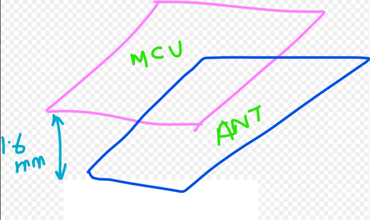

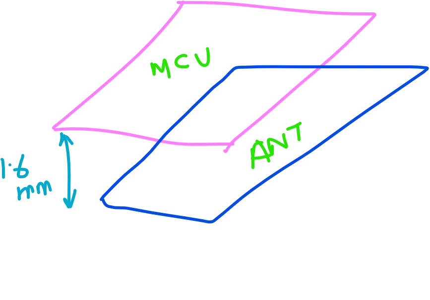

thanks for the reply, in my case the antenna spiral is on the bottom layer and all the components on the top layer with standard two layer pcb dielectric thickness between the two layers. Attached is the image for your kind reference.
sidmohanAuthor
August 11, 2023
Does the above configuration of single layer PCB look fine to you ? or do you have any suggestions on the same?
Henry Crane
August 22, 2023
this kind of design is OK for NFC communications however digital components are exposed to 13.56MHz.
Try to minimize the surface of signal loop for components that may be sensitive to 13.56MHz. Unless component placement is a constraint (for instance connectors that have to be on the border of the PCB), try to compact the layout in order to reduce the length for tracks and then reduce signal loops.
I can see that there is some free space between the PCB boarder and the antenna: you may consider to enlarge the antenna dimension to the border of the PCB and reduce the spiral track width and spacing in order to enlarge the inner area.
A real life validation of your PCB prototype will be necessary to verify the impact on your application of magnetic field generated by the NFC/RFID reader you selected. More than a functional validation, you'll have to measure the noise generated by the magnetic field in the system to assess its robustness.
