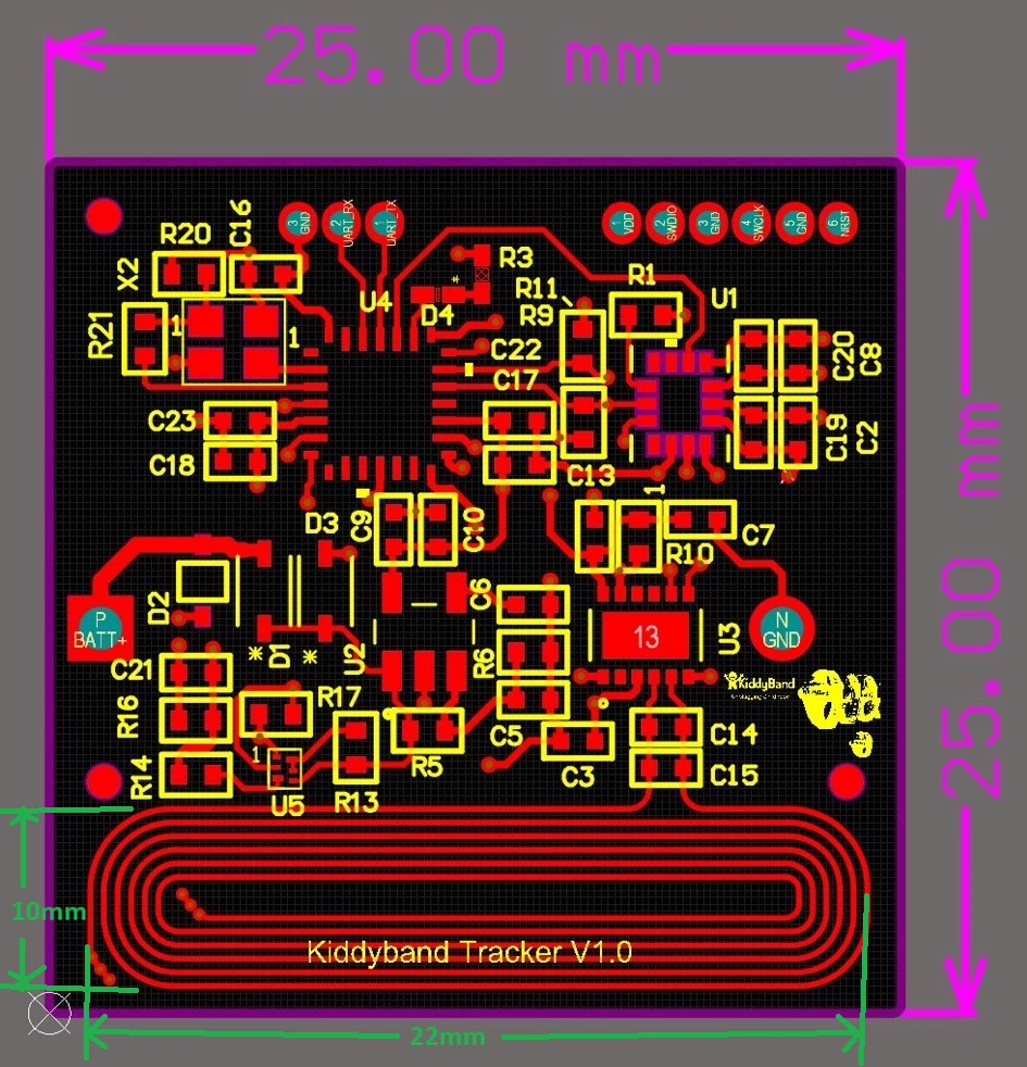

I have designed a board with a total antenna width of 10 mm and 7 turns, and a rectangular antenna.
But it doesn’t read by smartphone (NFC-enabled) or Readers.
Can you please help me with the problems?

Can you please give more information about the antenna characteristics? The important factor is the inductance of the antenna. For a ST25DV, it should be about 4.8uH.
You can also measure the tuning of the antenna+ST25DV tag. The tuning measurement is explained in this application note (chapter 4): How to design an antenna for dynamic NFC tags - Application note
It is also important that there is no ground plan under the antenna (it is not possible to check that on the layout shown here).
Best regards.
