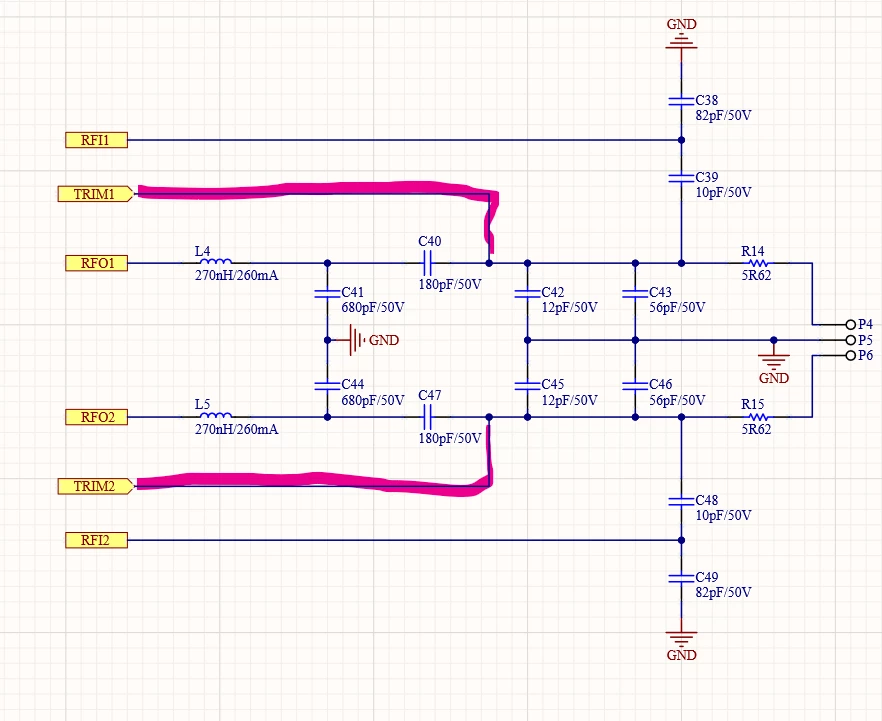

Can you suggest me or provide some document with electrical scheme of ST25R3915.
I need to develop standalone PCB.
Best regards,
Domen
Ulysses HERNIOSUS
October 6, 2021
Hi Domen,
ST25R3911B and ST25R3915 are pin-to-pin and software compatible (except for AAT). So you can just look at all the available information for ST25R3911B.
Basic electrical schemes can be found in 1.2 Application information of the datasheet.
Best Regards, Ulysses
DIvan.1
DIvan.1Author
October 6, 2021
Perfect. The TRIM1 and TRIM2 (red mark in the picture below) line should just delete in antenna matching scheme or not?
