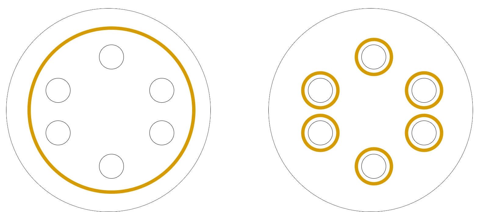

I'm working on a product that involves multiple sensors connected to a main system. Up to six sensors can be attached (see image). The overall diameter of the system (as shown in the image) is approximately 20cm. I want to use NFC tags on each sensor to identify the type of sensor (including ID and other details) when plugged into the system.
The sensors are eventually connected to another system via cables. The sensors only output current (and are supplied with voltage) – so, two wires ( + - ). The identification of the sensors (reading the NFC tags) will then be transmitted from my system to the main system.
I've come up with two antenna concepts (see image) for this purpose:
  • A single large antenna for all sensors
  • Individual antennas for each sensor
Which approach would work better? Does anyone have experience with this? I'm particularly interested in how the NFC performance would differ between these two antenna configurations.
In the version with multiple antennas, I was thinking of using a multiplexer so that only one NFC reader is needed. For this, I’ve considered using either a PIN diode circuit (do these work well for NFC systems?) or an RF switch IC. Have any of you used these or can recommend one over the other (or maybe a different technique)?

In your six antennas configuration the antennas will most likely also read neighboring tags. Especially for those at 2,4,8 and 10 o'clock positions.
BR, Ulysses
