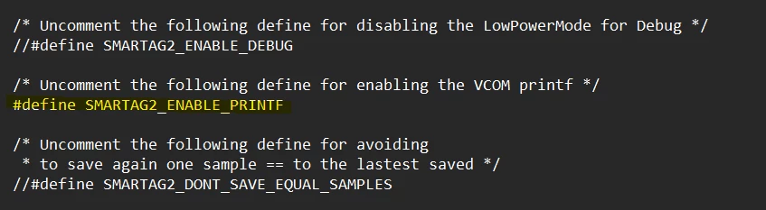

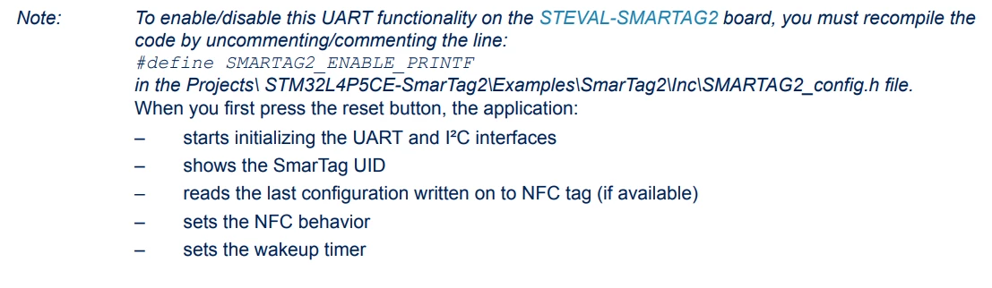

Edit: I tried the steps (see below) in the manual to enable the UART by removing the "//", but I get no info/data in the Tera Term application after I press reset on the Smarttag2. What am I doing wrong?

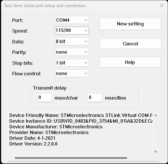

See the Quick Start Guide to enable/disable the UART logging functionality. Make sure that the sources are recompiled after uncommenting SMARTAG2_ENABLE_PRINTF define (i.e. make sure Firmware_conf.h has been saved to the disk before compiling). Check the USB cable and the serial port setting (115200,8,N,1).

Thanks for your reply and the link to the guide! I was able to perform Step 1 and flash the pre-compiled binary and thereafter able to add the Smartag2 via NFC in the ST Asset App. But in Step 2 I did not have any further success as I still have issue with showing any text in Tera Term when pressing Reset on the Smartag2. The port setting is correct, I have uncommented the SMARTAG2_ENABLE_PRINTF define text and saved. Does the FP-SNS-SMARTAG2 folder have to be in a specific place?

I apologize by advance if my question is naive: have you recompiled the firmware and then downloaded it to the board after uncommenting SMARTAG2_ENABLE_PRINTF? Have you followed the instruction from "How Install the code after compiling the project" (slide 12 of the Quick Start Guide)
