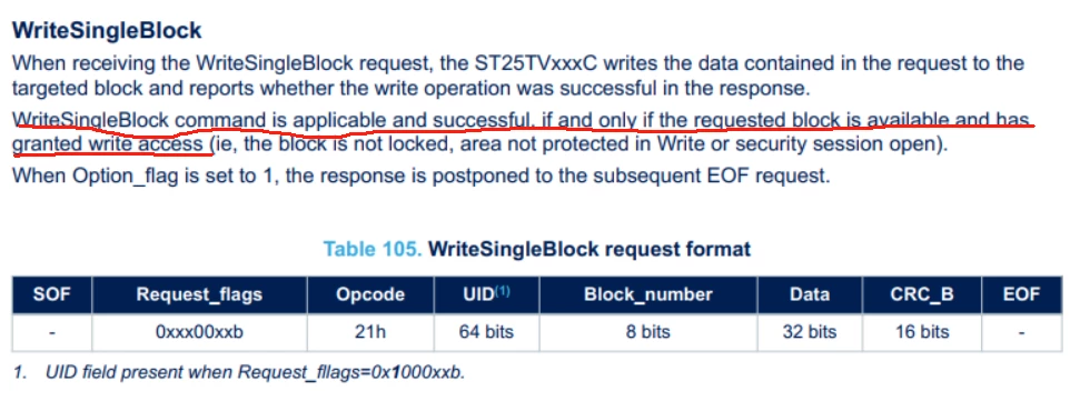

My goal is to set a password for the user memory area on the card.
During the process of writing the encryption code for the card, I read the manual for the ST25TV02KC.

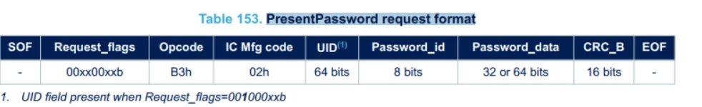

Rance_0-1728921724082.pngBased on the underlined sentence in the image, I first send the data related to the PresentPassword request format.
The corresponding configuration bits in the code are as follows
 arr[0] = 0x20;
						arr[1] = 0xb3;
						arr[2] = 0x02;
						arr[3] = uid[7];
						arr[4] = uid[6];
						arr[5] = uid[5];
						arr[6] = uid[4];
						arr[7] = uid[3];
						arr[8] = uid[2];
						arr[9] = uid[1];
						arr[10] = uid[0];
						arr[11] = 0x01;
						arr[12] = 0x11;
						arr[13] = 0x22;
						arr[14] = 0x33;
						arr[15] = 0x44;
						arr[16] = 0x55;
						arr[17] = 0x66;
						arr[18] = 0x77;
						arr[19] = 0x88;
						arr[20] = (PY_CRC_16_S_X25(arr,20)%256);
						arr[21] = (PY_CRC_16_S_X25(arr,20)/256);
 The send should have been successful, but the return value of the FIFO seems abnormal.
Could it be because the order of my operations was incorrect ?

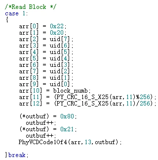

Before this, I completed the read and write operations on the blocks according to the relevant instructions in the datasheet , and now I will demonstrate that
Related instruction:
Code section:
Print result(display normally):

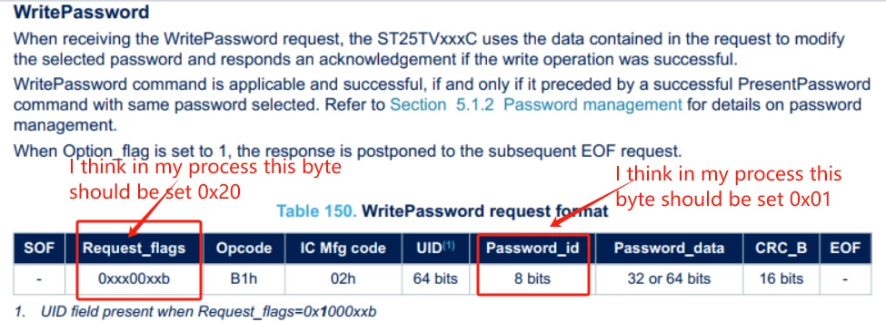

So, in order to encrypt the block, what exactly should I do? What configurations do I need to set up first?

I think that the first byte of your command is wrong.
The first byte of the command is the Request Flag byte. It sets up the data rate and the modulation requested for the answer, plus other parameters.
In your read and write commands, the request flag is set to 0x22.
In your Present password command, the request flag is set to 0x20.
The difference is that in the bit 1 of the request flag. This bit sets the data rate of the answer. In your read and write commands, it is set to High Data rate. In your Present password command, it is set to Low data rate.
Some readers do not support the Low Data rate. So please, try the Present password command with the request flag set to 0x22.
Best regards.
Brian TIDAL
October 15, 2024
In addition to this reply, I suggest to use the RFAL library that provides support for ST25TV commands such as PresentPasword.
